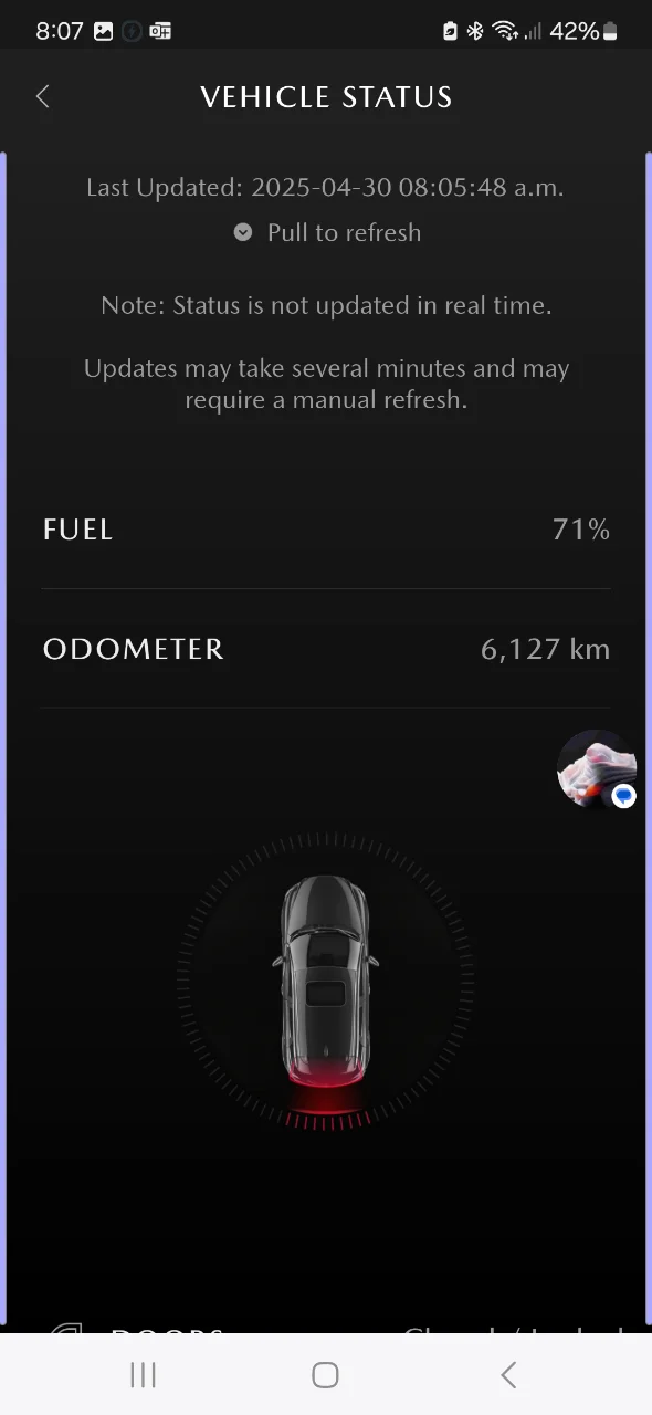

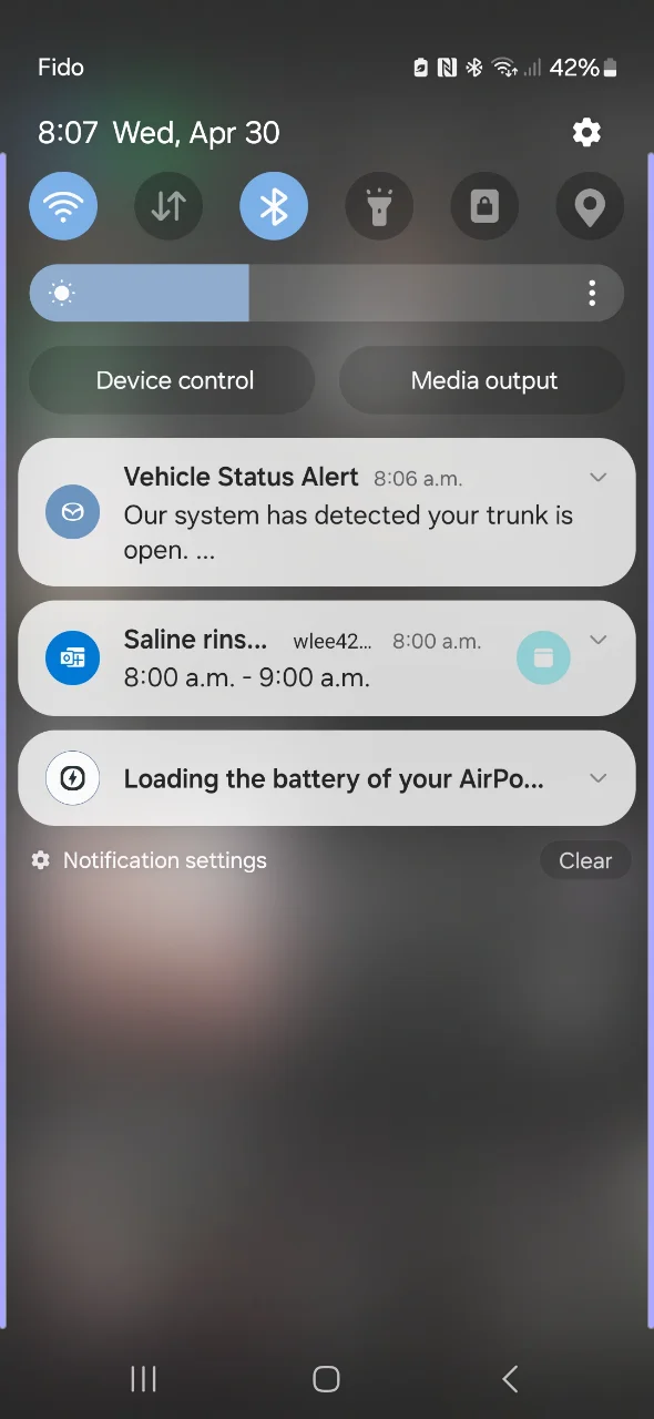

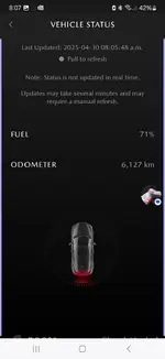

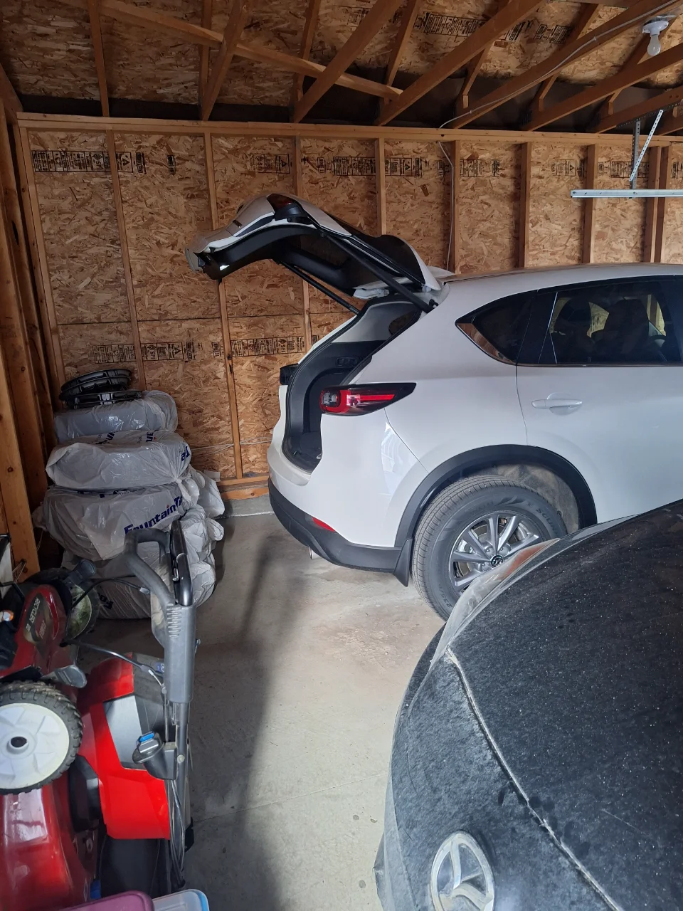

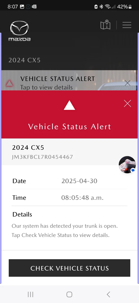

I noticed my 2024 Mazda CX-5 GS sometimes has a tendency to unlock doors and open tailgate by itself. I would have keys in my pocket and not press anything. My phone notified me per screenshots attached.
Dealership is willing to diagnose issue but if it's not warranty covered I'll be out of $199 just for diagnostics fees 😕.
Any ideas?
