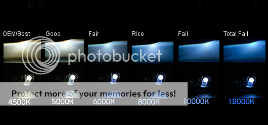

If you go as high as 8000k not only will you risk getting pulled over by the cops for having improper lighting. You will also endanger yourself by having inadequate lighting for night time driving.
Here is a reference for color:
