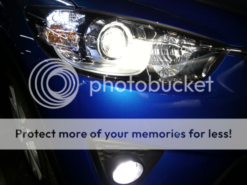

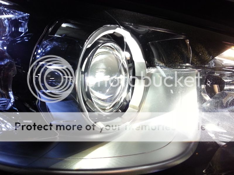

btw, I installed the 5000k version of philips 42402 CX replacing the OEM from Mazda (Osram Xenarc 4200K). My CX5 is AFS version, the AFS works fine, and for the hi beam works fine also.
I just join this forum, please to meet you all :)
Those look very nice Wi_lee!
