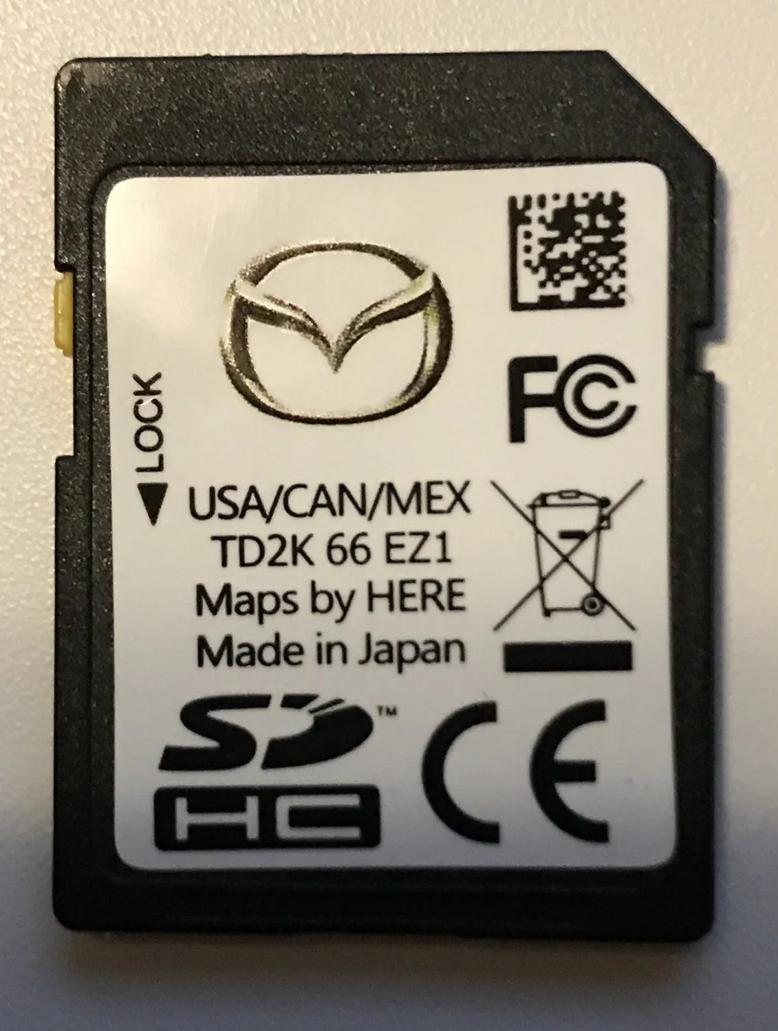

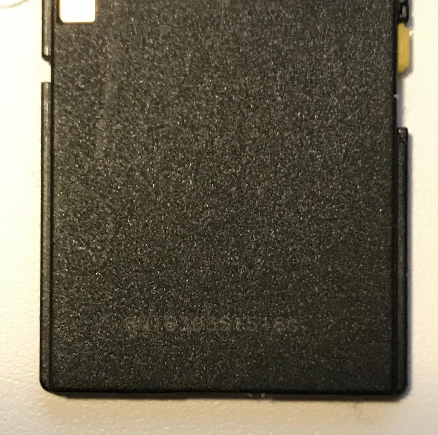

Can the two of you post pictures of both sides of the sdcard?
Also I would be curious to see/compare the CID of each card

Here you go. The back of the card has a serial number that is very hard to photograph clearly, but it reads BM1830351518G.
strange ... it has both the CE logo which is used in EU and the FCC logo which is used in US.
Here is a link that I found from a dealer website. Seems different card front.
What I find strange are the FCC and CE logos. I havent seen those logos on Mazda sdcards before + the seller is quite well hidden. Website with hidden owner hosted on Wordpress, no company name, no adress, no phone, no email on website. Except an ebay account and 2 reports so far that the cards cannot update.
Not sure what to make out of this.
