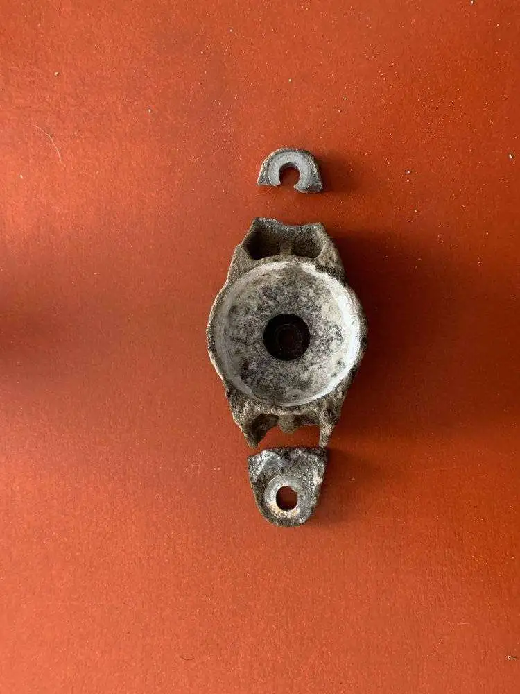

⋯ The rear shock mounting bracket is cast aluminum and firmly holds the shock to the body in stead of a through bolt. I could go on.
This aluminum rear shock top mount is prone to crack. and if you have a Gen-1 CX-5 you can’t get it separately other than getting it with the whole OEM rear shock which is now almost 3X more expensive than pre-pendamic. You can’t get this shock top mount from aftermarket rear shocks as they don’t include the mount.

Hi, I'm new here. I am a certified auto technician in Ontario Canada. I'm retired now but still get into repairing autos.
My GF 2015 CX 5 rear shock mount broke. I didn't want to rewplace the entire shock ($390.) Dealer CDN $
I did a lot of on line research & phone calls. Also looked for a used part.
Here is what I did , I used a top shock mount part # DA6A-28-380 from Mazda.
Used on a CX-3 2017.
Was $17 usd plus shipping.
I removed the old broken mount from the body, cut the damper cover at the bottom of the mount, removed the mount from the shock & installed the cx 3 mount to the shock & then to the body. I removed the cut portion of the damper cover from the inside of the old mount & before I installed the new mount I squeezed the upper damper cover into the new mount (not knowing this was only pressed in) I could have removed the cover from the mount without cutting it, but I think it would be difficult to install into the new mount. I used a vise. I applied some Lepage 2 in 1 sealant to hold the shock damper cover in place.
