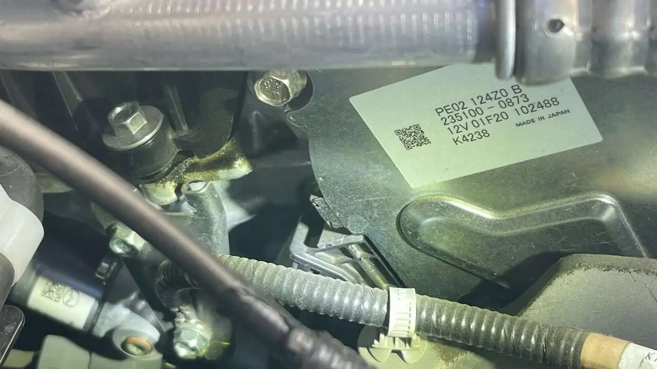

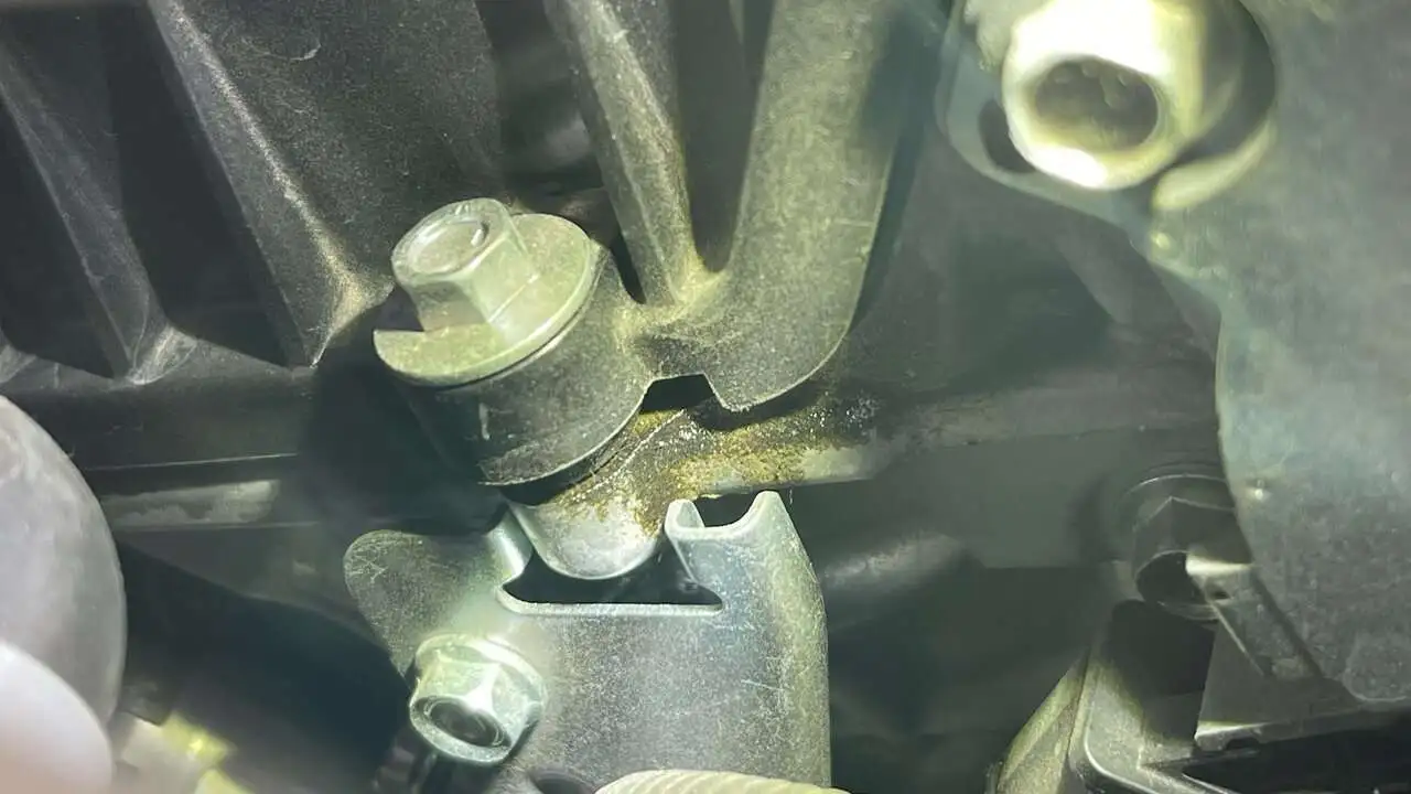

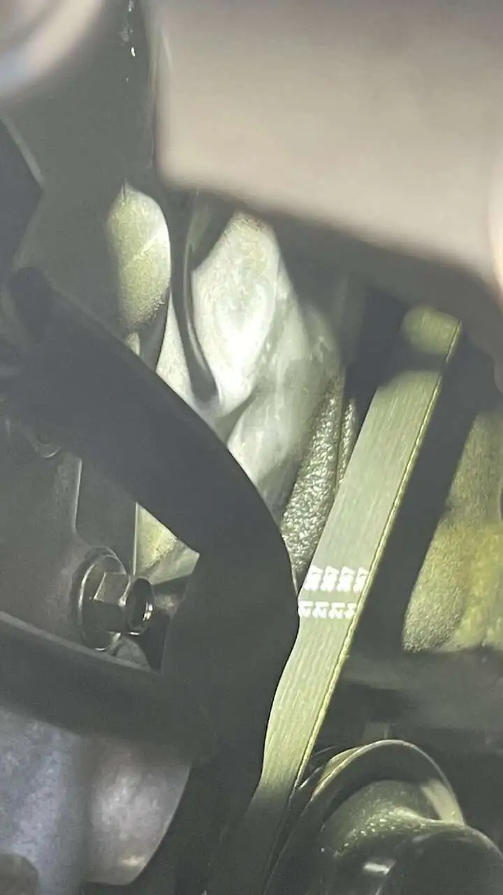

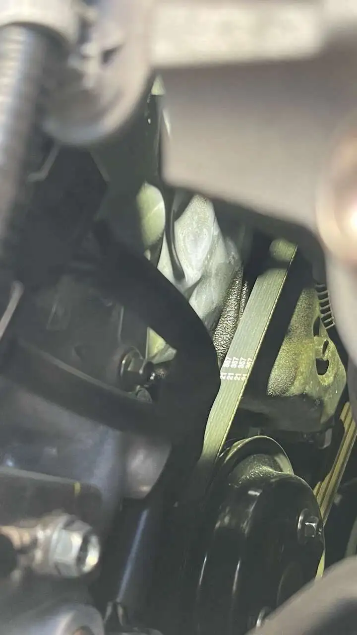

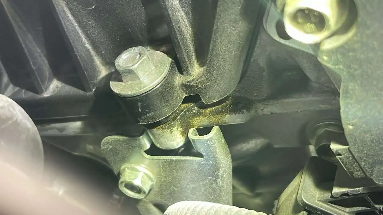

I am a proud owner of the Mazda CX-5 2022, but lately finding myself concerned about mysterious oil leaks. Did anyone experience the same issue? The dealership says it is a normal leak. But is it really normal for a brand-new vehicle to experience oil leaks?

Calling ANY fluid leak on a 1 or 2 year-old vehicle 'normal' is an abysmal response. While it might be considered normal to live with some minor leaks on a much older vehicle, no fluid leak of any kind on a relatively new vehicle is acceptable.
But much more importantly than their 'normal' response, what did they say about fixing the leak? I hope you're not going to reply that they don't plan to do anything, because that would be ludicrous. The leak appears to be coming from the valve cover, right about where the VVT oil control valve is installed on the head, inside the valve cover. And that's well-known to be an oil leaker, but in no way makes an oil leak there 'normal' :rolleyes:
Just pick up the car - they said it is minor and no repair is needed. I am not sure what to do. Change dealership?
You could either do that or go back to the same one and ask to speak to the owner/manager and tell them in whatever words you want to use, that's it's not reasonable for your nearly new vehicle to have an active oil leak go unrepaired.
And if no one wants to cooperate with what you're asking, then open a case with Mazda Corporate and present your complaint to them. It's frankly unbelievable to me that they wouldn't have just gone ahead and done that 1 hour repair, without any hesitation at all.

It's not uncommon for the gaskets on a valve cover gasket to become relaxed after many heat cycles.
In the time it takes to go to the Stealership, I'll put a wrench on all the valve cover bolts and snug them up. Then spray off the oil residue with brake cleaner.

Unfortunately it is common for recent Mazda models, for whatever reason randomly some will get seepage at different spots. I question the QA at the factory but not much we can do.
Sadly Mazda used to fix it no questions but lately (after covid) they call it normal unless it makes puddles on the ground and some dealers dont want to fix it. The problem is sometimes the dealer mechanic make it worse after fixing it. So its a risk to take.

The chain cover leak TSB is now extended up to 2023 models. Starting at 2017. Wont be surprised if they extend it to 2024 soon.
Mazda qualifies a leak as having wet spots, oil
drips and wet oil spots on the bottom plastic cover. Othwrwise it rejects warranty lately.
