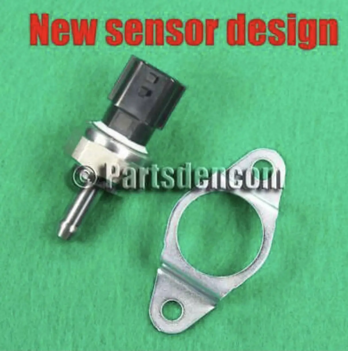

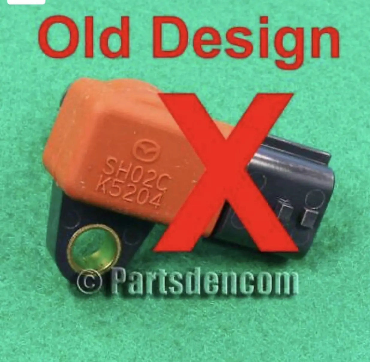

If I were you I’d check with Mazda dealer in Scotland or Mazda UK directly finding out if there’s any help to this problem such as a recall or extended warranty on “exhaust pressure sensor” for Mazda SkyActiv-D 2.2L diesel. It seems to be a common problem on 2.2L diesel, and some even says there’s a recall on it in UK few years ago:
CX-5 Engine exhaust pressure sensor replacement
Although in his thread Pavlos Petsa said he needed exhaust pressure sensor for CEL code P2262, but the schematic he provided where the green arrow pointed to is the exhaust CMP sensor (Camshaft Position (CMP) sensor) which is a different part.
And after some checking on exhaust pressure sensor for 2.2L diesel, there’s re-designed aftermarket part available on eBay, which indicates the original exhaust pressure sensor is problematic. Mazda could have re-designed the same part for OEM too.
The sensor replacement seems to be easy.
