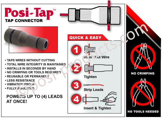

IMO these are far better tap connectors than the cheap blue ones you can get everywhere.
http://www.posi-lock.com/posiplug.html
