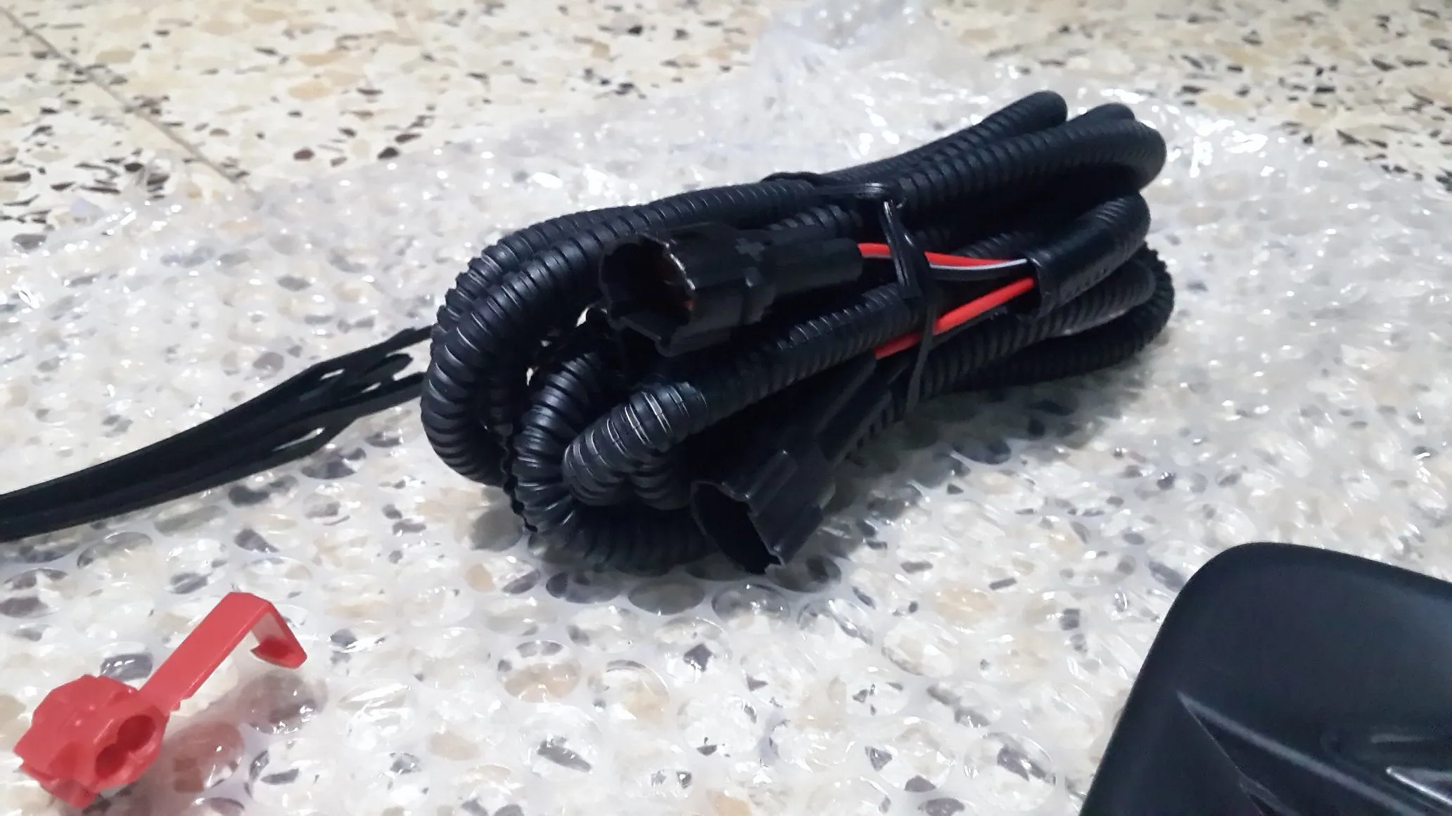

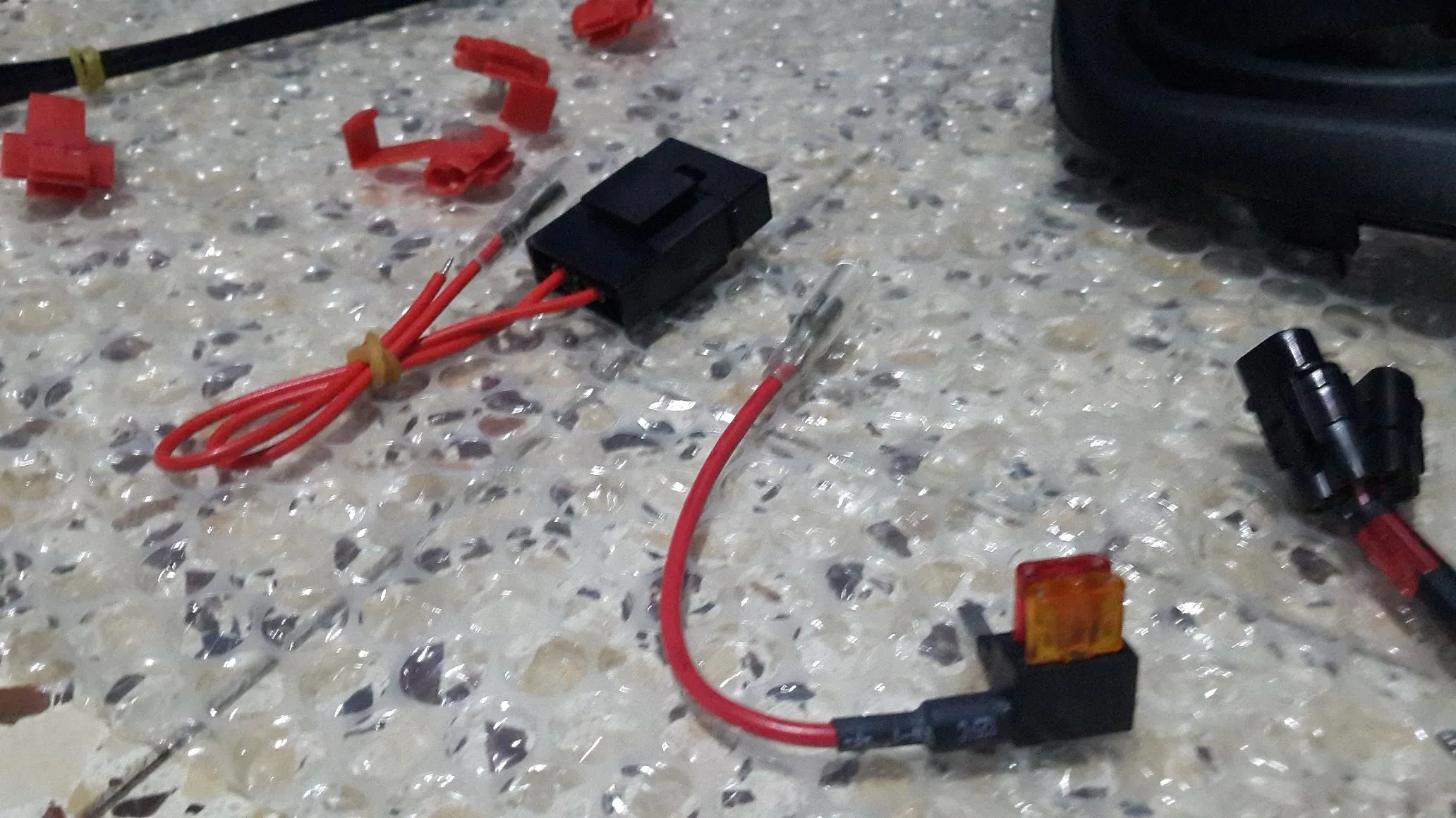

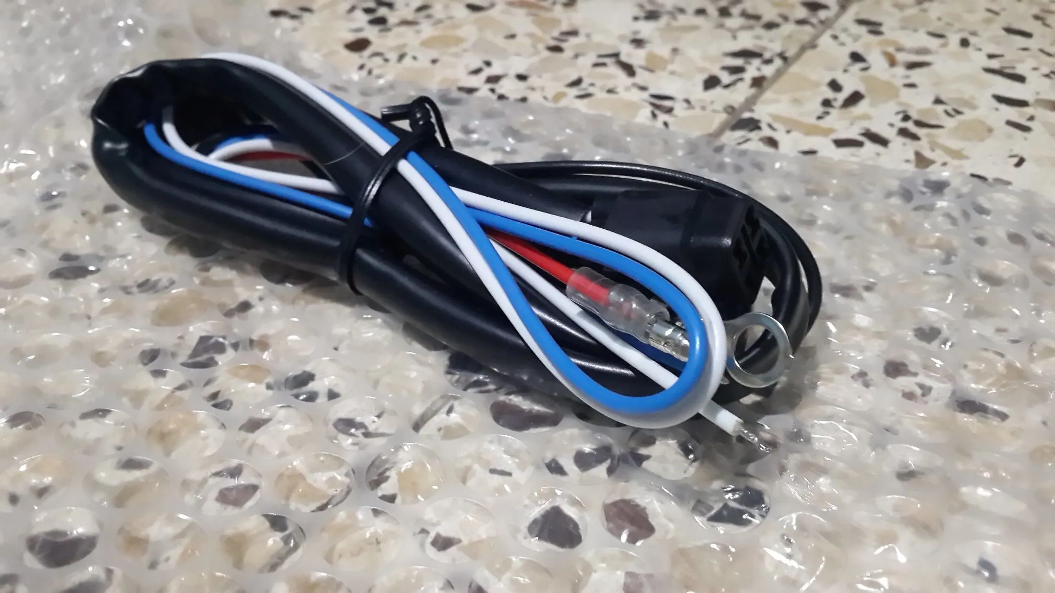

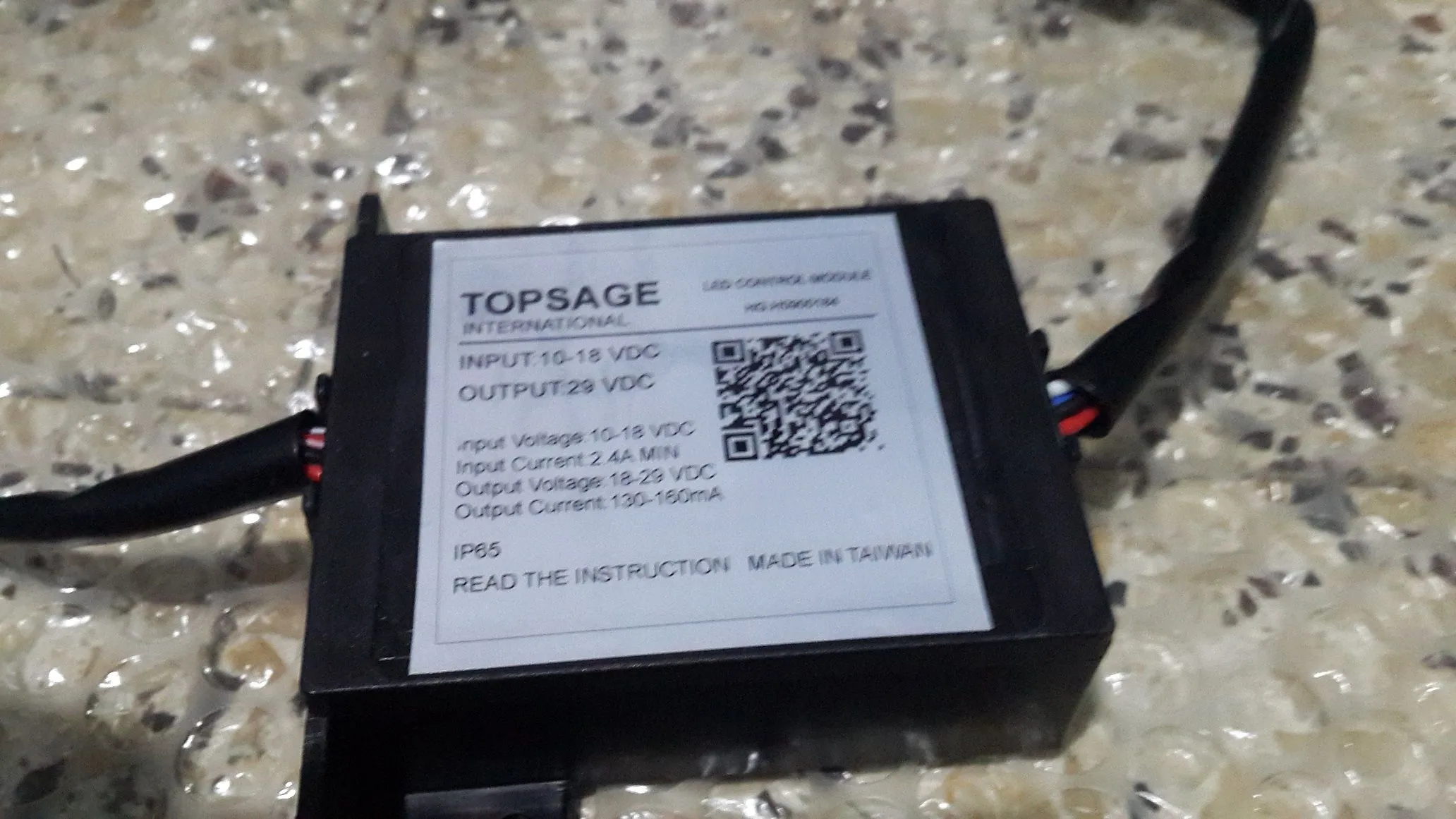

So, I've made a purchase of this kit from: http://www.ebay.com/itm/111028249042?ssPageName=STRK:MEWNX:IT&_trksid=p3984.m1497.l2649 as recommended in the previous posts.
And I've got the kit in the pictures, attached below.
Note: The seller is amazing! the delivery was very fast!
Though, the manual is not for newbies like me.
Maybe you can help me understand what should be connected to where?
I've read this all thread for about 3 times, though - I saw that peoples talking here about several types of this kind of kit.
Thanks in advance!!!

It depends on what you want to do: dim or not, etc. You have the same kit as most of us, so you can ignore any post mentioning different ones. I had never done this, and the instruction here were sufficient for me to get through it in about 30 minutes. Basically most connectors are obviously male/female counterparts. The part with the fuses plugs into the accessory fuse slot and the metal loop on the end of the black wire is your ground, it goes on basically any bolt on the cars metal frame.
