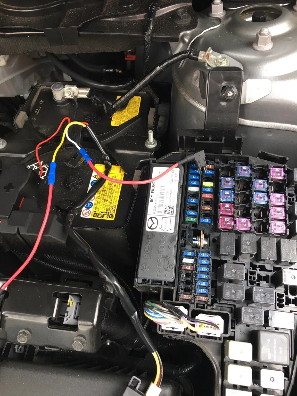

I finally got a chance to install my LEDs. Coming from someone who has no idea about car electronics, it probably took me a solid 90 minutes.
I didn't purchase any additional taps or connectors; just bought zip ties and gorilla double sided tape. My kit had a red wire going to ACC+, black wire to battery and white wire to headlight (for dimming). For the wire going into ACC+, I basically crimped the wire, stuck it into the positive spot, and placed the normal ACC fuse back in. Same thing with the white wire to headlight (put it underneath the existing fuse for left headlight.
Question: everything appears to be working as they should but did I do something that could blow up my car?

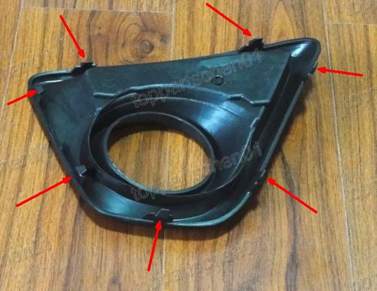

plastic surround has one way tabs that clip to the bumper only, they are not attached to the fog light housing, you have to remove the bottom panel right under the foglights and feel for the seven tabs and then press them individually away from the bumper lip so they can come out easily from the front, see below, don't try to yank them out you will deform and stretch your bumper at those clip points, they are one way tabs not spring clips. the tabs must be swung away from the bumper lip edge to come out. They are very easy to remove as long as you remove the bottom undercarriage panel and get your arm inside and feel for the tabs.

Great. Thanks.
Hoping to try this afternoon. Will actually take the entire panel off this time instead of half of it.
I feel like Homer Simpson with my arm jammed into a vending machine.
Sent from my iPhone using Tapatalk
Got the covers off yesterday. As someone else said, if you get the bottom tab loose then you can pull from the front and the rest will come off too. New covers popped right in.
