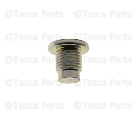

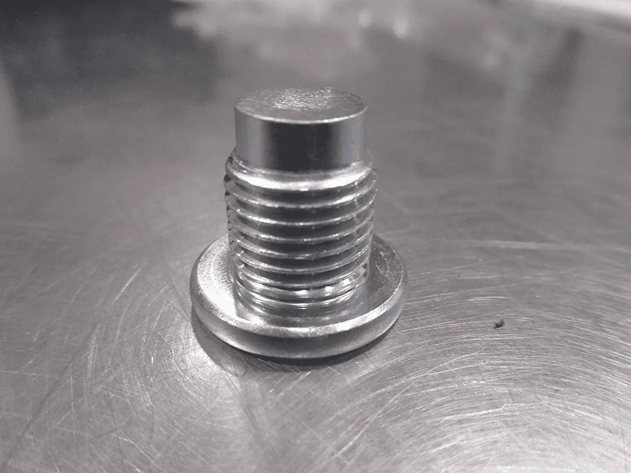

You may have trouble to find 8 mm internal Alllen drain bolt right now as Mazda has switched to 17 mm flange Hex drain bolt for all engines. You’ll find the same part number, FS50-21-249, as the drain plug for ALL MY 2.5L and 2.5T’s. And it should be ended up with a Hex drain bolt, although the specific 17 mm flange Hex drain bolt used to use part number LFE5-10-404:
You can swap out the 8mm hex plug for a traditional socket head drain plug https://www.mazdaparts.org/mazda-oil-pan-plug-washer.html that maybe her dealer won't be able to screw up so easily.

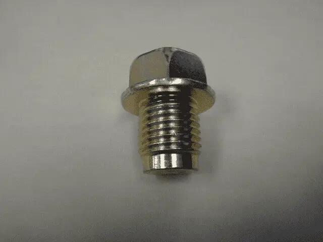

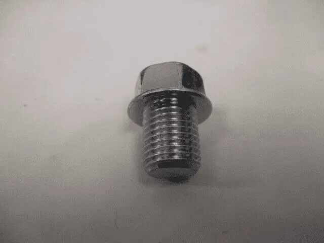

Do not get this hex-head drain bolt P/N HE0310404-995641400 if you really want one:
It doesnt have flange which should have for a drain plug. Instead, get this hex-head drain bolt found on 2018 CX-5 2.5L and beyond with P/N LFE5-10-404:

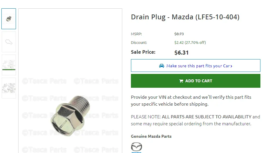

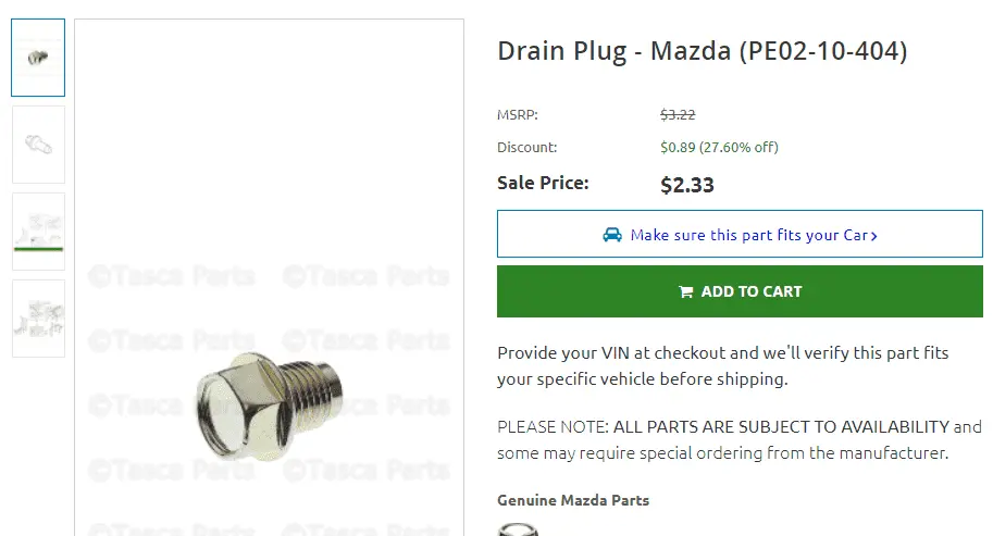

Hey guys,
I've recently just stumbled across this thread but there appears to be alternative to LFE5-10-404. Based on what I am seeing, it looks like PE02-10-404 may be compatible as well, can anyone confirm? The tip of PE02-10-404 looks very similar to the OEM bolt that came with the CX-5. Assuming it's compatible, it would be $4-5 cheaper, not that it's a huge deal but just an observation.
FS50-21-249 (Price: $5.66) - OEM
LFE5-10-404 (Price: $6.31)
PE02-10-404 (Price: $2.33)
