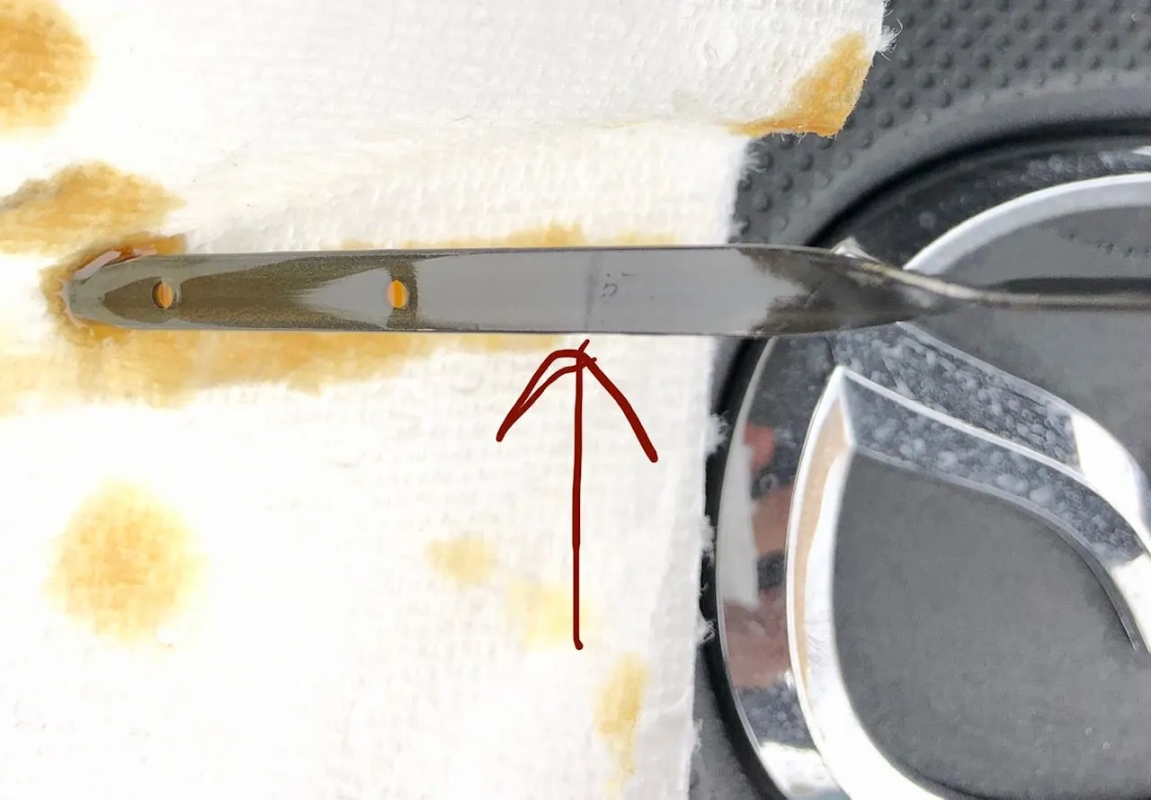

Actually, from mid-point to the MAX line it's 0.5 qts. It's 1 qt from the MIN to MAX lines
I changed the factory fill at 1000 miles and changed it again at 5000 miles. I n the engine for a few minutes and checked it later that afternoon. The oil was at the lower dipstick mark. It took another half quart to hit the top mark That was my first indication that the Mazda manual was in error.
I'll repeat the experiment upon my next oil & filter change.
I don't worry about it much but I am curious as to why the manual seems wrong. A typo? conversion error? Maybe they have some motive?
Not according to ole' Dwight...
"I added the contents of a 5 quart jug,
It took another half quart to hit the top mark."

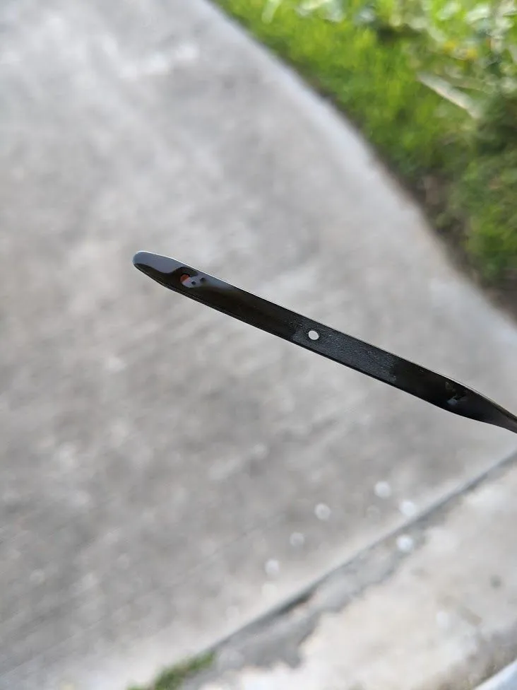

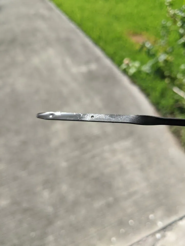

I just checked the oil level on my 2017 2.5L Mazda 6. It hasn't been turned on in two days and I always use 5qts of Mazda Moly Oil
I'll take another pic tomorrow after running around town and letting it settle for 5 min
Ok, here is the oil level after 2 hours of freeway driving and waiting 10 min. It's actually a smidge lower than the level after sitting for 2 days (pic is a few posts up). I'm guessing that this is because all of the oil hasn't flowed down yet
