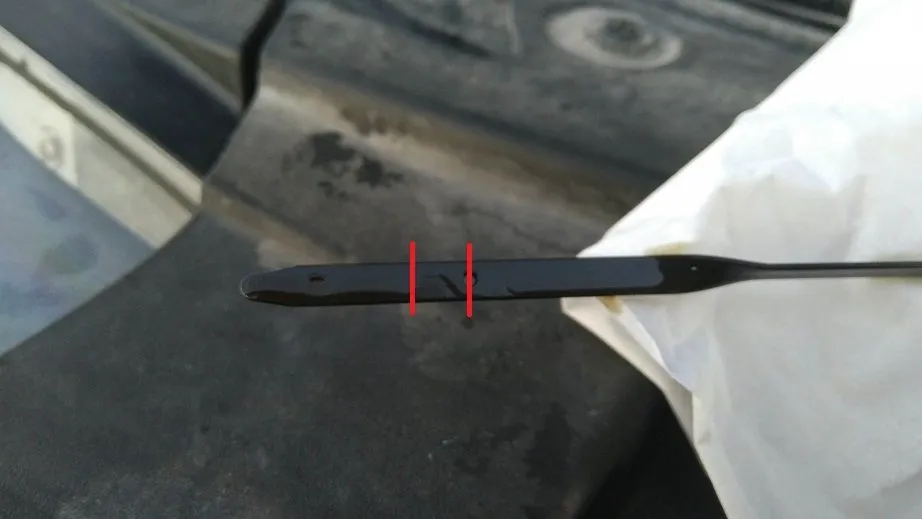

Some of us are finding our engines are overfilled with oil. I, for one, don't consider my investment into a new vehicle a negligible expense so I am pretty interested in hearing what others are finding.
Here is my dip stick that shows it's overfilled a substantial amount.
and...yes...I am an Engineer 🤣

Is that the factory fill or after an oil change? What does it look like when it's been sitting overnight?
Mazda oil dipsticks are very hard to get a good reading on if you don't wait long enough for the oil to settle. Oil inside the dipstick channel can show oil all the way up to the twisty section sometimes. imo, the manual should be changed to say wait a min of 15 minutes before checking the level
Yes, and that’s why I said earlier it took me several wipes and tries to take a good read on the dipstick when I tried to take the oil level measurement 5 minutes after the engine was turned off. Those who use the procedure outlined in owner’s manual taking the oil level when it’s hot and didn’t complain on this? That makes me wonder ⋯
And that’s also why I always check the oil level the first thing in the morning with enough time to let oil to drain back to the oil pan.

I took this pic back when they replaced the engine in my 6. So this was factory oil fill. It had sat for hours before I checked it. If I recall, I checked it again another time and it was fine.
I was stumped and still am. Pretty sure that car was hexed though.

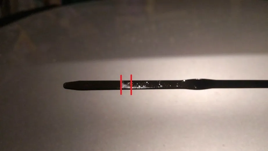

I changed the oil on my 2018 CX-9 yesterday.
Oil level check after letting the car sit for about 12 hours. Did a pull, wipe, reinsert, then pulled again and took the picture.
After 30 mins of driving, this is the oil level check 6-7 mins after vehicle shutdown (as recommended by the manual).
It's a little hard to see, but there is a difference in the oil level shown on the dipstick.
So what does this mean? Well, IMO it means that reading your oil when cold results in a higher reading than when the oil level is read according to the manual. So let's say the dealer were to do an oil change following the procedures in the manual, then top up the oil so that it's right at the "Full" mark. Someone who checks the oil while cold might think that the dealership overfilled the engine, when they actually didn't.
To be fair, judging by the difference in levels, the "overfilled" amount is nothing to be concerned about IMO. This also means that if you do check your oil level when cold (and top it off to the "Full" mark when cold), then your oil level when read according to the manual would actually be a little below the "Full" mark. Again, nothing to be concerned about.
That's my interpretation from my experience with my engine.
The oil level is below the full mark after driving and checking 6 or 7 minutes later because the oil didn't have time to drain into the pan completely. When checking the oil level by the manual's instructions, step 5 says add oil if the level is near or below the min mark as opposed to saying add oil if below the full mark. They are compensating for a below full mark because all the oil may not have had time to drain into the pan depending on how long one waits after turning the car off. The most accurate oil level is when the engine is cold. If the level shows above the full mark when cold, it is over filled.

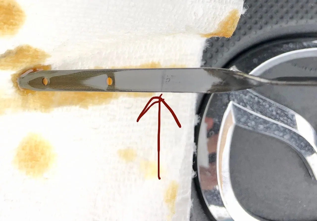

You put in 5 L / 5.3 qt. of oil for your 2.5T and it still needs about 0.3 quart (cold, from your picture) to get to the MAX mark of the dipstick, as the oil level from MIN / ADD mark to MAX / FULL mark is 1 quart in convention and also said in Mazda owner’s manual.
Many 2.5L owners including me also found we need at least 0.5 quart more than specified oil capacity to reach to the MAX / FULL mark of the dipstick (cold).
