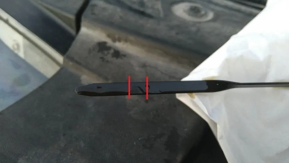

I changed the oil on my 2018 CX-9 yesterday.
Oil level check after letting the car sit for about 12 hours. Did a pull, wipe, reinsert, then pulled again and took the picture.
After 30 mins of driving, this is the oil level check 6-7 mins after vehicle shutdown (as recommended by the manual).
It's a little hard to see, but there is a difference in the oil level shown on the dipstick.
So what does this mean? Well, IMO it means that reading your oil when cold results in a higher reading than when the oil level is read according to the manual. So let's say the dealer were to do an oil change following the procedures in the manual, then top up the oil so that it's right at the "Full" mark. Someone who checks the oil while cold might think that the dealership overfilled the engine, when they actually didn't.
To be fair, judging by the difference in levels, the "overfilled" amount is nothing to be concerned about IMO. This also means that if you do check your oil level when cold (and top it off to the "Full" mark when cold), then your oil level when read according to the manual would actually be a little below the "Full" mark. Again, nothing to be concerned about.
That's my interpretation from my experience with my engine.

The statement I made in post #91 was just paraphrasing what Steve88 wrote. As shown in the post above this one, my actual experience was different. So yes, you're right, my experience and Steve88's experience are different.
In my experience, the oil level when cold reads slightly higher than when it is read according to the manual. I checked again today with the same results.
Steve88's experience was the opposite. Oil level when read cold is lower than when it is read according to the manual.
I don't know why our experiences would be different, but they are.

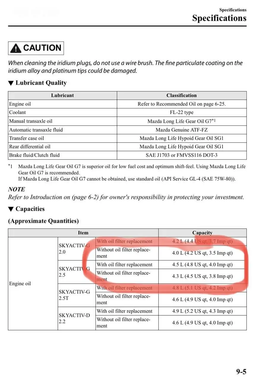

As stated in the manual "all capacities are APPRROXIEMENT"
Would you call it “approximate quantity” when the actual capacity of the rear differential is 66% larger than given capacity on specs?
Maybe you're overfilling your rear diff ;)
I would not call it an "approximate quantity". In fact it sounds like there is an error in the manual. They list 0.37 qt as the capacity, but specify that the diff should be filled to the brim of the fill hole, which in practice, is about 0.8 qt. So either 0.37 qt is an incorrect value, or filling to the brim of the fill hole is not required.
Either way, this example is somewhat unrelated as the process specifies the quantity, and the direction to "fill to the brim". Rear diff oil change also does not have a filter that can be prefilled or not. Engine oil process simply specifies 4.8L per oil change, and the actual amount can vary depending on the person doing the oil change (again, prefilling filter, draining for 10 mins vs 1 hour vs overnight, filling to max mark, etc.).
It would make sense that the CX5 dipsticks was calibrated to be accurate when oil levels were taken when hot. Manufacturers more and more are recommending hot readings with calibrated dipsticks because they know that oil expands or volume increases when oil is hot and presume most people don't want to wait around if on the road until car cools completely down to check their oil.
My oil level reads exactly the same warm or cold
If you feel you need to drain out every last drop of old oil and refill it to the max line and nothing less, then yes, the 4.8L specified in the manual could be considered "wrong". But again, the problem with thinking this is that you assume EVERYONE changes their oil the same way that you do, in the same conditions that you do, which obviously is not the case.
I don't know if it's because of warm or cold oil, but I have found different levels shown on the dipstick, like after overnight vs. waiting 10-015 minutes. I wonder if there is oil in the oil passages, like for the valve train with the variable cam timing, the oil control valve, etc.
and if you check after few weeks you would be surprised to see it goes even higher up on the dipstick:)
Its normal.
I wonder how the level would read with 4.8 quarts PLUS a pre-filled filter? The filter is pretty small but it would add something. I always prefill the filter on the Mazda because it screws on from the underneath and I don't spill any of it.
The OEM oil filter holds about 0.3 quart of the oil. So it’s 4.5 quarts based on CX-5’s specs if you pre-fill the oil filter as the specs say 4.5 quarts is for oil change without oil filter replacement.
Although engine oil does expend a little when warm, but it also takes time to drain most oil back into the oil pan. The more you wait, the more oil is draining down which will make the oil level a bit higher.
Although engine oil does expend a little Qwhen warn, but it also takes time to drain most oil back into the oil pan. The more you wait, the more oil is draining down which will make the oil level a bit higher.
