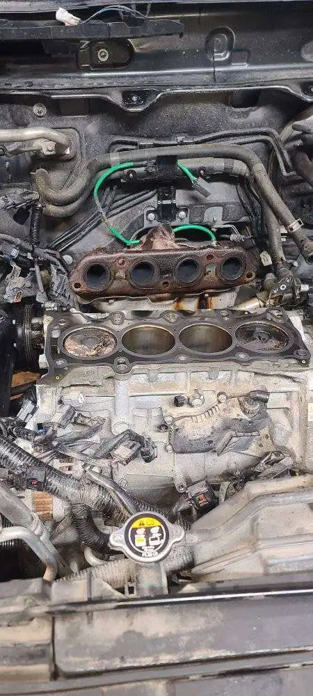

I wouldn’t be that optimistic as we still see cracked cylinder head report from time to time from the 2.5L NA with CD on newer CX-5 and other models.
It is still happening with the 2022 models. I just got my cylinder head replaced under warranty. It's a CX-5 with a skyactive engine; it's not the turbo. I bought it new in March of 2022 and it only has 13,000 miles on it. There were no warning signs or symptoms other than the low oil level light coming on. I have the oil changed twice a year, so that definitely shouldn't have happened. I stopped immediately so no damage was done to the engine. I hope the replacement head will last.
Not like the 2.5T, Mazda has never modified the cylinder head to the 2.5L NA with CD like they did to the 2.5T to fight against cracks. The cracked cylinder head will happen from time to time on the 2.5L NA with CD even on newer MYs although I believe it won’t be as frequent as the 2.5T. There’re several videos showing the cracked head, and plenty of reports here if you’re interested.

Regarding the topic,
The mechanic from the videos I posted before seems to be very experienced and he was literally shocked when he started welding the crack. The thickness of aluminum in that area was around 2mm. As an example, he was comparing and showing some Chinese brand cylinder head he found in his workshop, and the thickness of the aluminum edge there was about 7mm, which is approx 3,5 thicker.
Finally, he was highly disappointed with the way how Mazda designed the new cylinder head, specifically in saving the cost of aluminum in that area.
His advice was to not leave this particular engine downtime for a long period, as hydraulic cranks (the area where cracks appear)can possibly get jammed and cause significant stress when the engine is starting again after a long downtime.

I made an account just to reply to this thread. I've been a tech for Mazda for over 15 years now, doing my second bad head related replacement today actually. The first time I found one was on a CX9. No complaints, was just a simple 16k service and I noticed that the oil and coolant had mixed together, opened a ticket to Mazda Canada and they sent an engine replacement. Now the problem is so common that we just replace the head and gasket. The problem seems to be from a small crack in the head near the exhaust manifold bolts. The engine will either leak coolant or oil depending on where it's located, but the leak gets worse the hotter the engine gets. Thanks to supply problems, took well over 2 months to get the parts needed to repair this CX5 I'm working on today. As far as how common this is, my dealership has done maybe 9 or 10 heads in the last year.
We never remove the engine, requires the subframe to come down and a LOT more work afterwards including an alignment. I'm also not sure how you could do this job without removing the timing chain altogether, because both cams come out during the head replacement and the actual timing chain cover is bolted in some places to the head. The job is a messy pain in the rear, and warranty pays next to nothing compared to CP. But right now during slow season we welcome this sort of work. Just a shame it's happening, but luckily every single repair we have done has been covered by Mazda with the customer in a rental. Sometimes for weeks or months.
