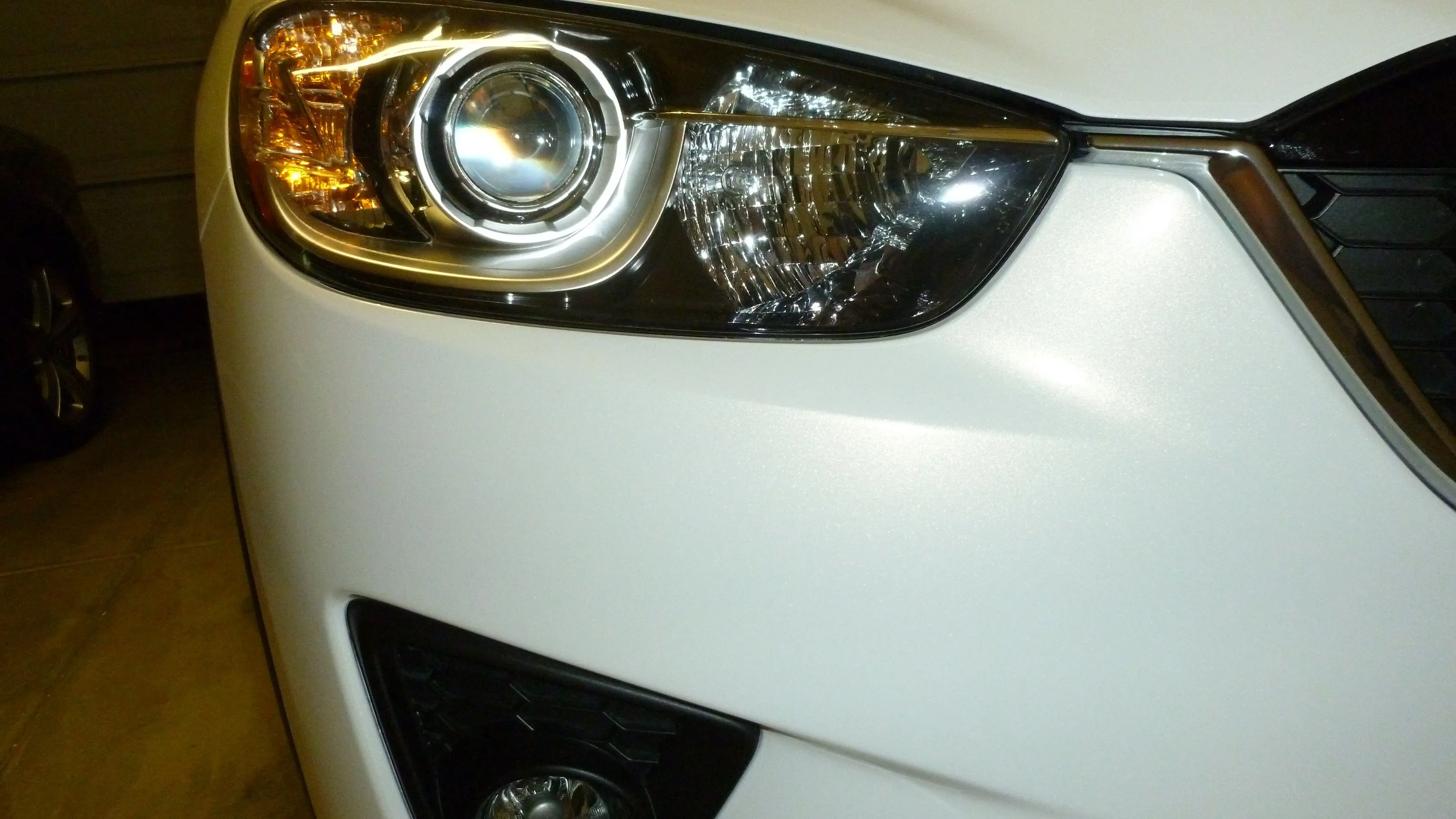

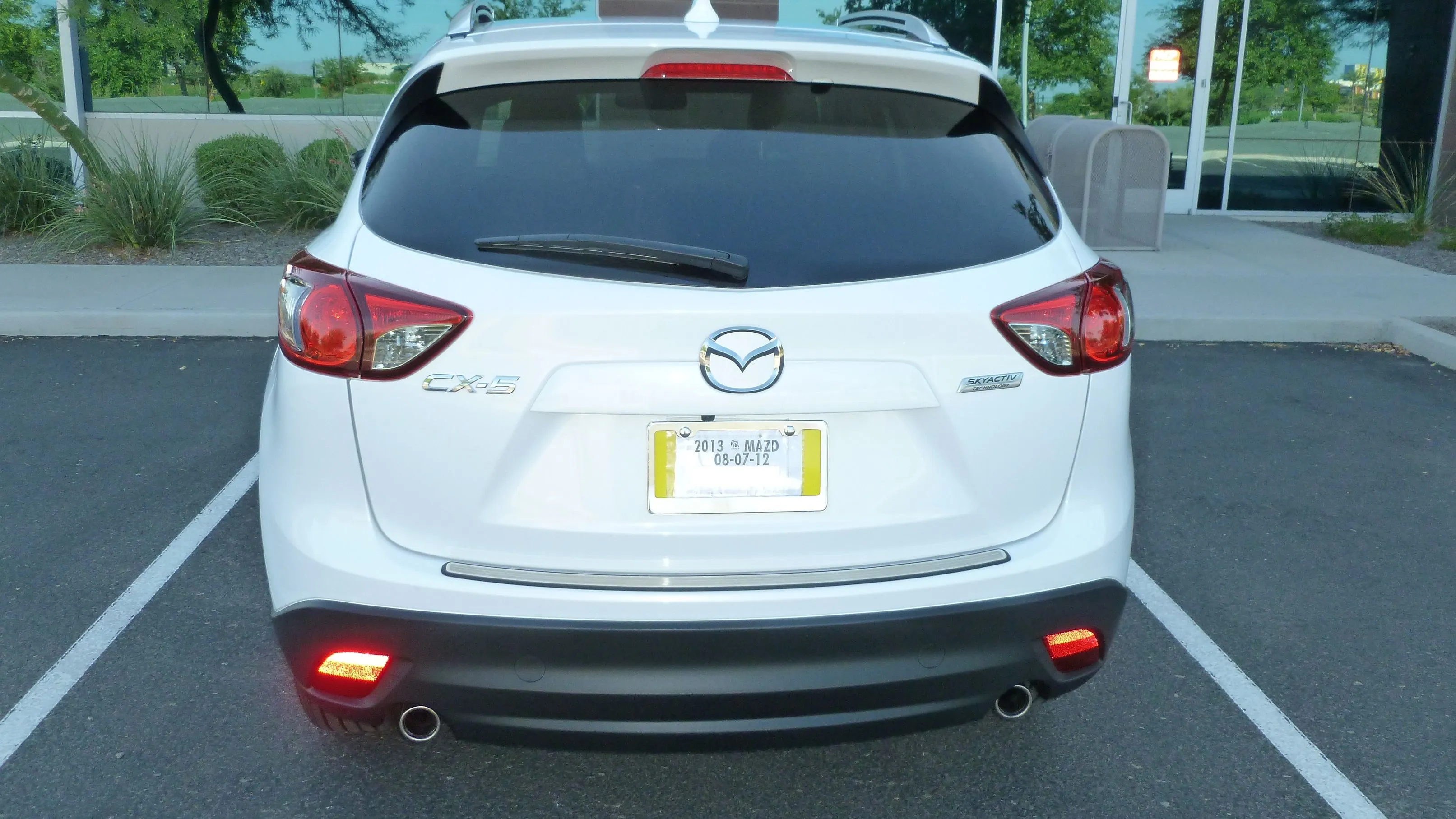

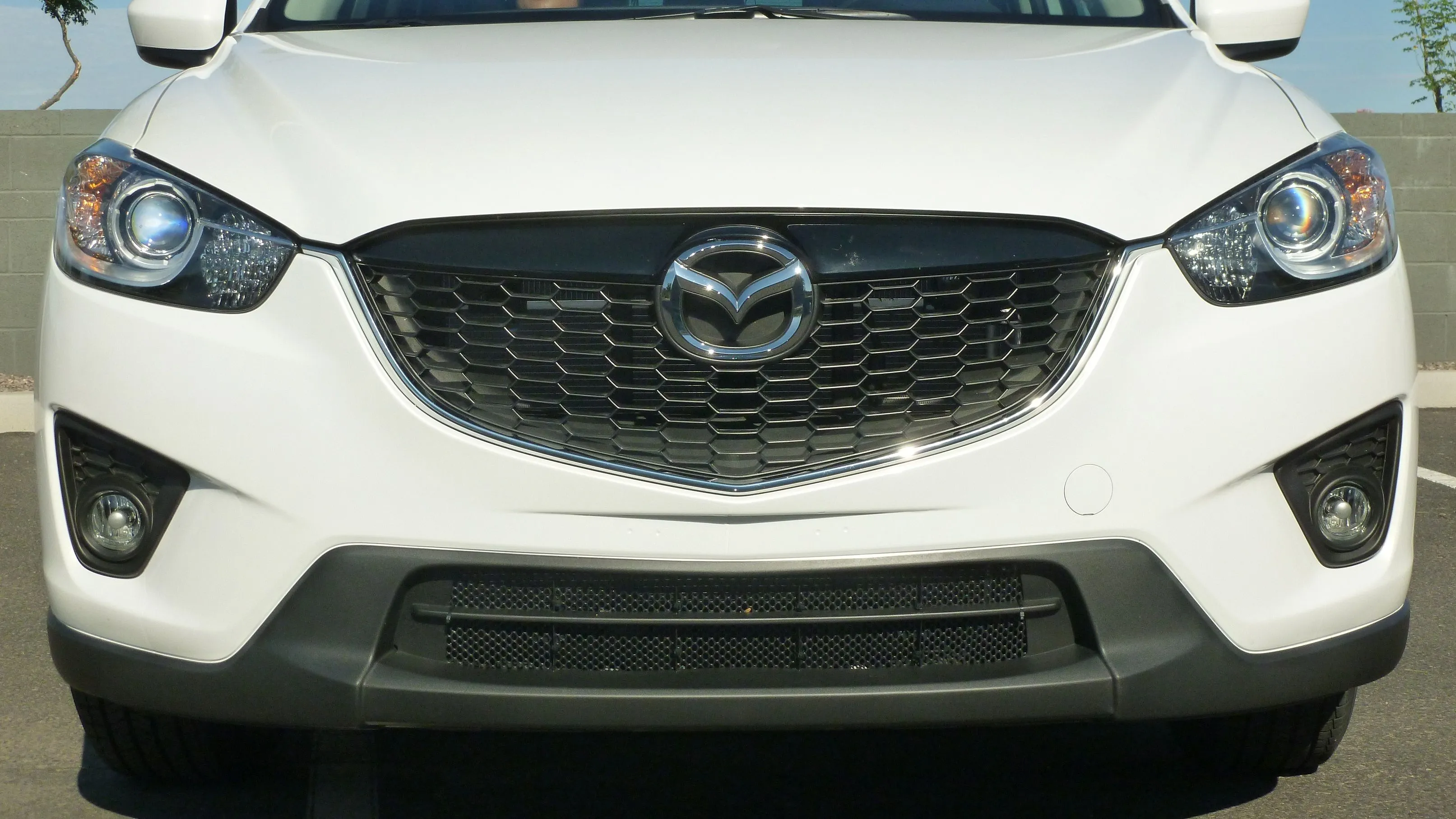

I took pics of paint protected sections installed on bumper, lower hood, headlights, fogs, fenders, mirrors, and black nose piece. Also on the rear hatch (bottom and under mazda logo). You have to zoom the pics to see the film's lines.
*edit: you can tell my error on the passenger side hood near the headlight. It isn't flush while the driver's side hood film went requiring me totaper under the hood. Also the mirror kit was much to small. Otherwise good coverage.
