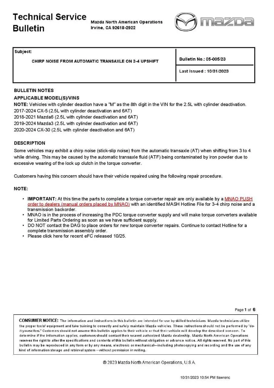

2017~2024 CX-5 Chirp Noise from Automatic Transaxle on 3-4 upshift - Bulletin 05-005/23
Kedis82ZE8
'15 CX-5 AWD GT w/Tech Pkg
Contributor
APPLICABLE MODEL(S)/VINS
NOTE: Vehicles with cylinder deaction have a "M" as the 8th digit in the VIN for the 2.5L with cylinder deactivation.
2017-2024 CX-5 (2.5L with cylinder deactivation and 6AT)
2018-2021 Mazda6 (2.5L with cylinder deactivation and 6AT)
2019-2024 Mazda3 (2.5L with cylinder deactivation and 6AT)
2020-2024 CX-30 (2.5L with cylinder deactivation and 6AT)
DESCRIPTION
Some vehicles may exhibit a chirp noise (stick-slip noise) from the automatic transaxle (AT) when shifting from 3 to 4 while driving.
This may be caused by the automatic transaxle fluid (ATF) being contaminated by iron powder due to excessive wearing of the lock up clutch in the torque converter.
  • MC-10244672-0001.pdf
DESCRIPTION
View attachment 323848View attachment 323849View attachment 323850View attachment 323851View attachment 323852View attachment 323853
