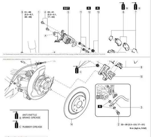

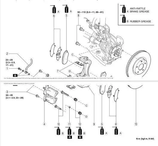

Like theblooms, I usually use OEM brake parts as most of time the OEM brake pad kit comes with all the necessary hardware and grease (not on Mazda though). You may want to get new shims、guide plates (springs)、and rubber dust boots (for slide pins as those are marked “R” in workshop manual).
Front:
Rear:
I use silicone-based AGS Sil-Glyde for “rubber grease” and moly based (black) brake grease for “anti-rattle brake grease”.

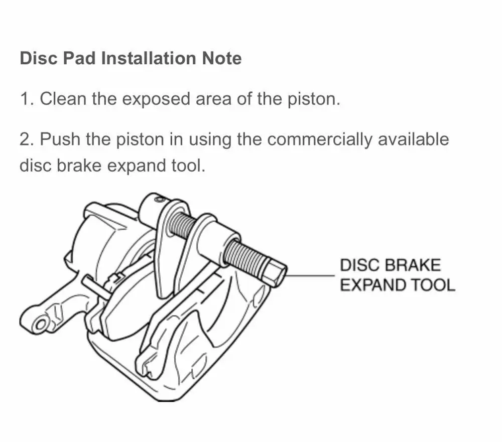

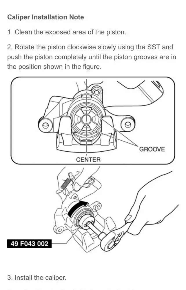

You need some brake tools to push front caliper pistons and push and turn rear caliper pistons making enough space for new pads. Watch the brake fluid level in brake fluid reservoir on brake master cylinder as brake fluid may be overflowing while you’re pushing the piston in. Some suggest to release the caliper bleeder valve to let the brake fluid out when you push the piston, but I’ve never done that way unless I plan to change the brake fluid in the system after the brake job. You can rent special brake tool set (especially for your rear brakes you need a special tool to “push and turn” the piston) for free from AutoZone.

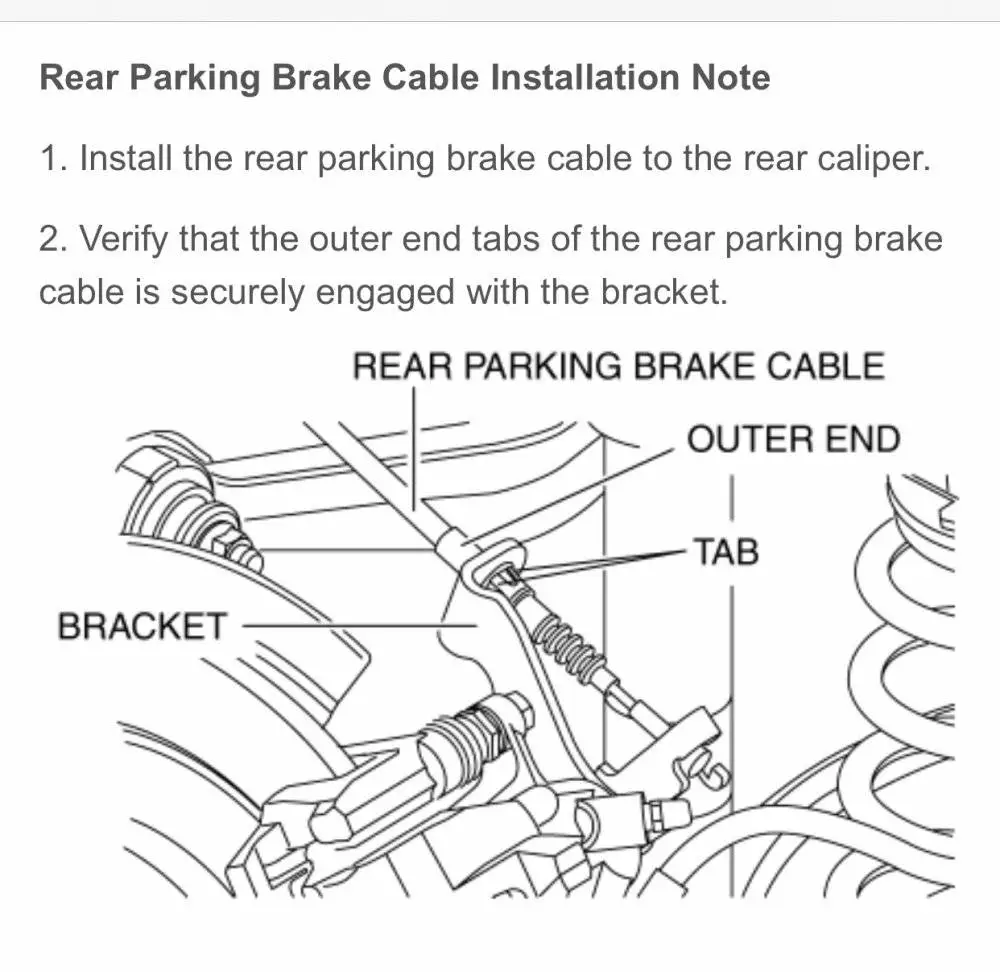

At 108K miles, you may need parking brake cable adjustment.
You can read Mazda Workshop Manual for proper procedure on brake pad and rotor replacement.

I find it laughable that they tell you to use a special tool to turn the caliper back. As long as its in service mode, you can treat it just like any other caliper.
The service mode is for 2016 and newer which have the EPB. My 2014 requires the rear caliper piston to be rotated back into the caliper.
