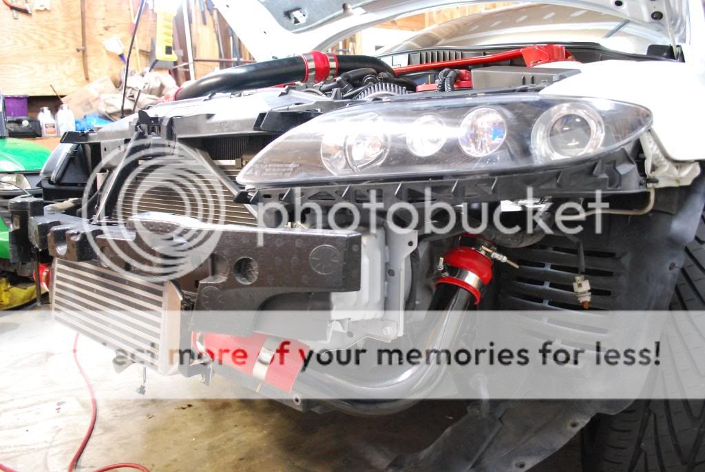

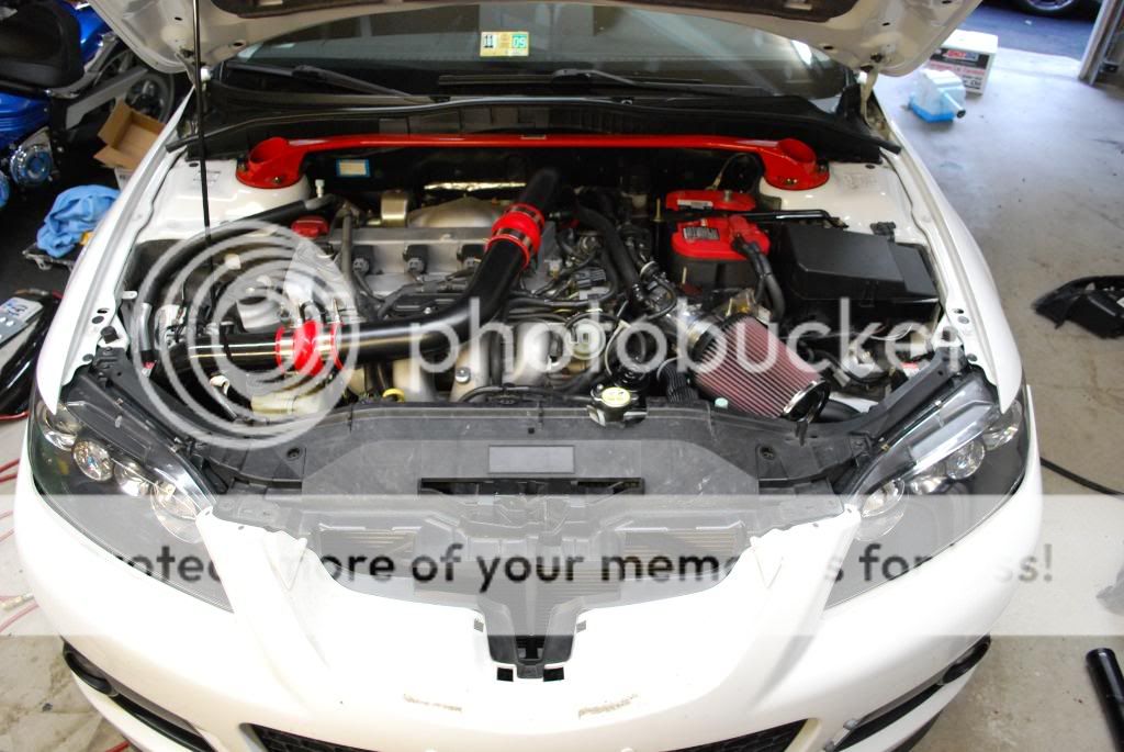

Been thinking to switching to a FMIC for a long time. So for the past month I have been ordering parts for a custom kit. I got all my info from another member from another site. So im not taking all the credit for this setup. Also got some second hand brackets for this setup to mount the intercooler to the crash bar.
Been working on this for the past 2 days. Still not finished. Just small things like mounting the new washer tank still needs to be completed.

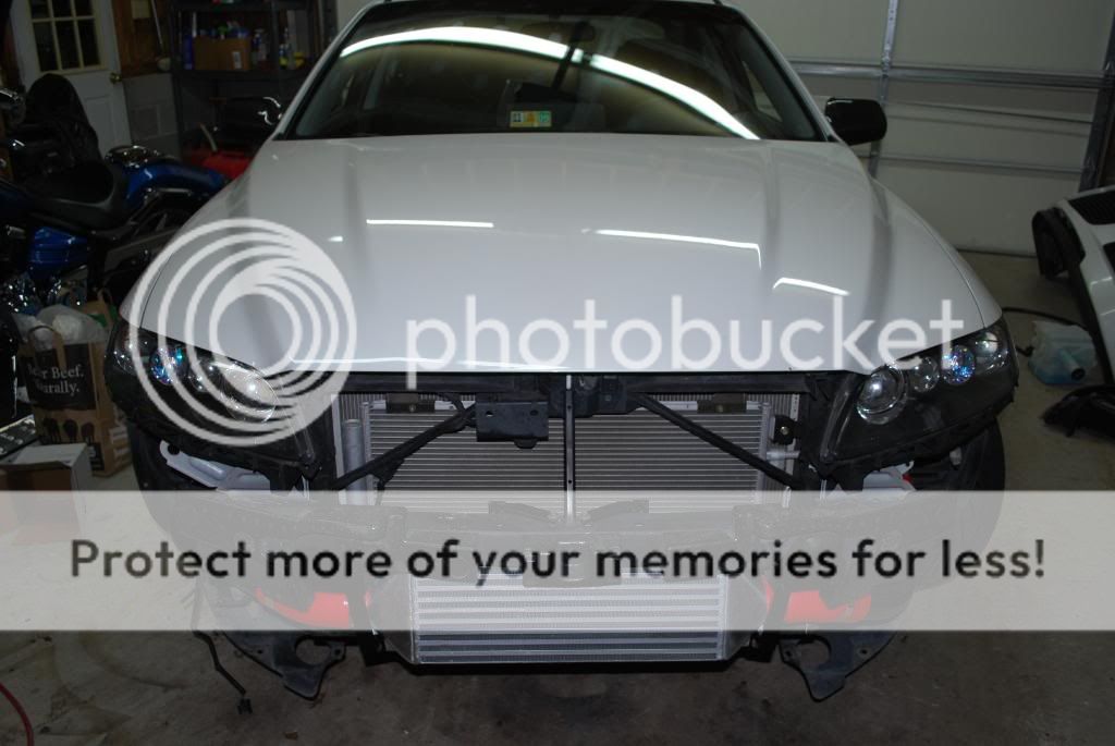

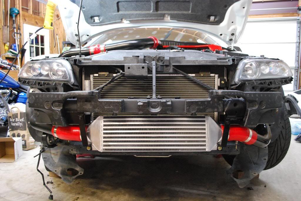

I could not believe how easy it was to remove the bumper! First timer here and took me 20 minutes flat. Cutting the crash bar took me an hour though... 20 hours into the install now. Hopefully 3 more to finish this up tomarrow. Enjoy :)

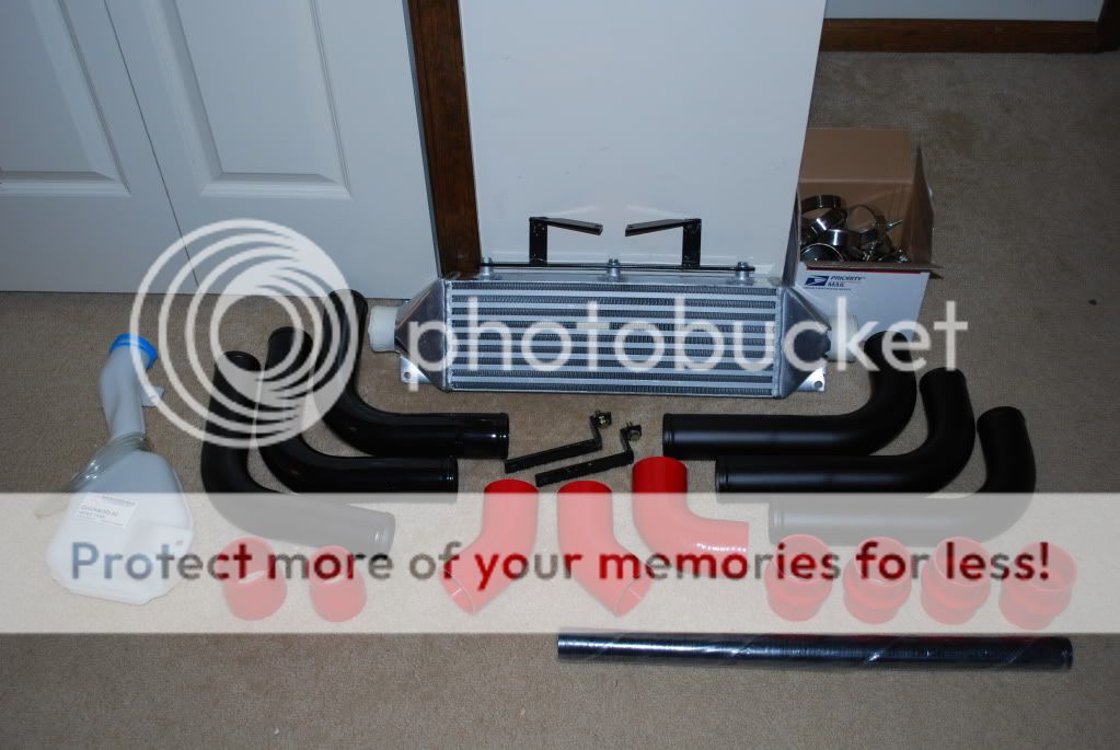

Heres most of the parts I used. Purchased the pipes from cxracing. Intercooler came from here also. Silicone couplers from ebay.
The forge stays!

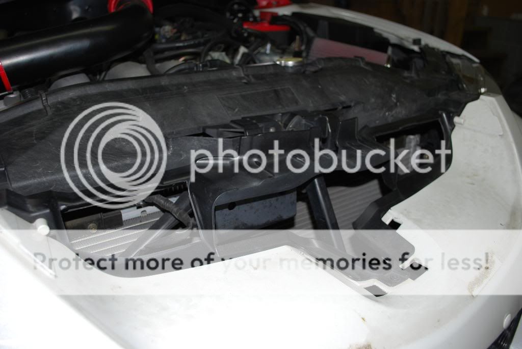

Did some triming on the air diverter. Since the air doesnt need to scoop up anymore. It should be sent to the radiator. :)

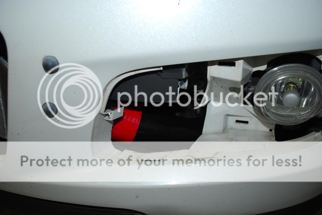

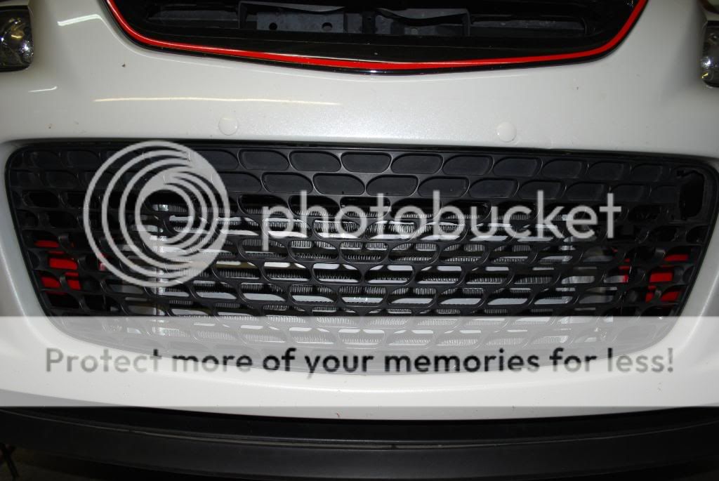

And now for the most time consuming part. Cutting out 2 rows on the grill.
Snapped some shots with the bumper on.

Ok guys. Heres the list of parts. I spent a bit over 500 bucks myself for these parts.
CXracing
-3 (2.5") 90 Degree Pipes
-2 (2.5") 75 Degree Pipes
-1 (2.5") L-Pipe
Ebay
-4 Hump Hose
-1 2"-2.5" Reducer
-1 2.5"-2.75" Reducer
-2 (2.5") 45 Degree Couplers
-1 (2.5") 90 Degree Coupler
-CXracing Intercooler
-92-95 Honda Civic Washer Tank
-(2.5") BOV Flange Pipe
Of course the IC can be purchased from CXracing but its 160 bucks.
All these parts added up without shipping comes out to $450

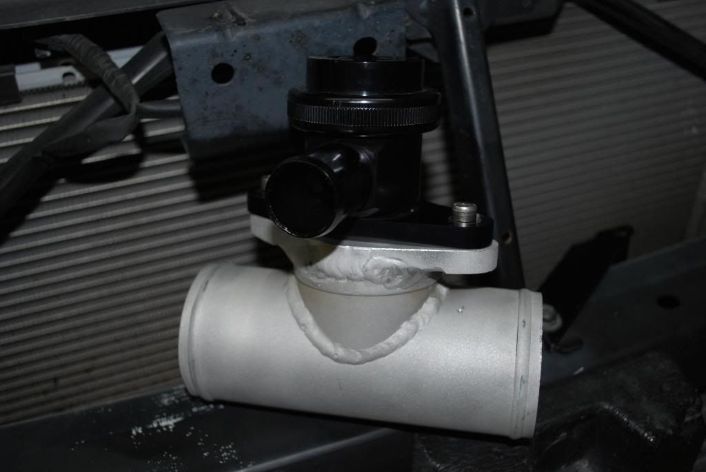

Now I have found there are only 2 options with the bpv flanges. The HKS and Greddy. I used the HKS one. Had it milled down and welded a flange on for the Forge(stock) bpv.

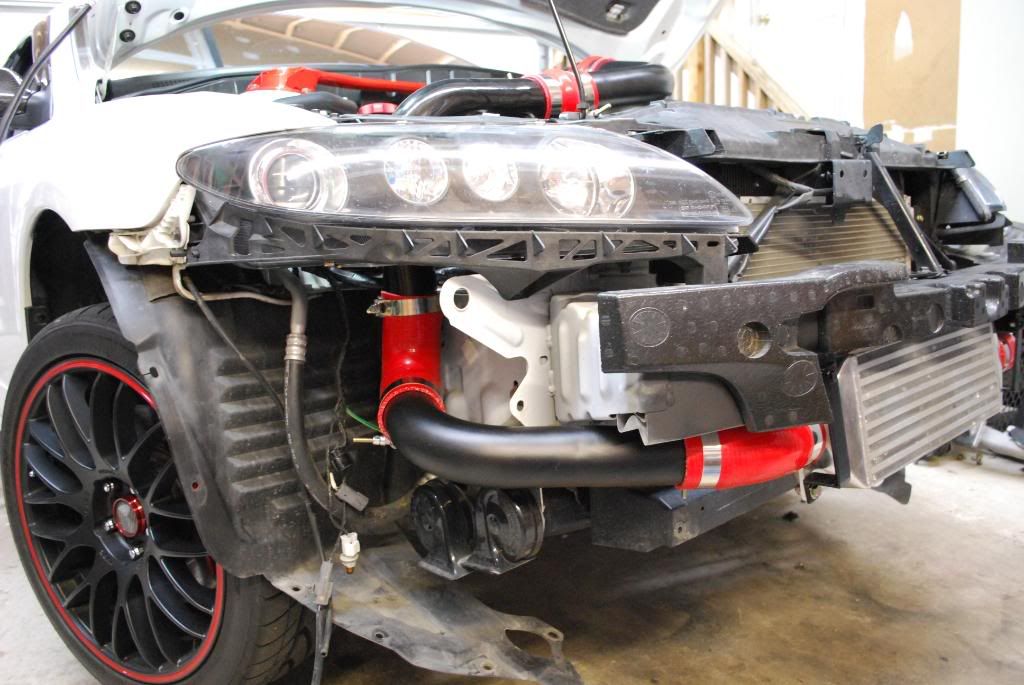

Out of the whole kit only 2 pipes needed to be cut. That was the 75 coming off the hot side of the IC. Cut about 2 inches off going into it. The other one is right where the turbo is. I believe I cut about 2.5-3 inches off the side connected to the turbo.

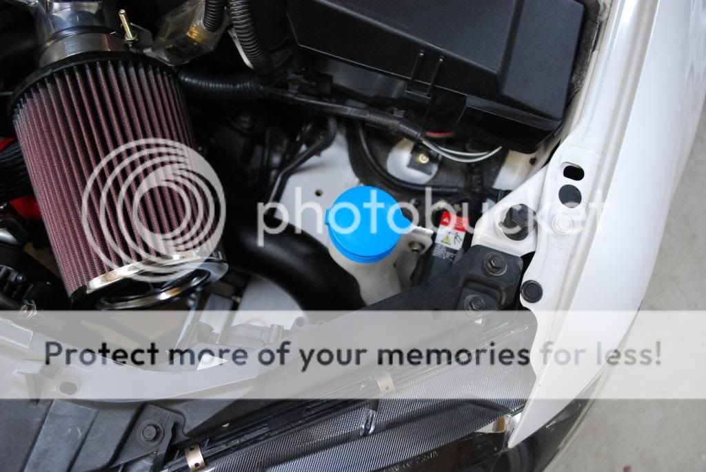

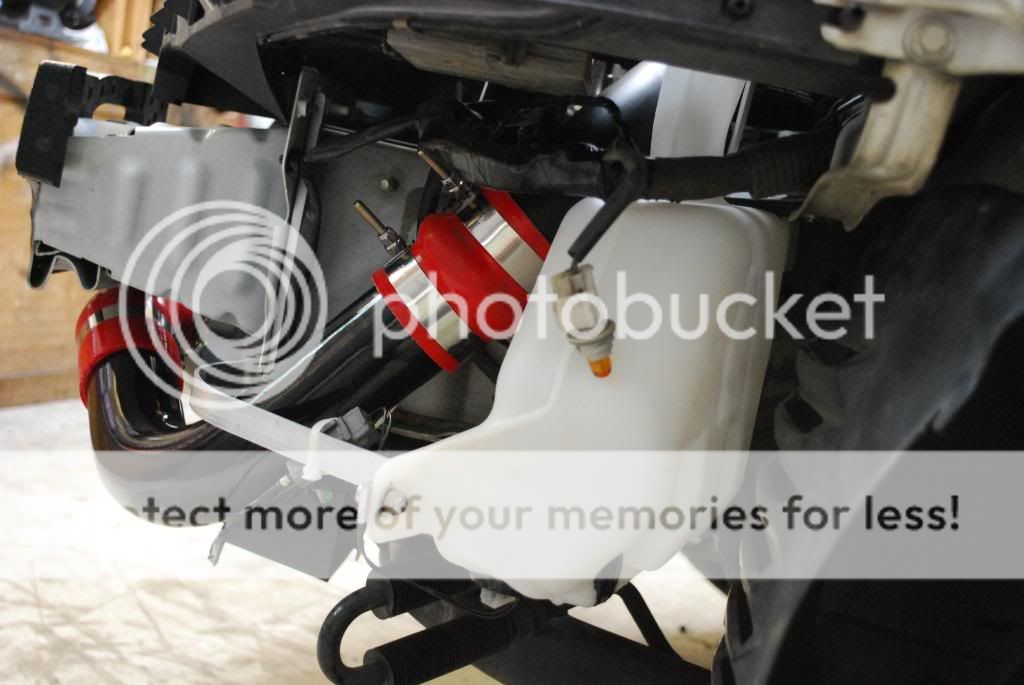

Here are some pics of the washer tank installed.

The jb weld I used on the washer tank to seal the level sensor didnt hold up. Walked out to my car yesterday evening only to find washer fluid leaking from the bumper. Now im all out of fluid. Looks like the bumper has to come back off.
Nice job man, glad to see you put the parts you used in there also I was going to ask about that. I take it a CAI wouldn't work with this setup?
