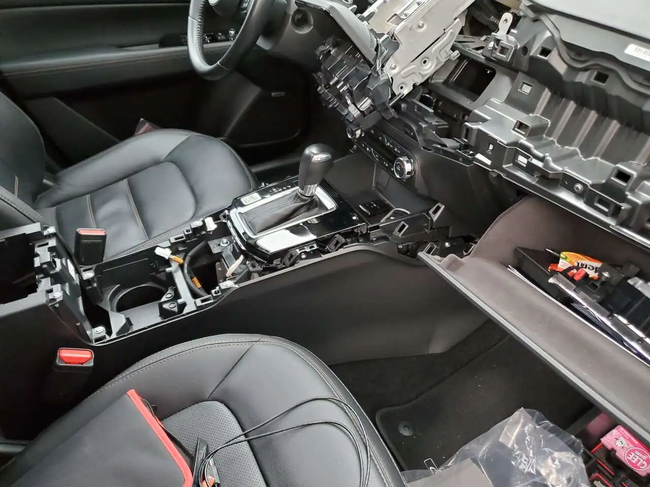

All (2015+?) Mazdas can be retrofitted with AA/ACP if the owner wants it, they just have to buy the kit and install it or have someone install it for them, then update the firmware.
I had an early production 2018 which did not come with AA/ACP, later production did. We were told by the dealer we would get it for a nominal fee. When the time came to get it, the nominal fee was $600 CDN…
The drivability issues were software related and I am now thinking the cracked head may have tricked the mass sensor.
yeah 2018 had some nasty issues with the ecu software. nowadays with the latest updates its great.
The AA/Carplay was expensive at the dealer because they charge for labor and it is a bit intensive to dissassemble and assemble the whole dash and gearbox console.
DIY and the price is only for parts about 170$
