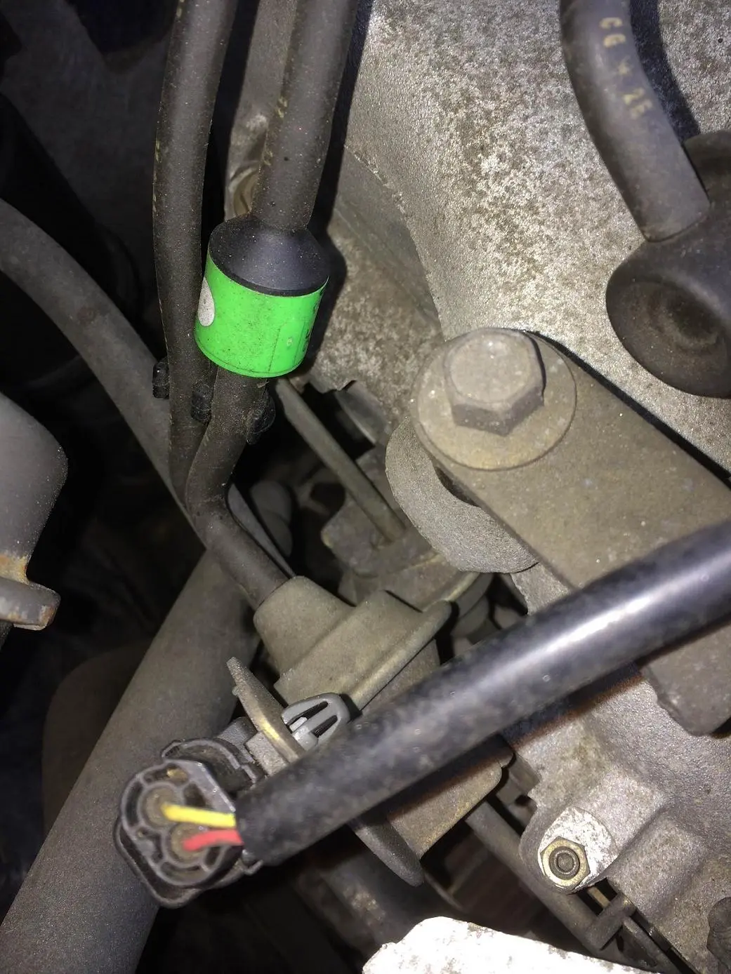

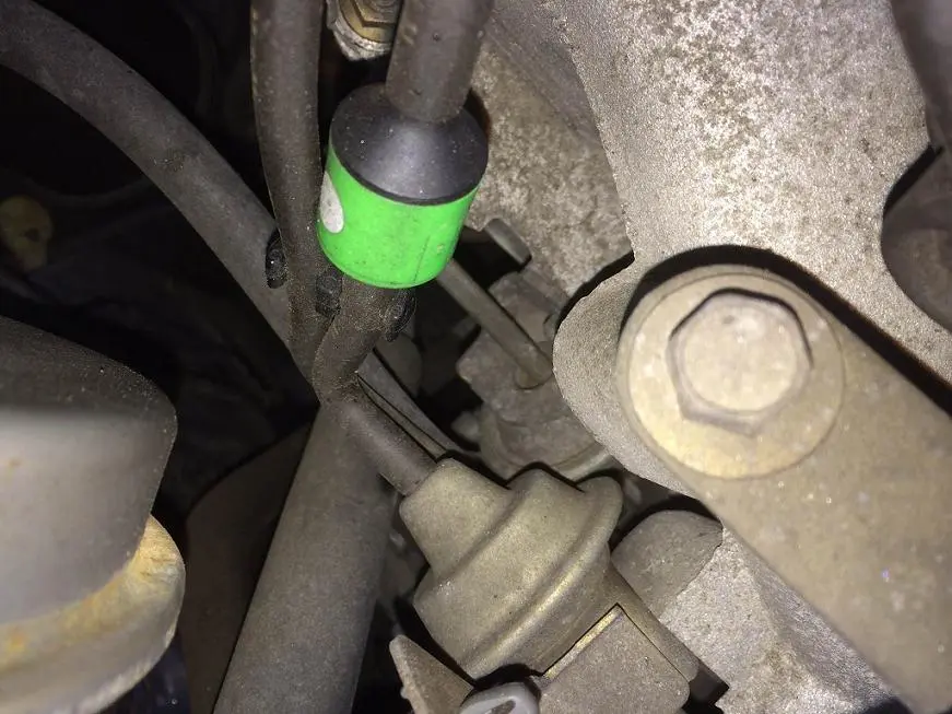

Thanks for the help and info. I went out to my car during my break and took these pictures. I wanted to make sure its the same thing I was looking at on the picture you posted. If I have to replace the whole part is it a pain to do or pretty easy?
Thanks!
Yeah, you took a pic of the VTCS actuator and the green thing near it is just a check valve IIRC. The solenoid is up on top on the intake manifold where the vacuum line runs to from the actuator in your pic. Easy replacement, not sure of cost.

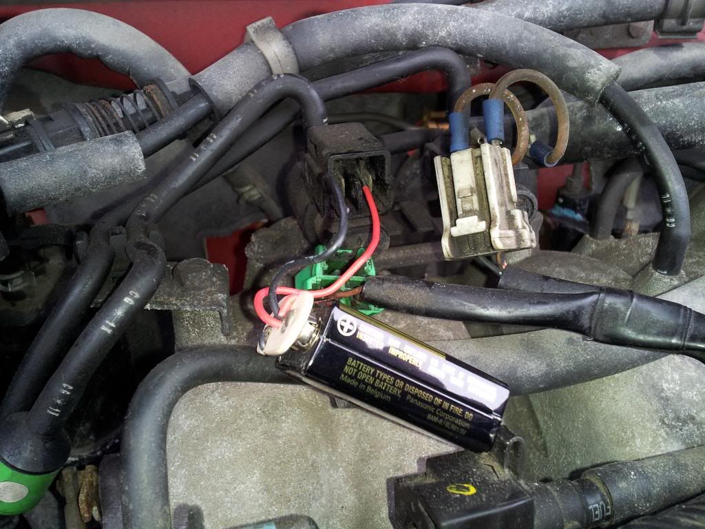

Don't forget to check you wiring,... It could just be a bad connection,..

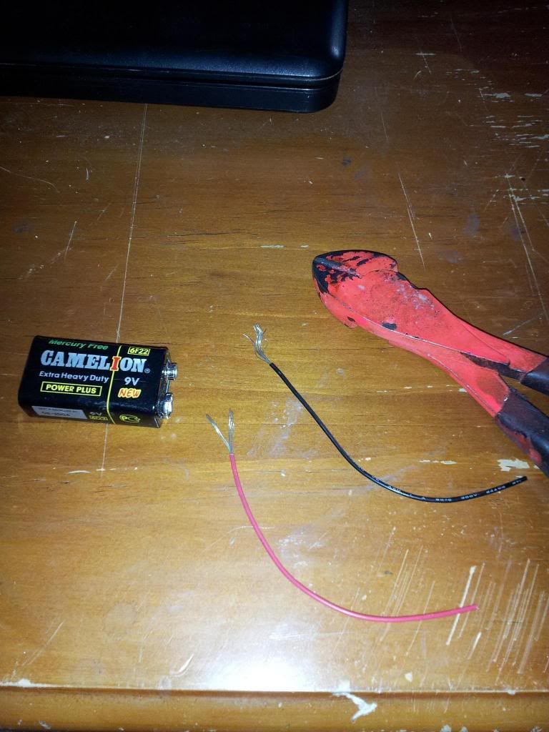

What are you looking for when checking with a battery? And where do you get the wires connected to the battery?

I was troubleshooting the P1569 + P0660 codes my Protege5 was throwing.
I bought a "GOODEAL" solenoid from Amazon to replace the VTCS solenoid and it reads 40ohm resistance across the terminals (same as stock solenoid). Thought it was my wiring or vac tubes, couldnt figure it out ... (bang)
BUT it doesn't click on the 9V battery test (stock one did). I bought a Dorman solenoid from Amazon and it clicks/actuates with 9V connected.
