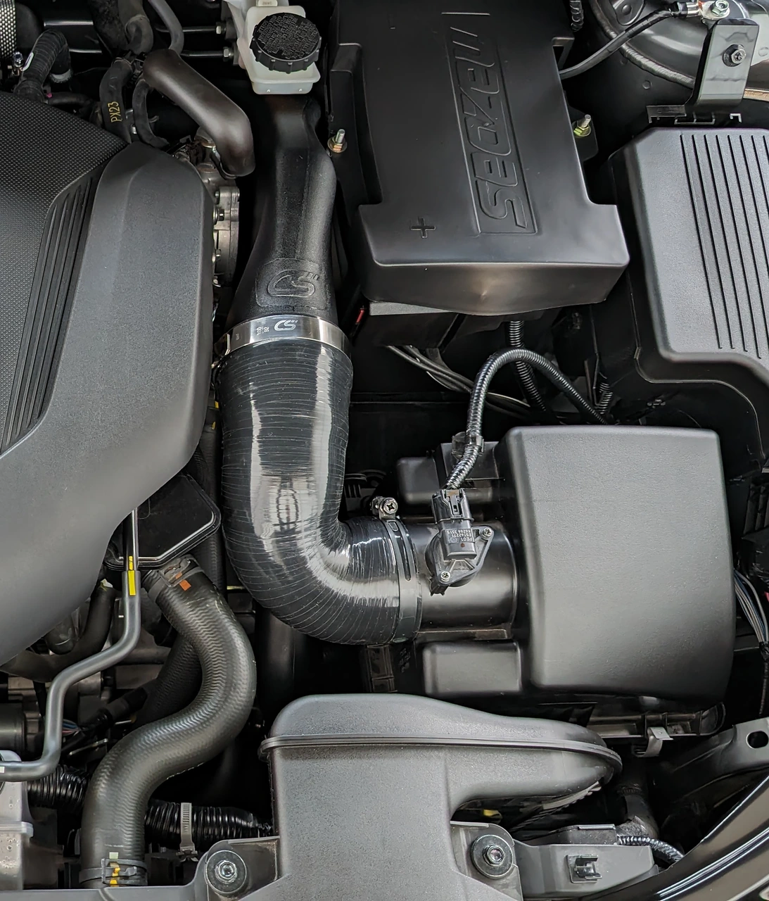

Make sure your grounds are secure.
Example, upper right corner of image:
