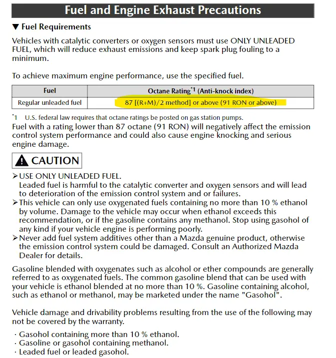

2023 spec. May be its the Ron91 ?
Here's the 2023 spec, which shows 87 is still recommended:
Pardon me but I read it as 2 required fuel octanes to use and not just one recommended. Am I incorrect? Look at your highlighted important information.

I read that as "don't use any additives". They can cause more harm than good. Just buy quality gas and forget about it.
Read the highlighted part again. 87 octane [when measured by R+M/2 method] -OR- 91 Octane [when measured by Ron method].
For more info on these two ways of measuring octane, see: Gasoline explained - octane in depth - U.S. Energy Information Administration (EIA)
