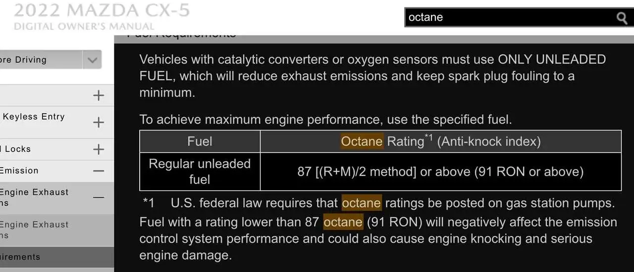

If the owners manual doesn't specifically say you need to run 91, than 87 will be perfectly fine.
The only thing the higher octane rating does is prevent knock and pinging.

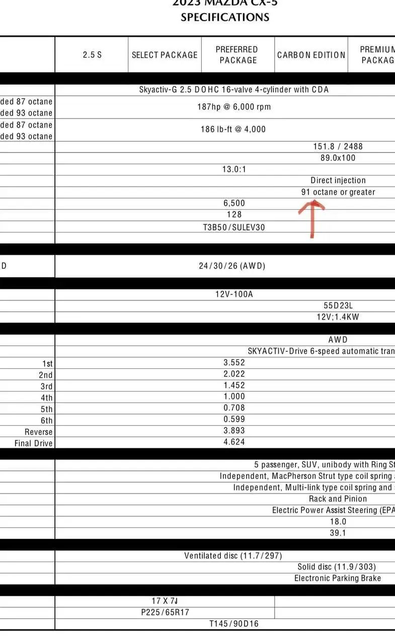

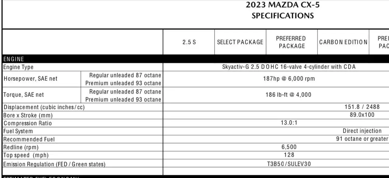

mazda now claims 91 is recommended…
Where is this recommended by Mazda?
UnCorked
Banned
Very interesting how they listed the fuel recommendations. Makes for what could possibly some long debates about really what fuel octane to use. I will personally just stick with 91-93 unless not available where I would be driving.
