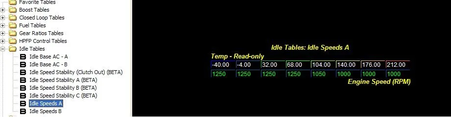

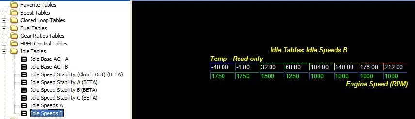

Hey guys, i'm using ATR to change my Idle speed. Below are the tables i have changed (Idle Speeds A and B). is this all i need to change? Do i need to edit the Idle Base AC A and B?
Update: Ok got my answer on the MSF. You need to edit both the Idle Speeds A/B and the Idle Base AC A/B tables to increase your idle speed. I have increase these values to 1000RPM, I'm not smoking at the moment but just had a new K04 turbo installed and i want to run a higher idle as a preventative measure.
there is a help file that comes with ATR, i suggest you read that and all your questions will be answer.
