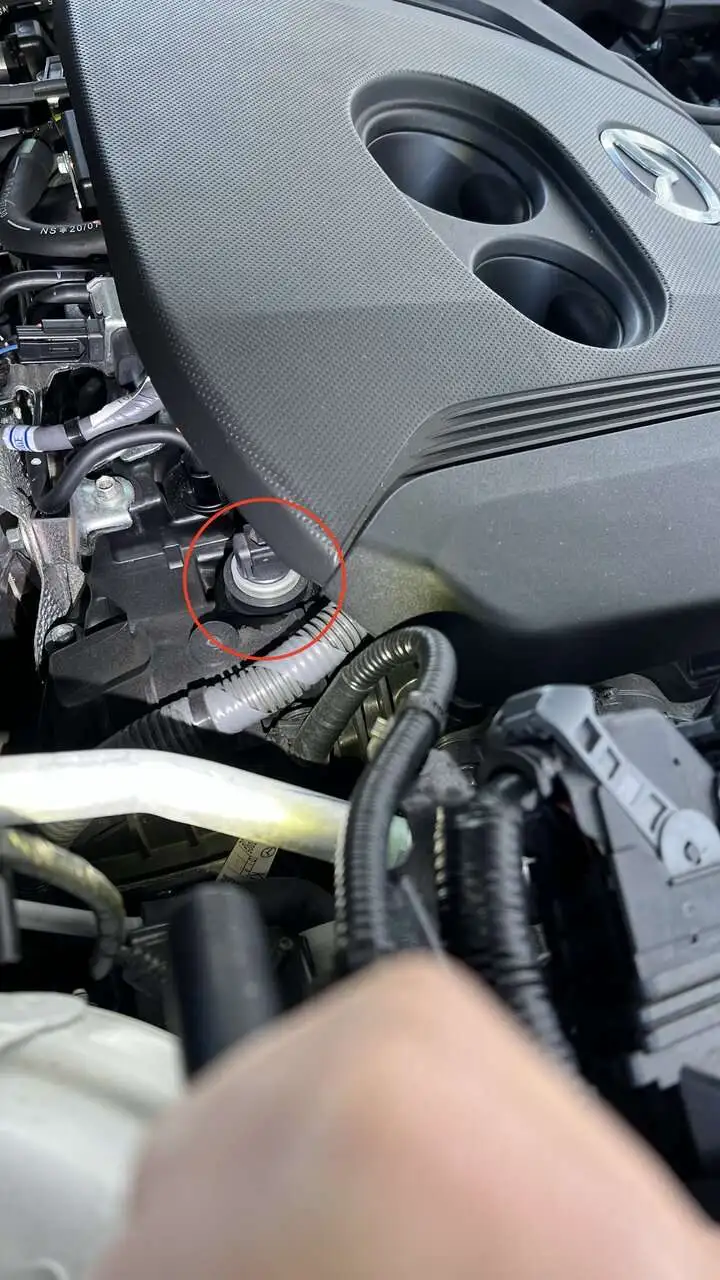

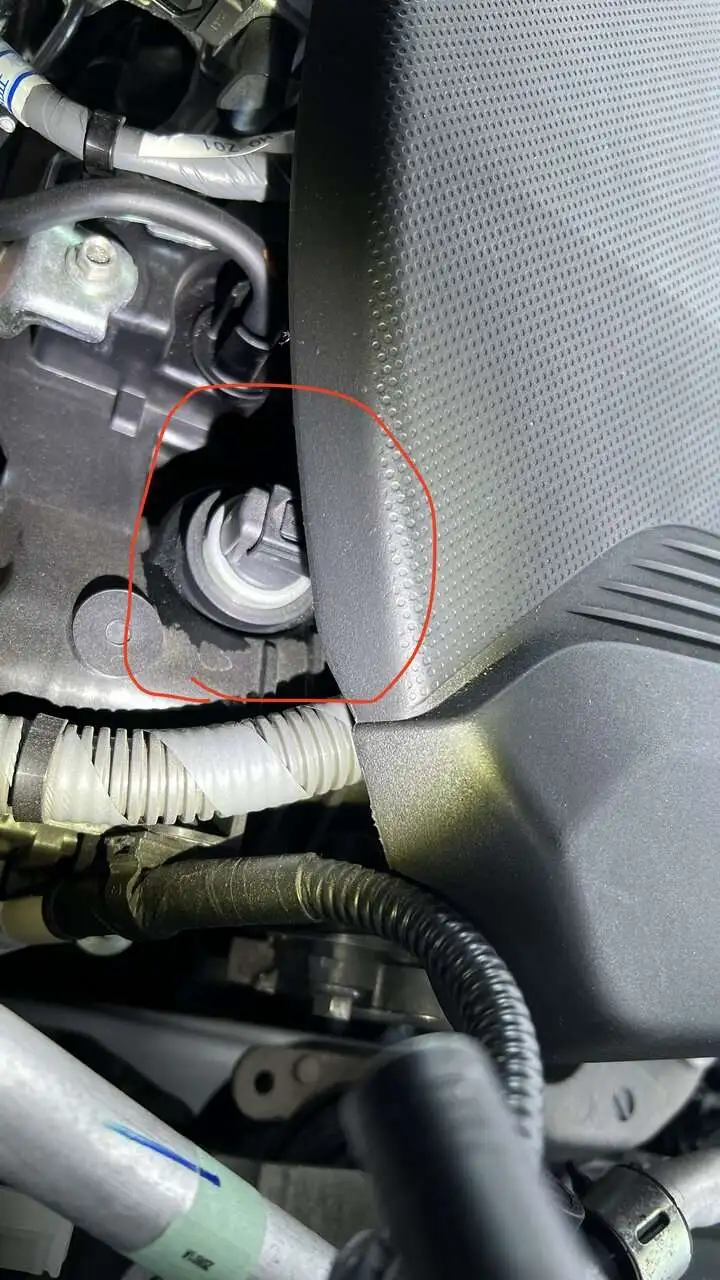

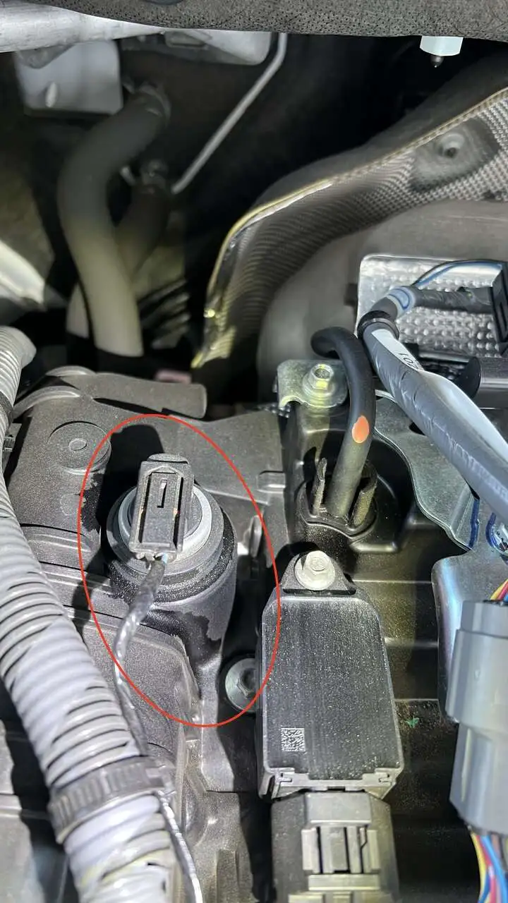

I am going in on 2/20/23 for the pop noise and small oil seepage see photo, and I will try to remember to record sound and take out the SD card (map) now incase lol.

I tried to look for them but when I took the plastic loose those bolts seem tight. Anyways I got my 21 GTR on 6/2021 so should be warranty. I will report back on 2/20/23 my appointment date.
