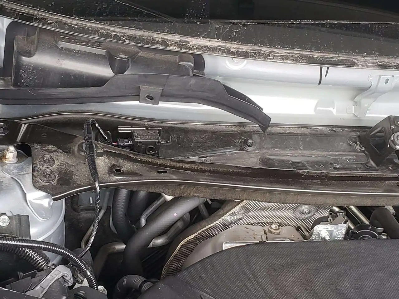

Update: 2/21/23 Picked up my 21 gtr awd and the driver side pop is gone but passenger side is still there 🤦‍♂️. The receipt says: sound was on drivers side but ALL cowl bolts torqued to FACTORY SPECS. I guess it was not torqued to factory specs? Or factory specs is too low thats why its loose again? I didn't remembered hearing it when new. I guess I will tighten up the other side myself according to this photo its only two bolts:

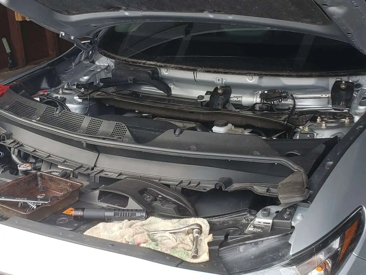

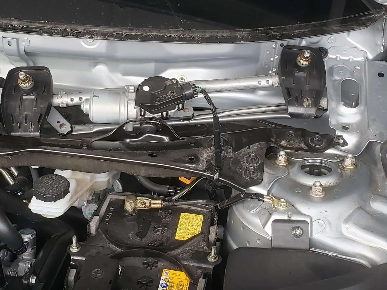

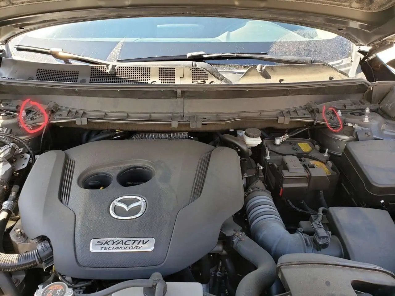

Its actually 4 on each side on the strut tower and 4 under the windshield. You can get to the other two on the strut tower by popping the plastic rivits and using a 12mm box wrench. But to do all 12 you gotta pull the big plastic cover off. Mazda CX-9 CX9 (CX-5) Cowl Bolts TSB Noise Creak Clunk Pop
