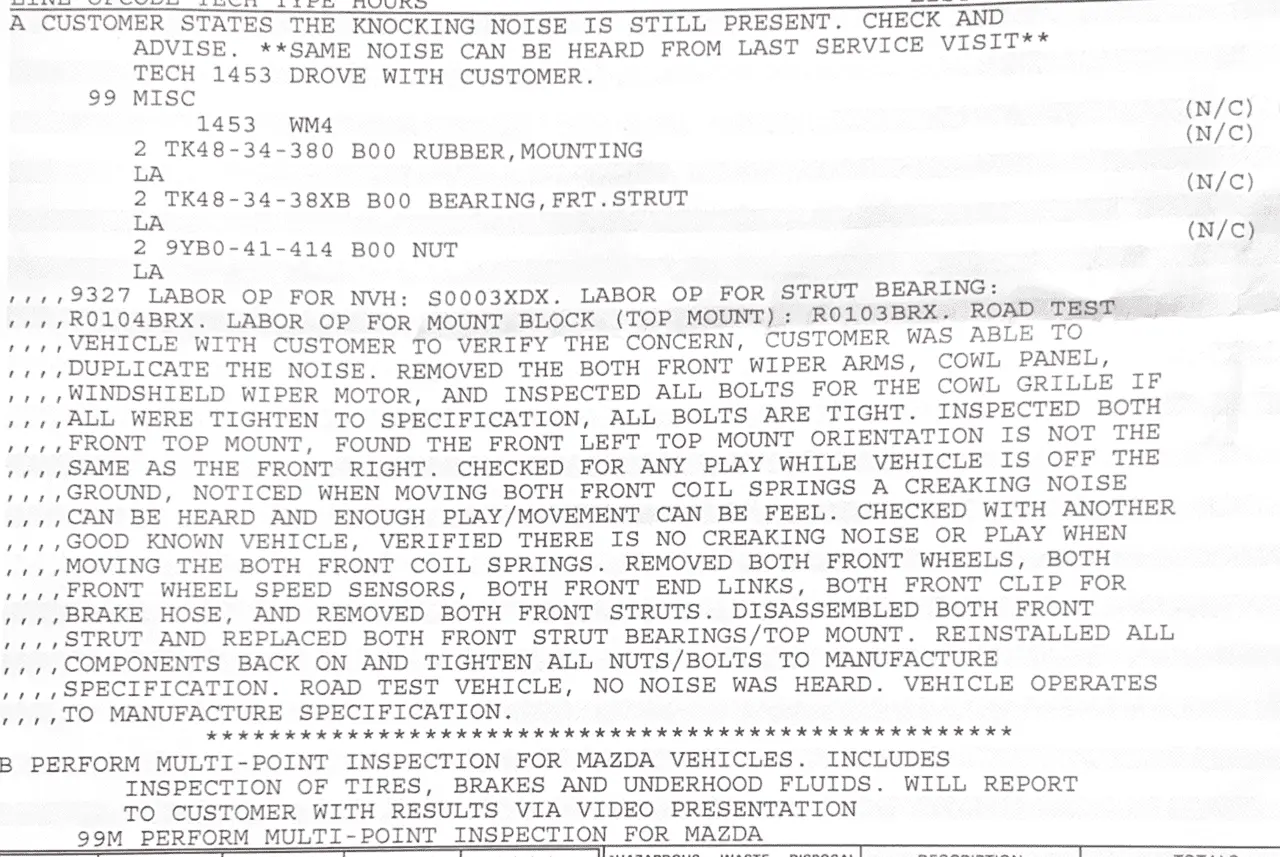

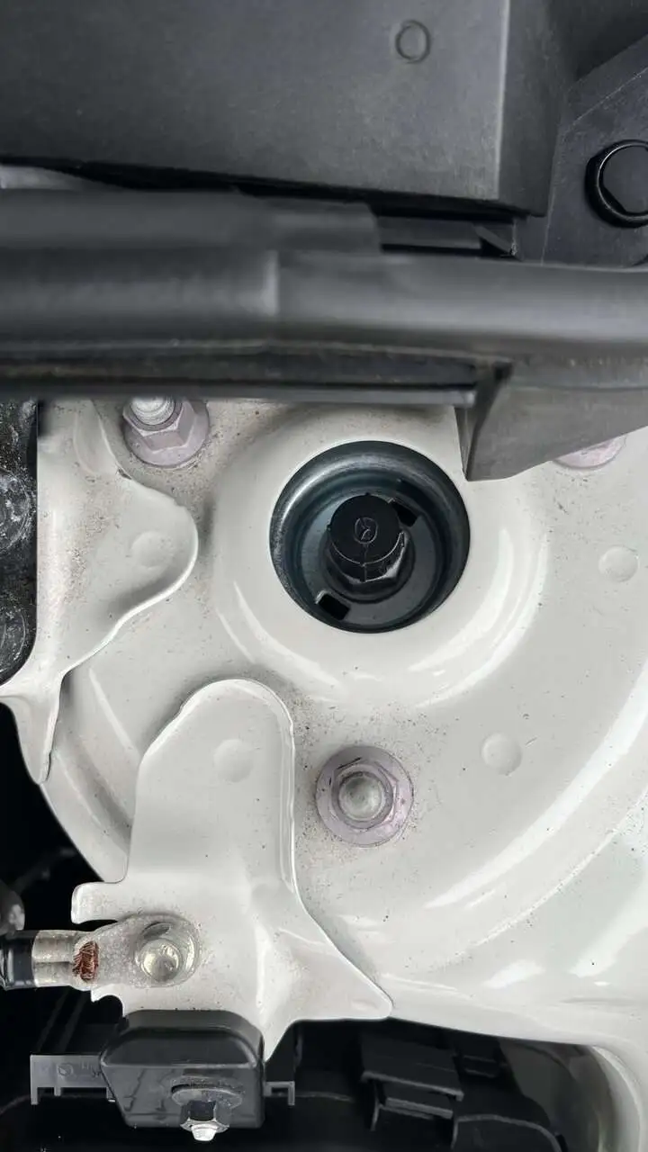

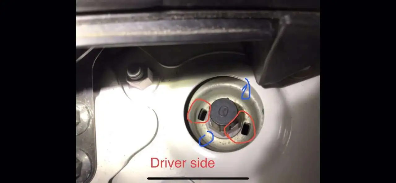

Update on the 4th try from SF Mazda:
Instead of Region Tech an Experience tech/mechanic said he noticed that the orientation on the top strut is different (red circle is current) vs 3 other cx-5 (blue circles).
He verified the noise by placing hand on top and springs then lifting it up the hoist and heard it while driving then concluded it could be the “top mount” and “strut bearing” needs to replaced on both sides.

Update:
After the 4th service on the knock noise guess what..... the noise is still there, same one knock and its gone on both sides. Driving moderate speeds like you normally go (not too slow) on speed bumps, sharp turns, steep driveway or immediately over a hill you hear it.
I think I should just wait until there is another TSB or should I go in for 5th time?? 🤦‍♂️

Here are the service notes:

Man. Thats disappointing. I didnt want to say anything but the orientation of the strut bearing on most vehicles is irrelevant, but good excuse to go in there and replace them. So they replaced both upper strut bearings and rubber bushings.....no help. wow. I was hoping that those items, or a strut replacement was going to fix the creak on my cx9. Sub frame or even a defect in the unibody cant be takin off the table at this point. I would have them replace the struts next. They have acknowledged there is something that needs to be fixed so thats a good thing
The unibody flexing could be the problem. That definitely has crossed my mind.

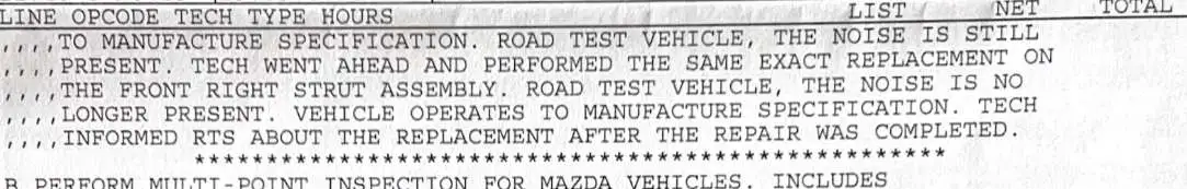

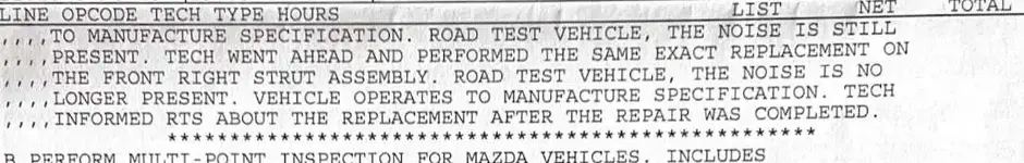

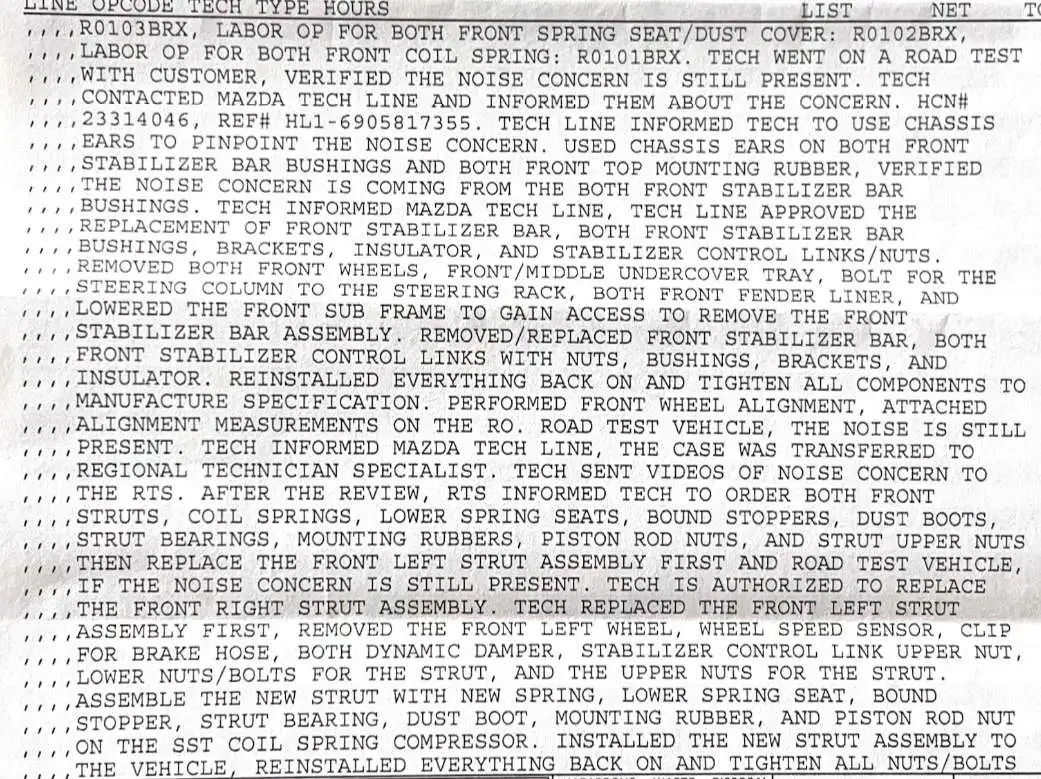

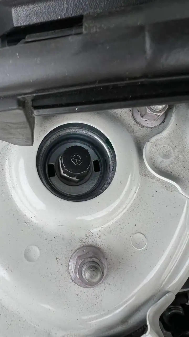

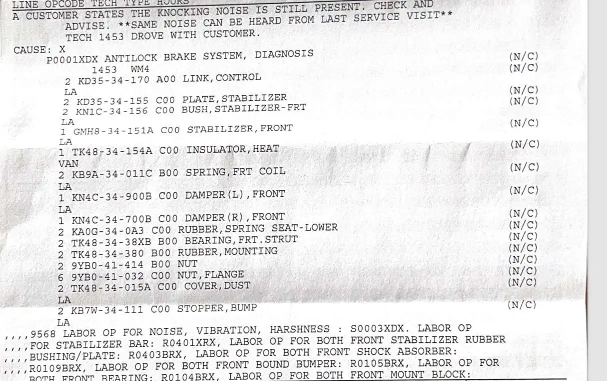

Update noise from both left/right seemed fixed as I only drove it back 5 miles but sound is not there.
Both complete struts replaced. Checkout long receipt.
note on the receipt with part numbers for all front:
- they had initially checked ABS
- replaced control links, stabilizer plate, stabilizer bushings front, satabilizer bar front but noise still existed
- heat insulator boot, front coil spring, front dampers, spring seat lower rubber, strut bearing (again), mounting rubber, nuts, dust cover, bump stop.

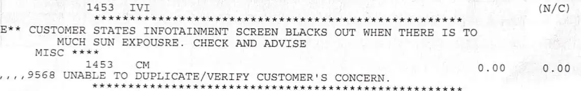

- unrelated infotainment display black out when its hot but ofcourse summer was over so they can replicate lol
Hope anyone can find this info useful.
