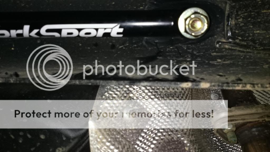

Is that rear sway bar only bolted to the torsion beam in single shear? I haven't seen pics of one installed until now.
Not sure what you mean by single shear. If it is the bolt then yes.they attach to the bar via two holes and torqued to 65ft pounds from memory. It was worth the money and is easy to install.
Here is a heim joint mounted in single shear:
http://i1364.photobucket.com/albums/r740/NwiTACO2/SAC2/P1000135_zpsce0c57c4.jpg
And here is a heim joint mounted in double shear:
http://www.genright.com/images/products/GenRight_TWISTED_HR.jpg
Double shear has the heim captured on both sides to eliminate flex of what is is mounted to which will minimize the likelihood of a fatigue failure... in the torsion beam application it would likely either A) loosen the nut/bolt by stretching the bolt, or B) pull the bolt head through the torsion beam.
I'll concede that I don't have it in front of me to really look at and real world application beats theoretical problems. I'm sure they've used them for quite some time, but it would be a good idea to pull the bar after maybe 10k miles of hard use and see if the bolts are stretched/bent and check the torsion beam to see if it's been compressed under the bolt heads... which since the bolts are harder than the torsion beam, I'd bet is the most likely scenario.
FWIW I'll probably buy it anyway as it's cost effective and like you said it doesn't hang down or hit the muffler.
Also you didn't say, what are your driving impressions after installing the bar?
Sorry i totally forgot. I would recommend the bar, it really improves initial turn in and makes the front of the car seem to dig in more when turning, rotating if you like to call it. Understeer is greatly reduced and the car seems much more chuckable, but found my tyres were the next limiting factor.
I will check to see how the torsion beam is with the bolts like you mentioned in about 3000kms as that is when next service is due.
I did also install a AWR engine mount and thought it was awesome, but soon started to hate it lol. Stop start traffic id just too much with it. I think i will poly fill the standard mount

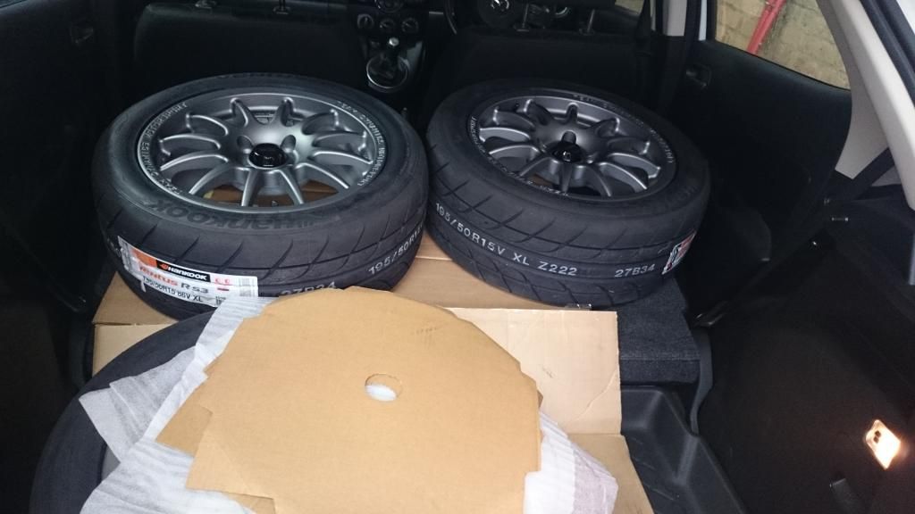

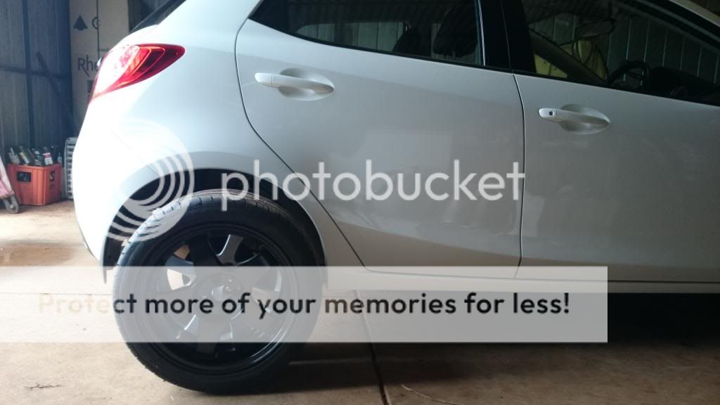

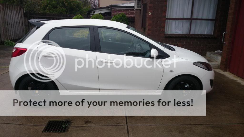

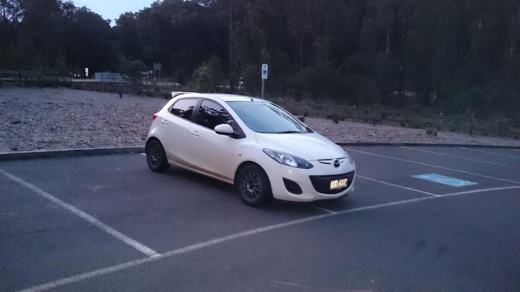

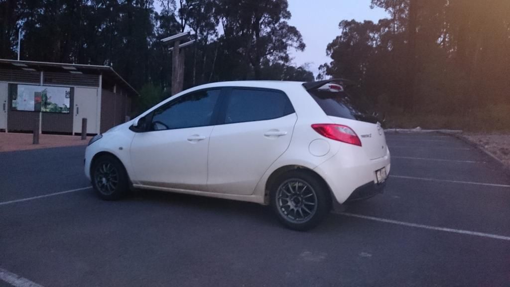

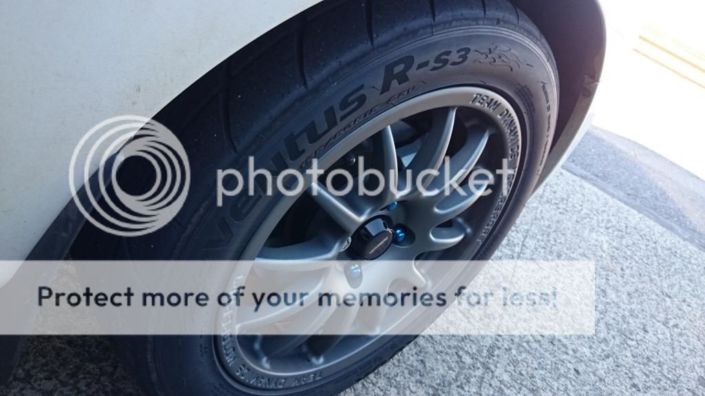

New wheels and tires arrived :) Hankook rs3 195/50/15
The wheels are team dynamics pro race 1.2 15x7 35et
Saving about a kilo and a bit over the old set up

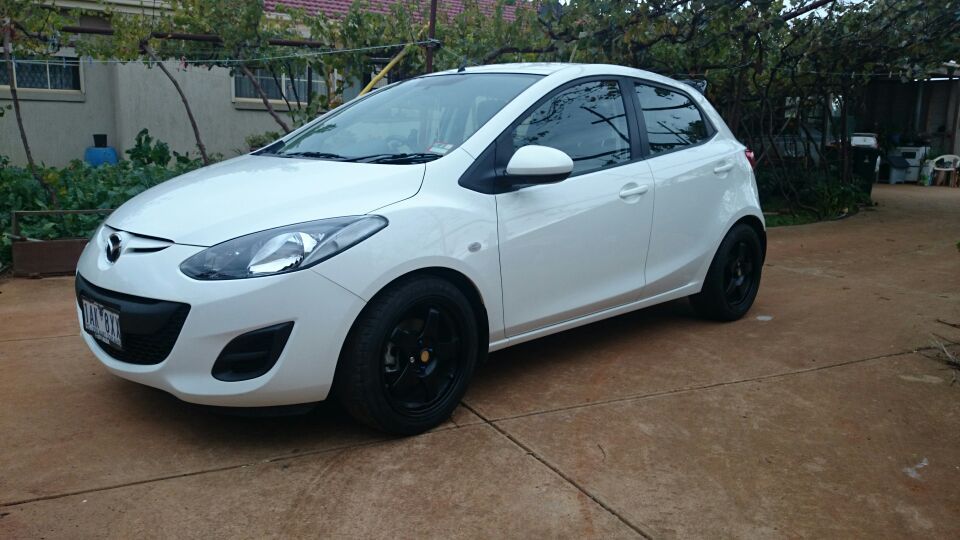

Looks great! I'm definitely a fan of black wheels on these cars (like my own).
The new wheel setup is awesome, with that kind of grip you'll have heaps of fun!
^Thanks guys

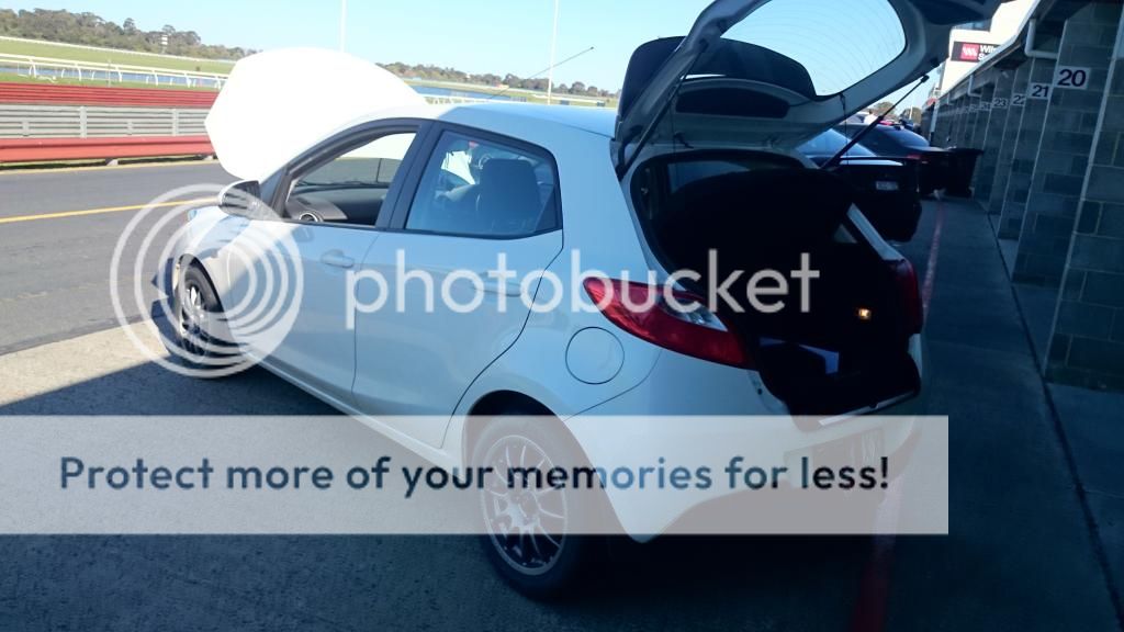

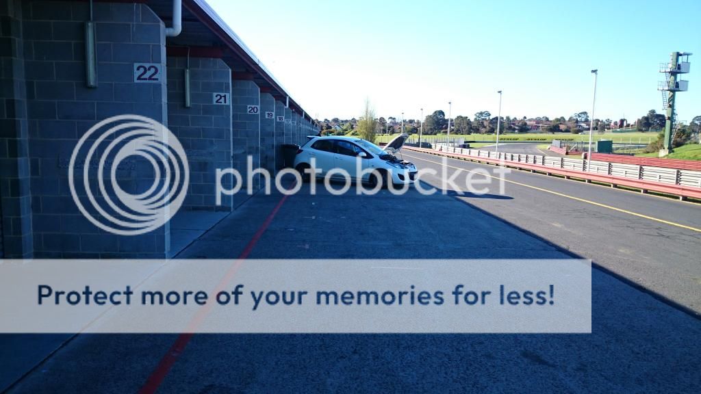

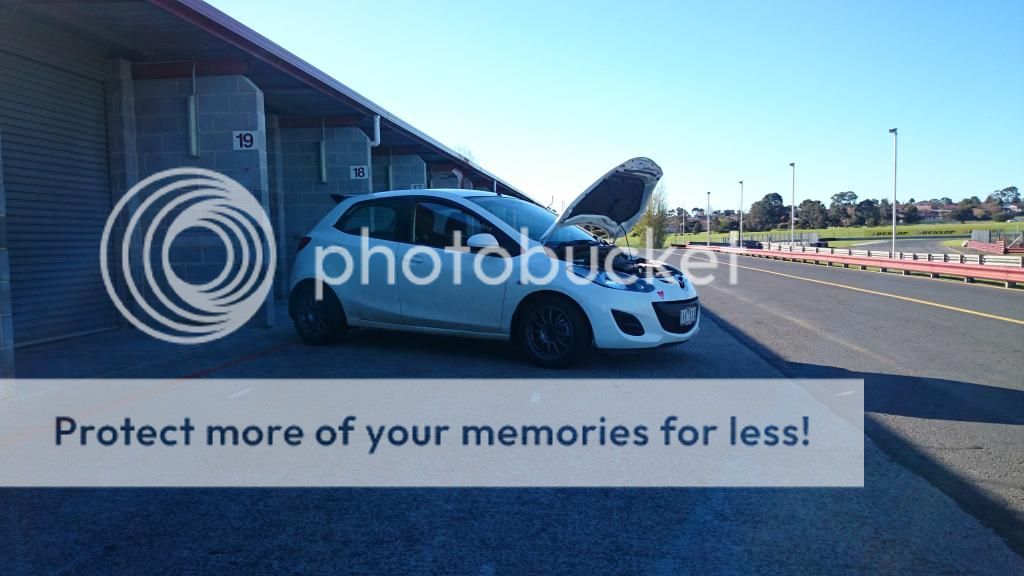

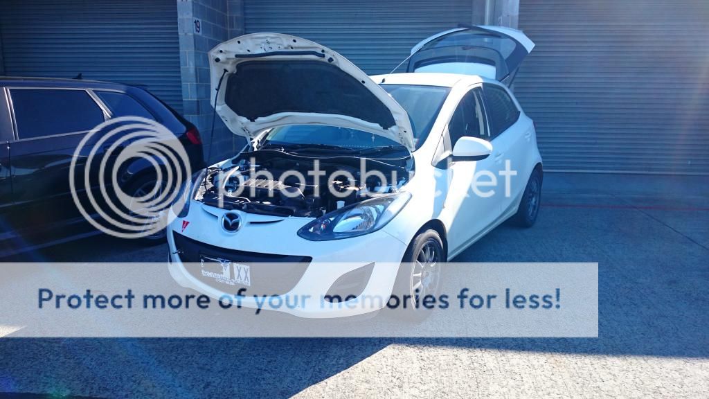

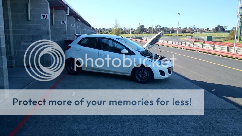

First track day in the car.
Was at Sandown raceway and had many types of cars ranging from track cars to GT3 and boxters and a lot of Renualt megane RS
I tracked the car at full weight as i did not have any tools to bring as i have been away from home with work.

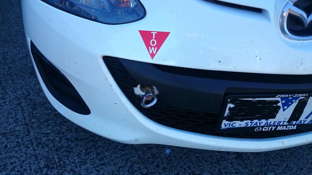

I did however pick up some tow stickers as i thought i was going to end up in the sand at the first corner as it was a big stop and i was running standard pads and fluid. Which i was very worried about but did not get the chance to change.
First session was me taking it easy and quickly found out i was a tad slower down the straight with a VW polo but would close up under brakes and cornering.
Have a video of the session but is 25mins long and quite boring
Second session

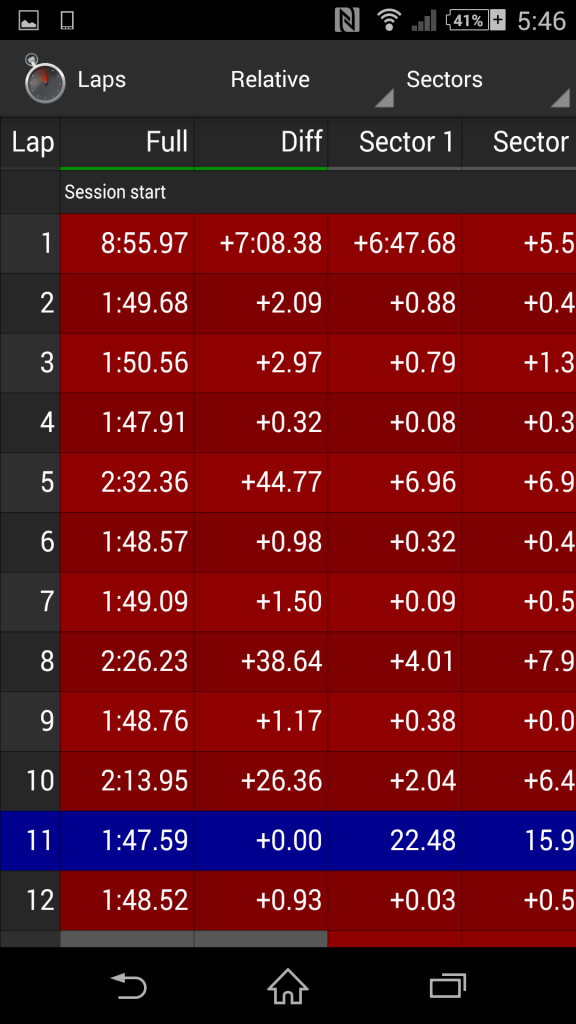

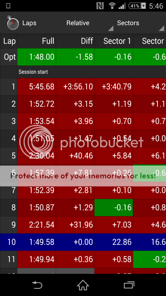

Timed this one with race chrono app
I stayed away from the polo as i wanted to try the tires out some more without worrying about rear ending another person. I was getting more and more confident which was great. TImes as follows PB was a 1.49.6
Third session
This was where i was feeling the groove and started to push a bit more. I quickly got a rhythm going but with lots of traffic I was more concerned with safety rather than all out PB. I did find the limit of the standard shocks and the Eibach springs, through the back straight sweeper bump, the car would almost float through the bump and then land then bounce again. It was a bit unsettling to tell the truth. A friend reckons the springs were fully loaded and the shock hit the bump stops and it caused the s*** my pants feeling i was telling him about.
Got a PB 1.47.59
Reckon could take a second or so off with more bravery in the sweeper but will see how that goes

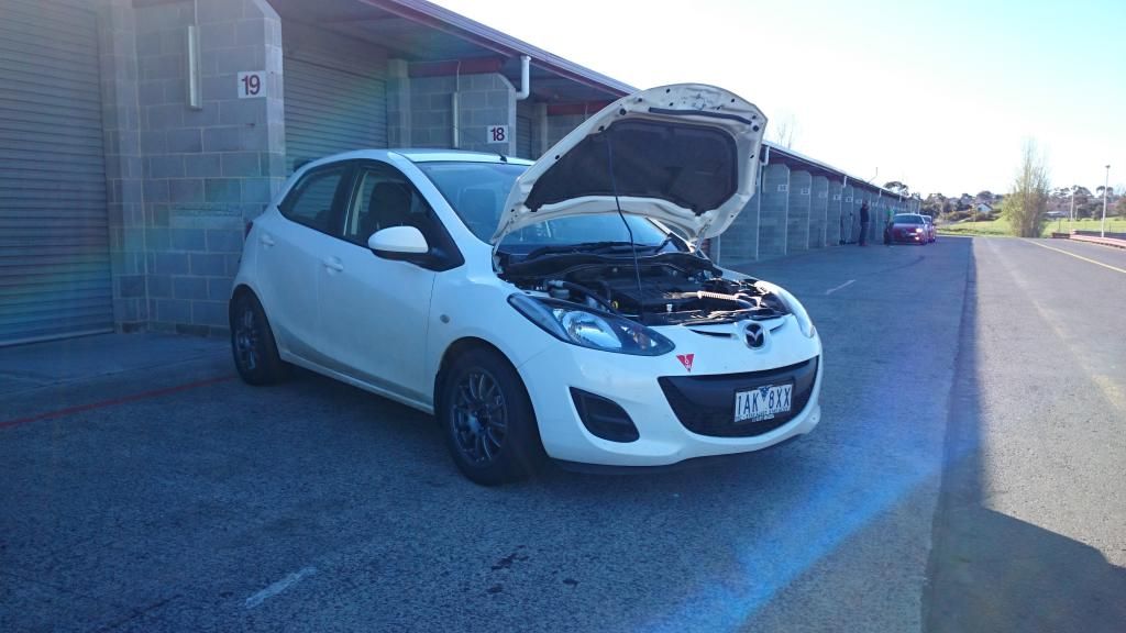

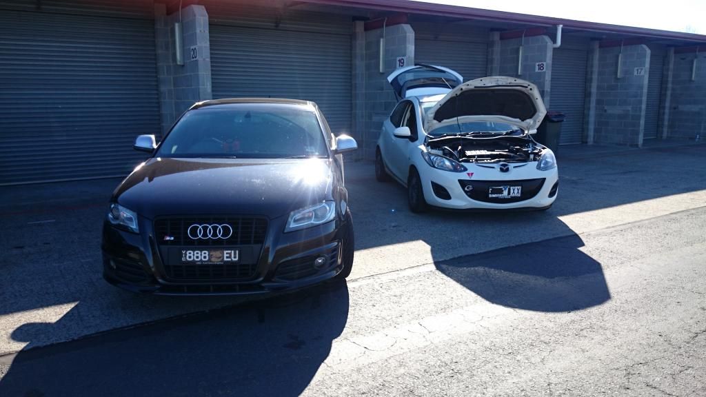

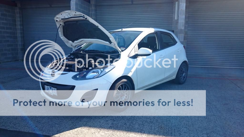

Took some pics after the third session as i was getting tired and did not feel up to running the fourth session. Car was great :) Realised i need more power hahahaha and more weight reduction.
Will also look into getting more camber but am a bit limited in options. Might look into elongated hole on the shock lower bolts or get a top mount modified like a member on here

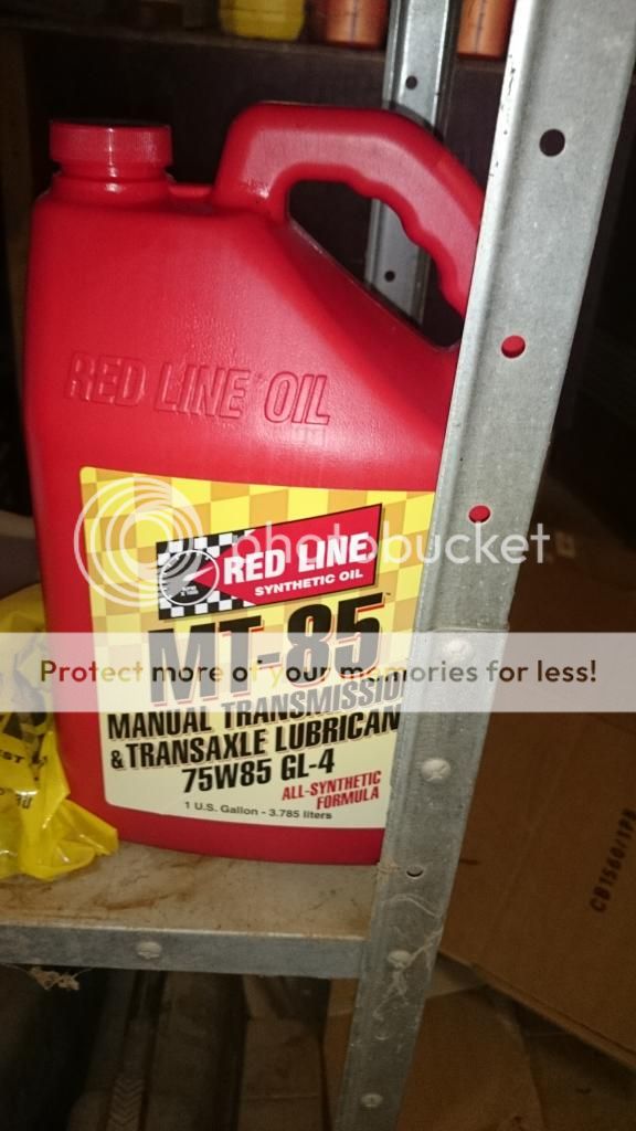

Just been doing small things to the car. I drained the gb oil and put in some new pink stuff. First we jacked up the car level then drained the fluid then lowered the rear again and then used the old hose and funnel technique and just put in the required amount. Shifting has become a bit better but no major improvement really, the fluid that came out was a really yuk brown colour though. I had done 14000kms when we changed it. I also bled the clutch line as after the track day the clutch was very spongue and thought i killed the clucth, after the bleed it was all good.

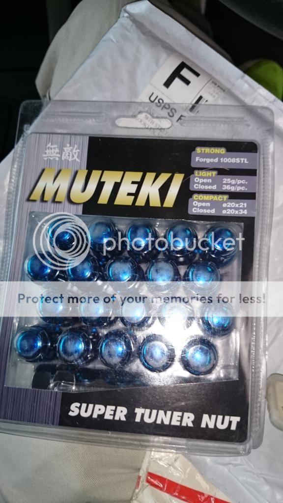

Any way here some pics of stuff i have bought

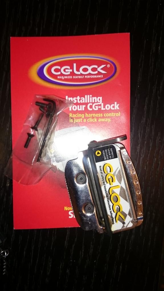

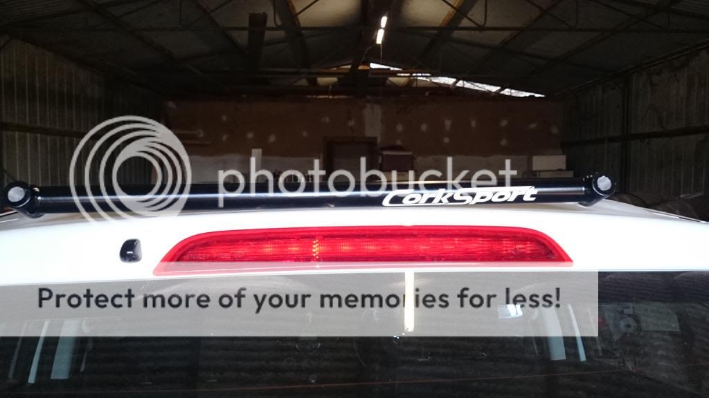

Not sure if anyone has used one of these on here, it basically acts like a lock for the lap sash of the seat belt and holds you in tight.

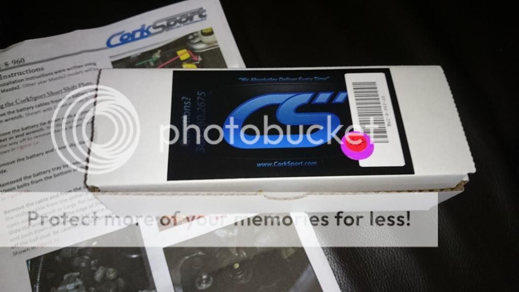

Got a birthday present from m GF from Corksport
Also picked up some CS pads but have not put them in yet as i am waiting for the stock pads to die

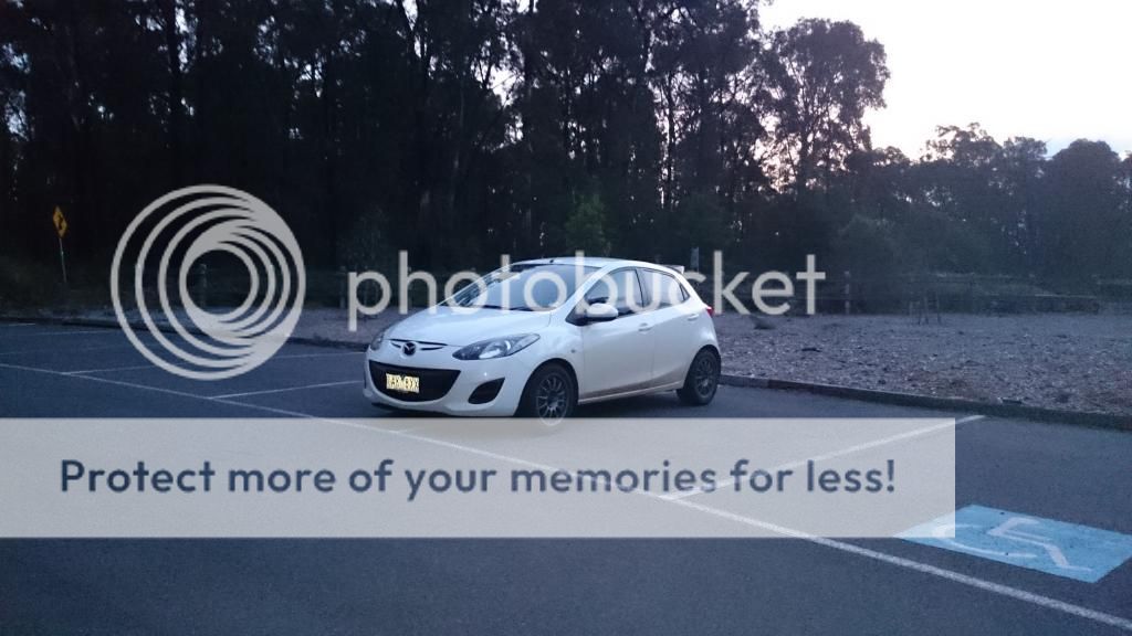

Then went for a small drive to a mountain. It was a really nice day, really enjoyed the car, but going from the RS3 tires to the standard Toyo created a very big lose in confidance. But still did well considering, the tires were very unhappy when i got to the top of the mountain. They stank pretty bad hahaha
