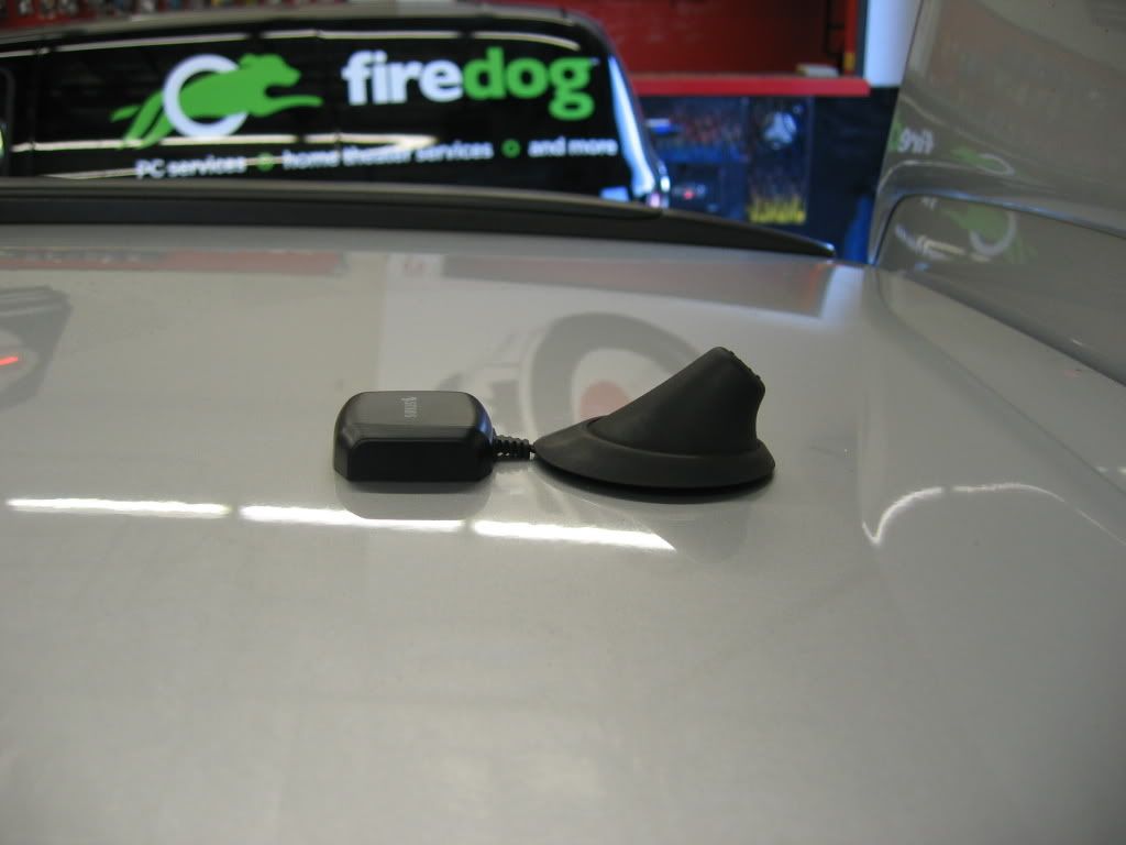

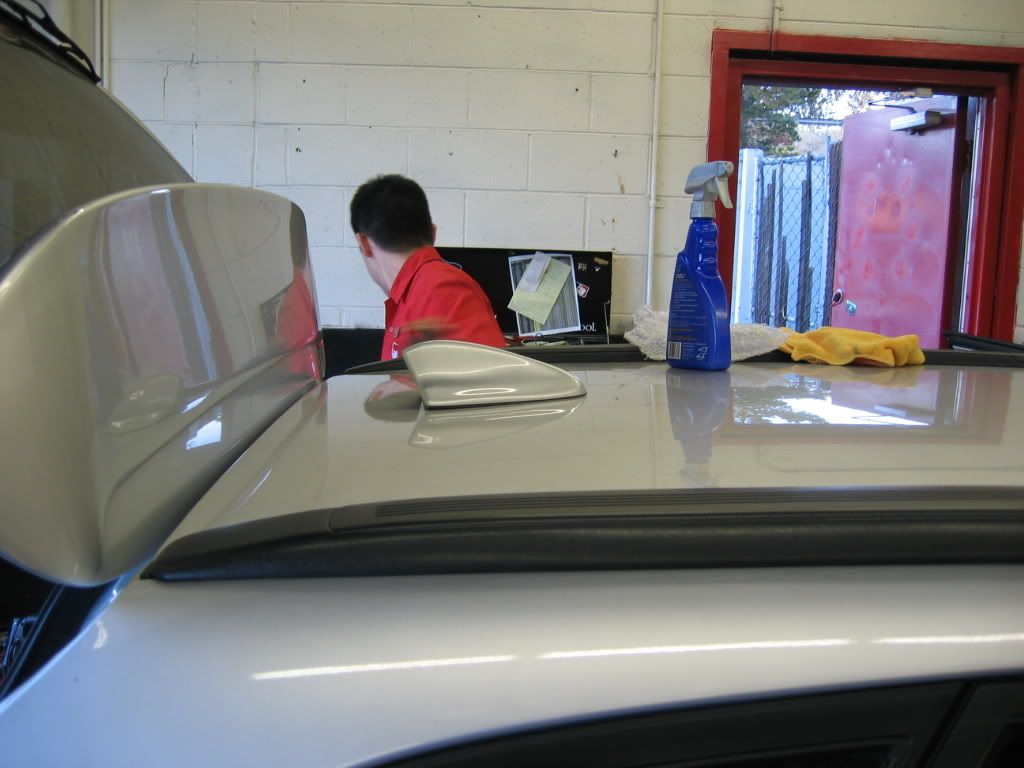

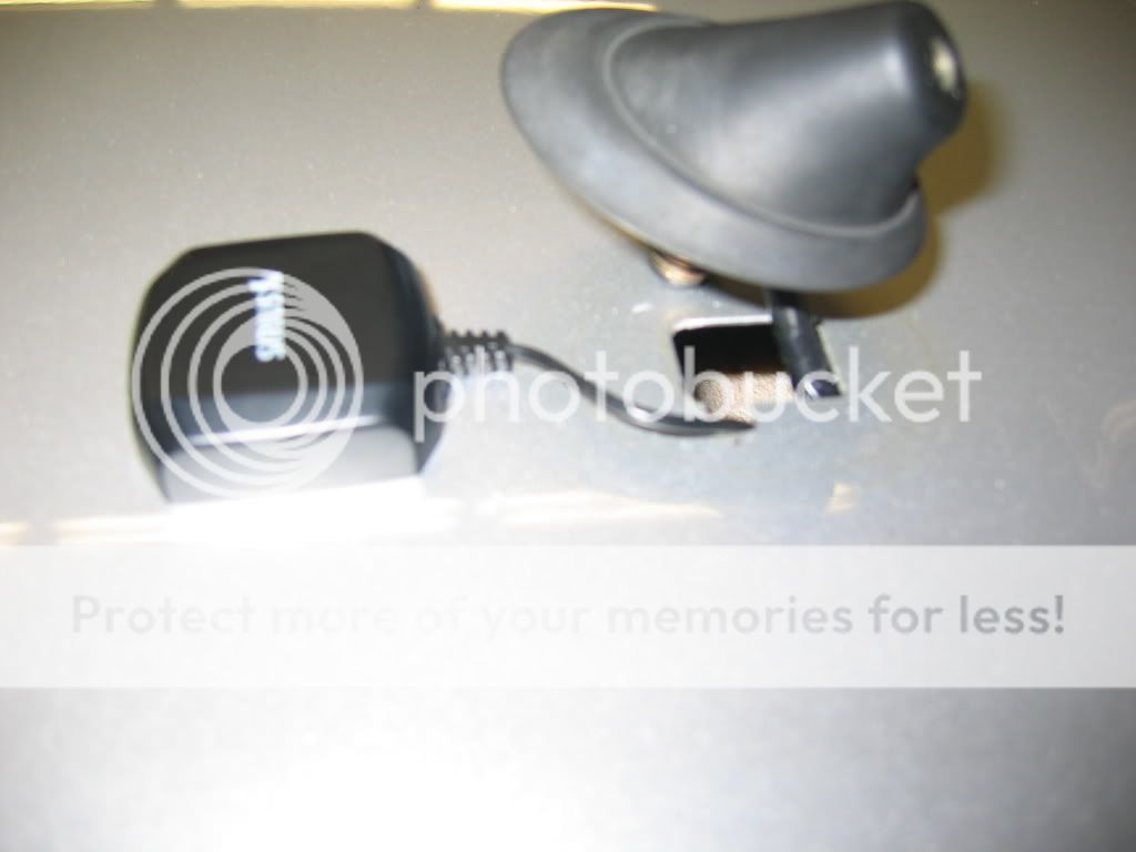

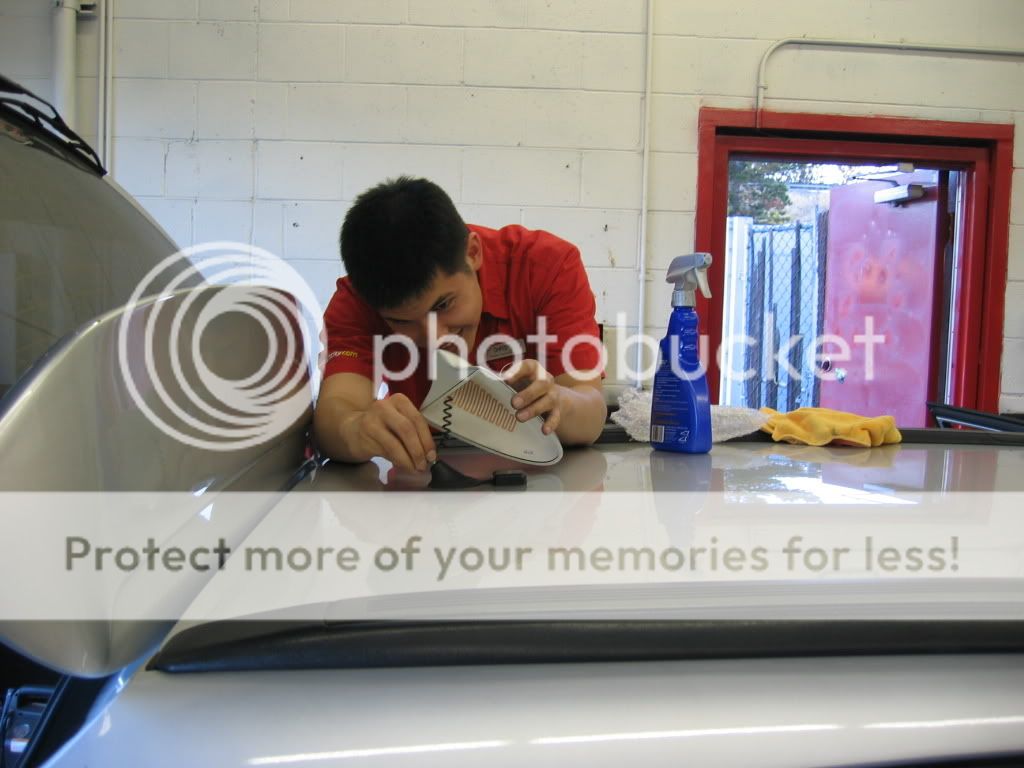

Installed my RPM shark-fin antenna with my sirius antenna under today (idea taken from jhotrod's install thread, THANKS!)
Cut out very small part of roof for sirius antenna to fit past AM/FM antenna (very scary)
Tightened back down AM/FM base
Pulling car out with Shark-fin placed over antenna to ensure reception
Sticking down Shark-fin (you can see the fractal AM/FM antenna on the inside of the shark-fin)
Success!
Making this my signature shot (cabpatch). Cleaning up the antenna wiring.

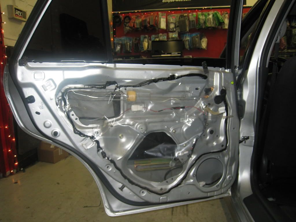

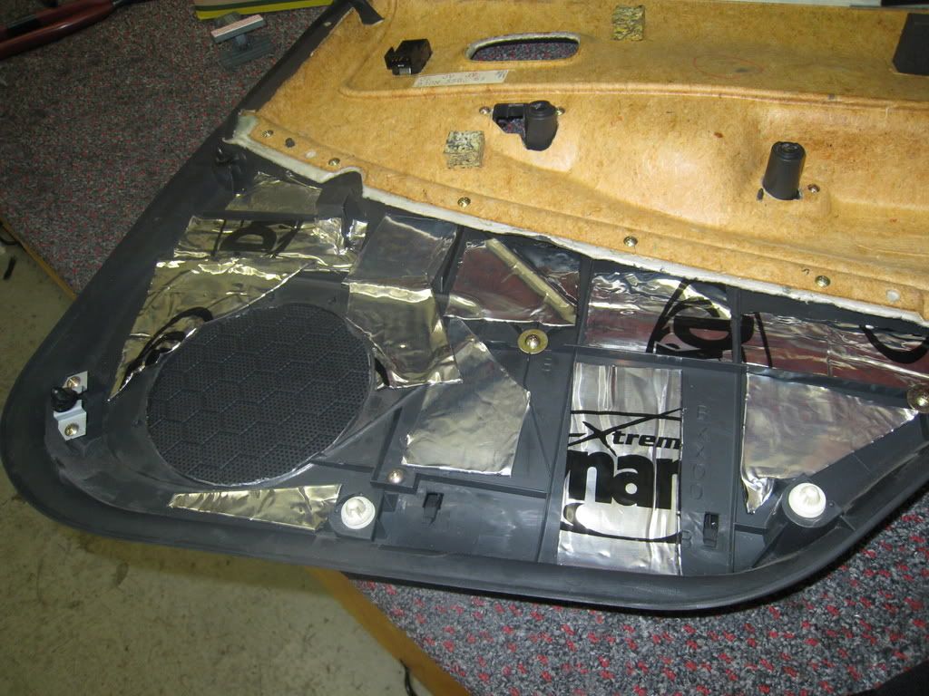

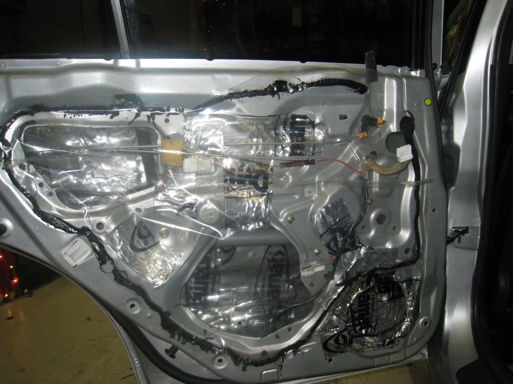

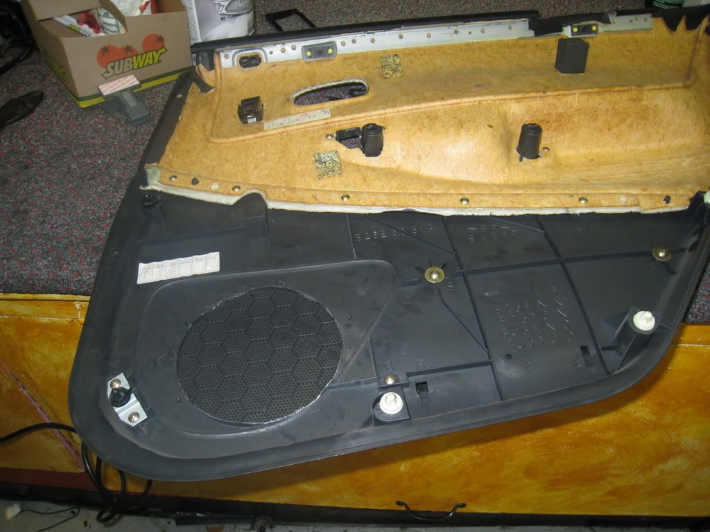

Received my Dynamat bulk pack and Polk speakers this past week. Got a chance to hit up one rear door panel after work.
Ahh virgin door panel
Got her all dynamat-ed up

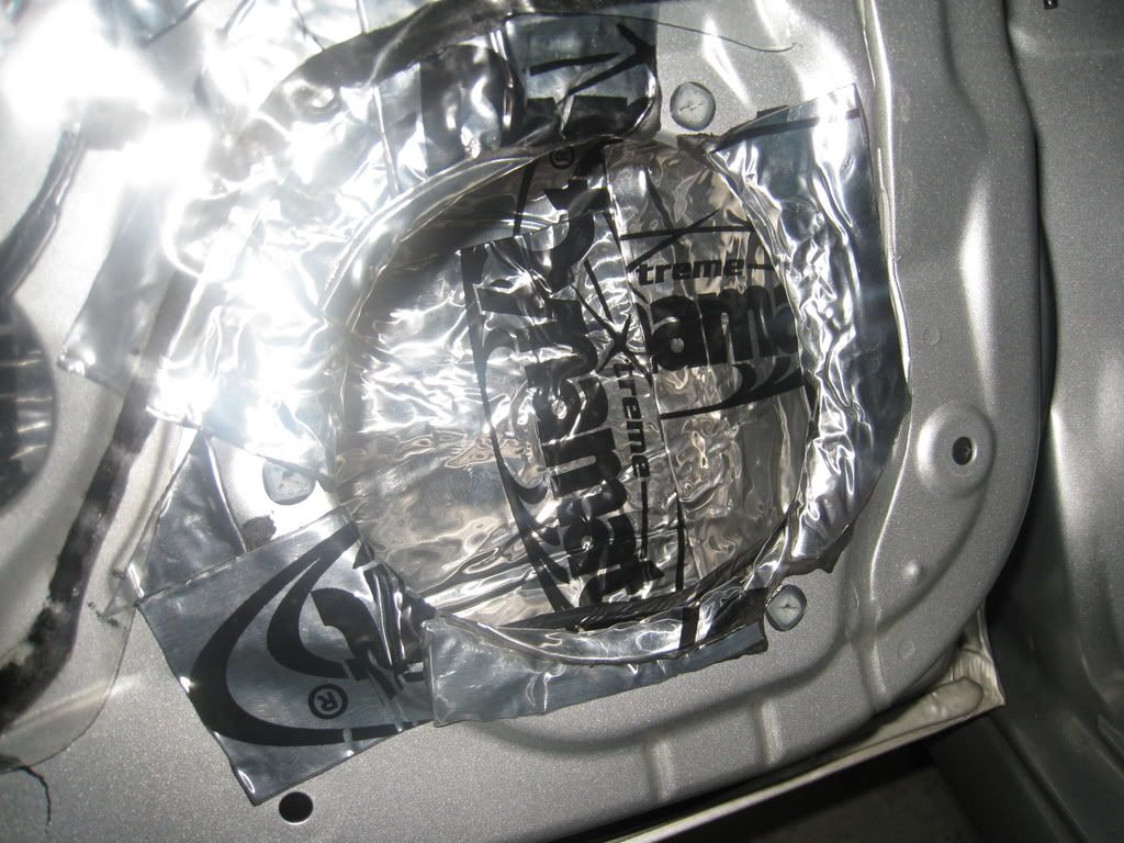

Close up of speaker hole

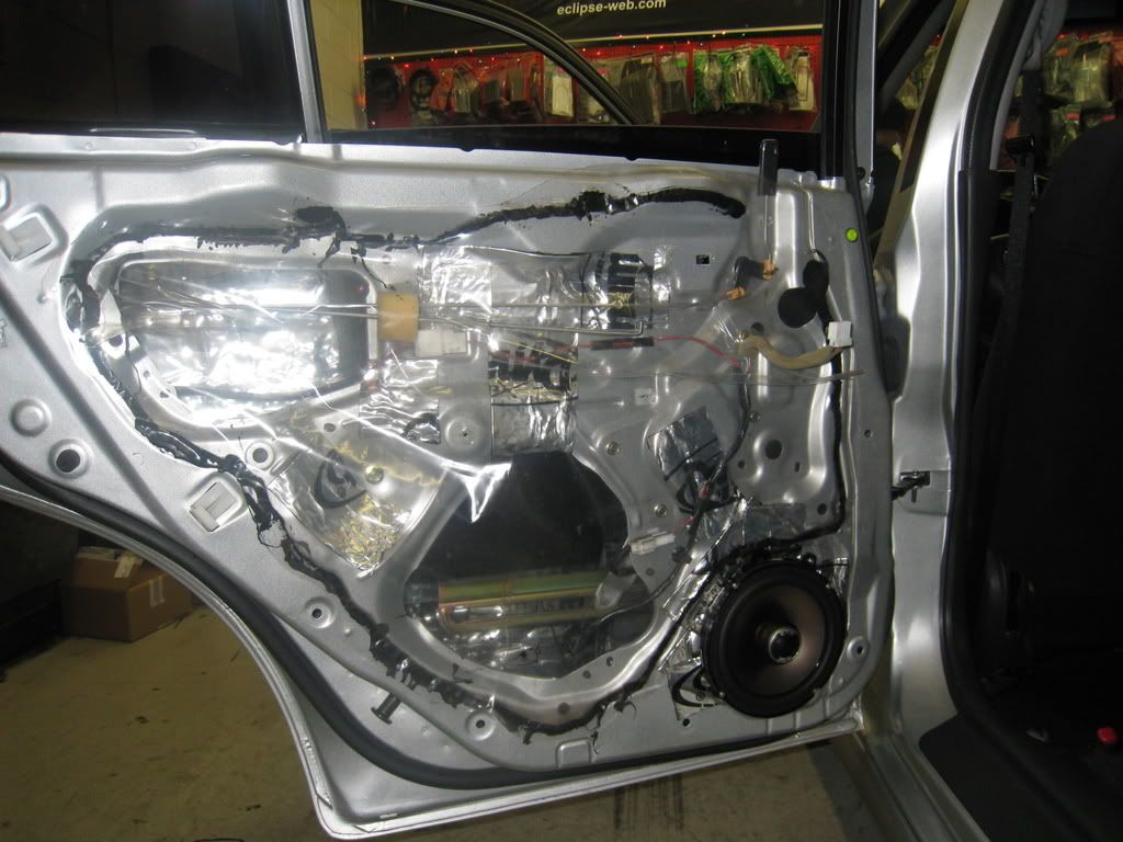

Speaker in (Polk Audio DB651 run off of HU for rear fill)
Cleaned up the door panel (Had to take off the lip around the speaker grill for clearance)
Got some dynamat on the door panel too
I used about 2 sheets from the bulk pack on this door. Will do the same with the other door tomorrow, then start on the hatch area.
Got the other door done in the same fashion the other day and the hatch today. The hatch was a PITA because I broke a couple of the tabs. I forgot my camera, and do NOT want to pop that panel off again lol.

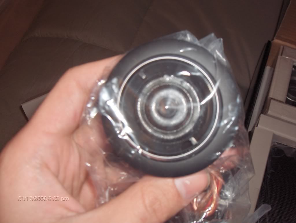

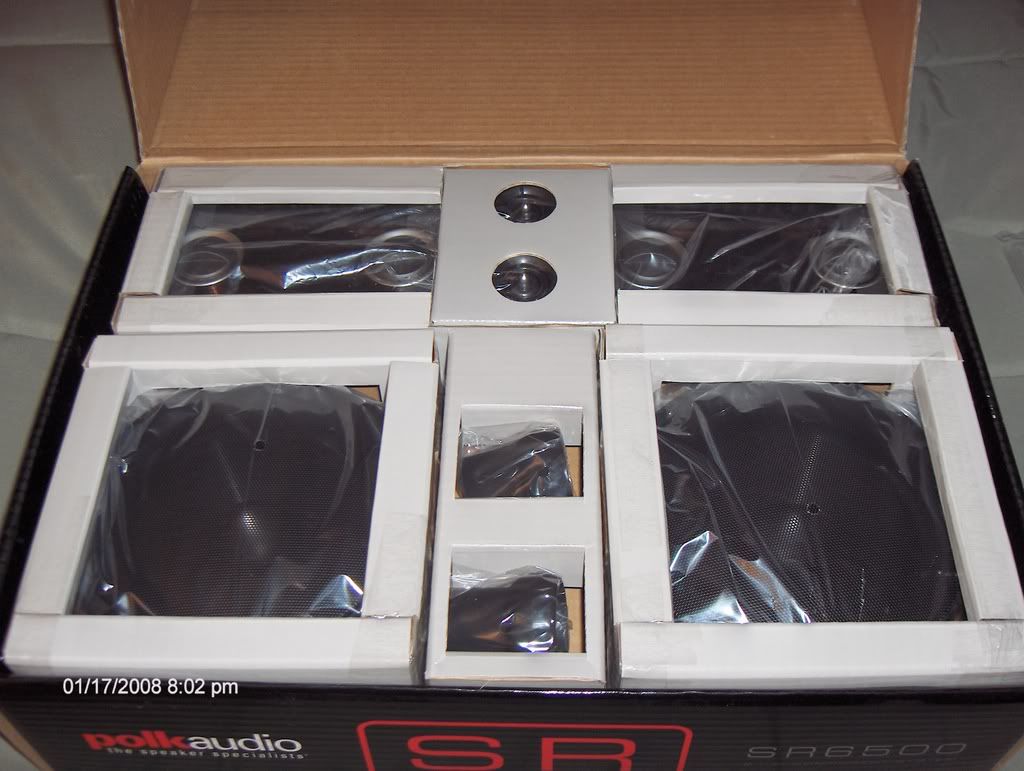

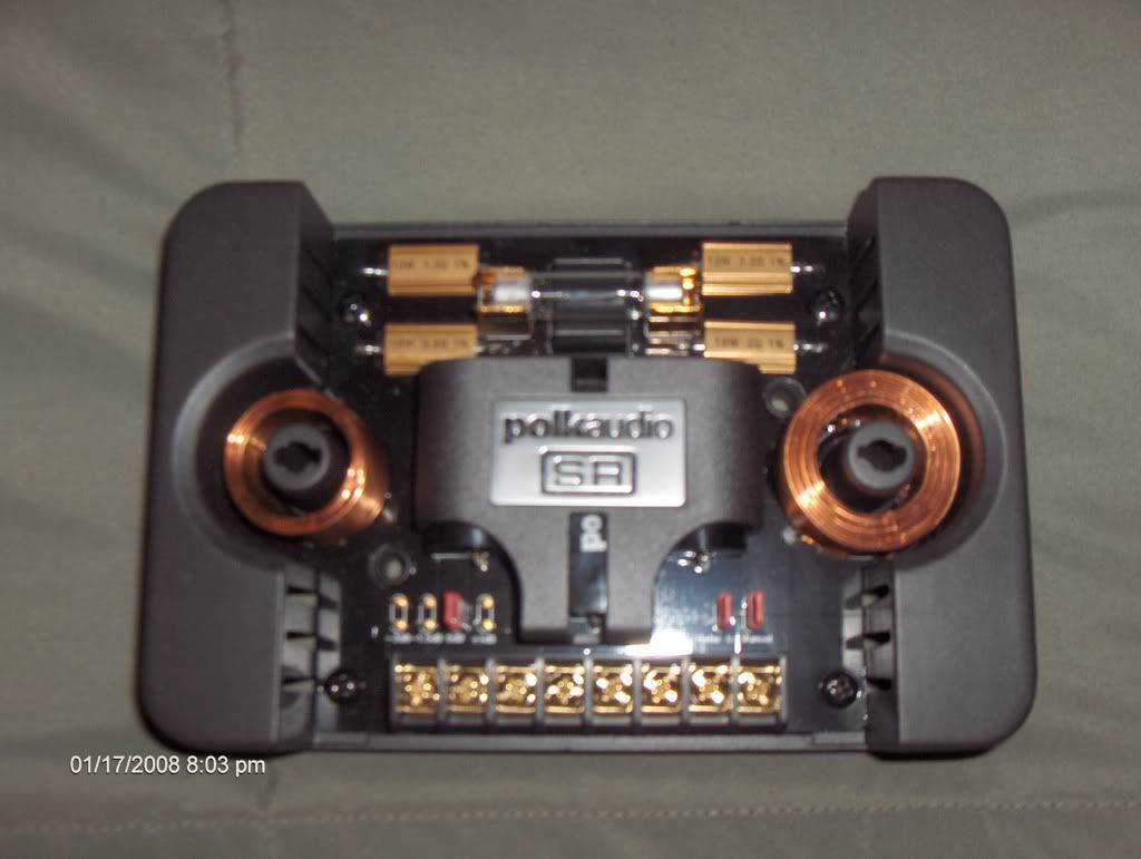

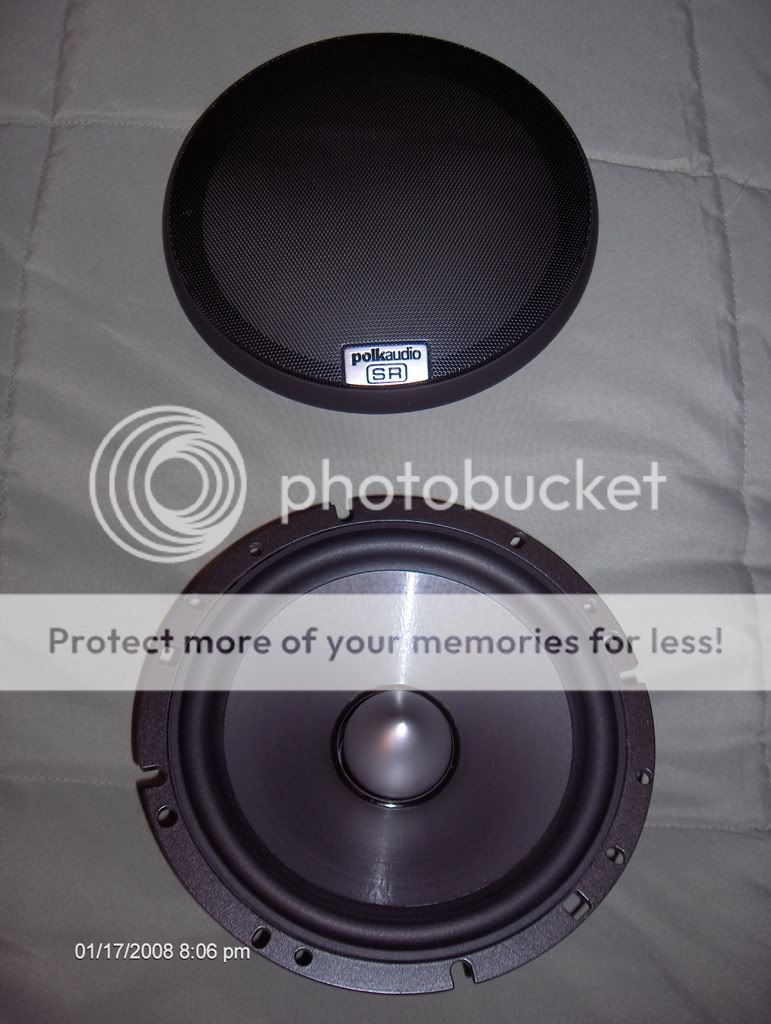

In the mean time, here are some pics unboxing the sexy SR6500's:
Big Black Box of Glory
Awesome Packaging
Tweeter

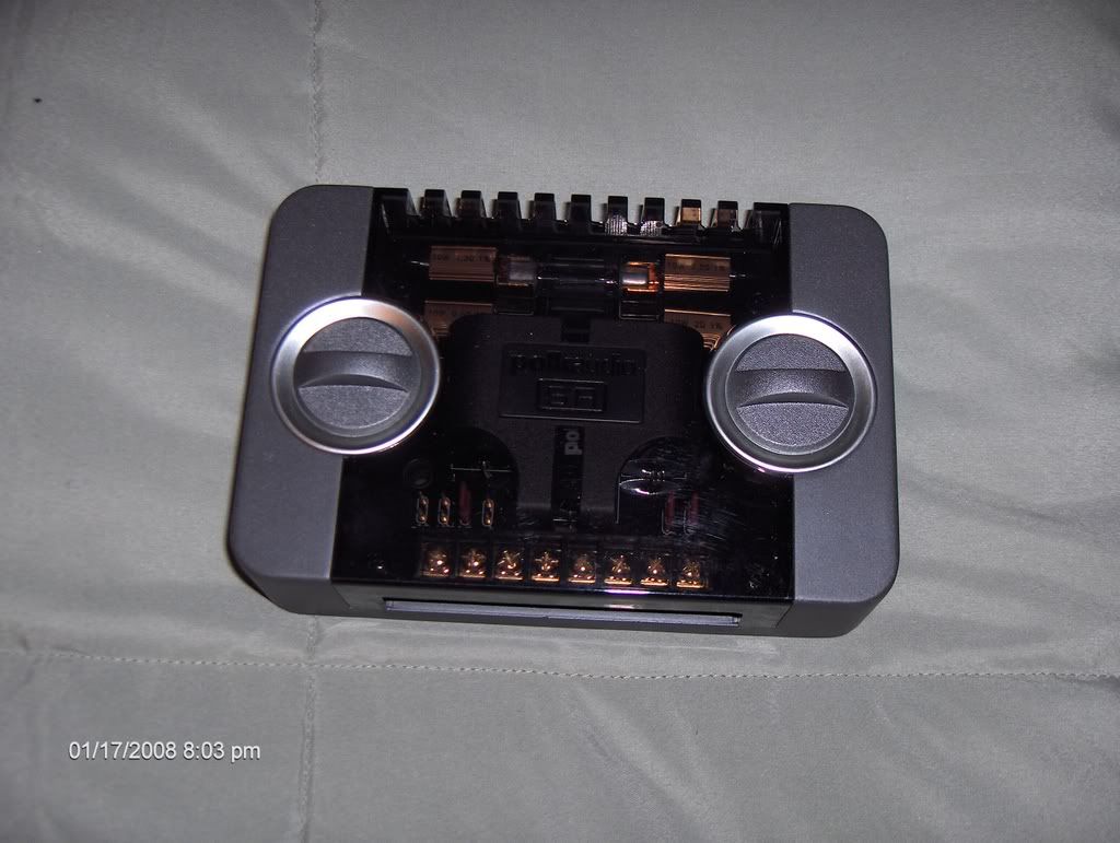

Massive Crossover

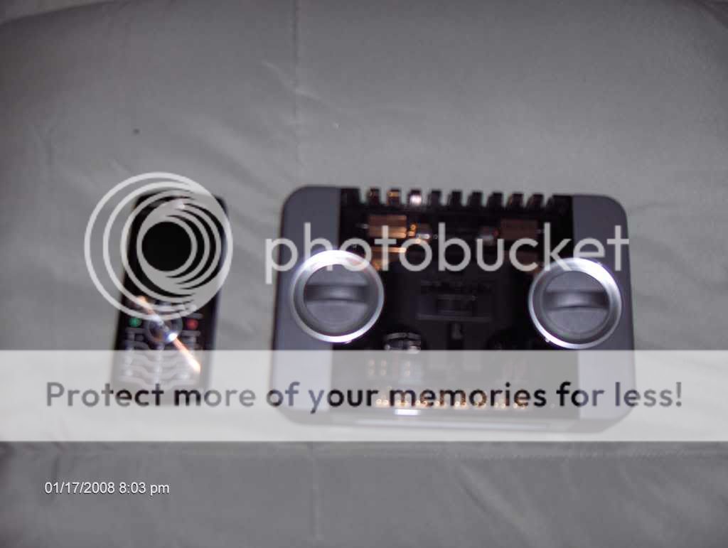

Crossover next to my SLVR for size comparison
Crossover opened up. Hot.
The woofer
Worth every cent too.
