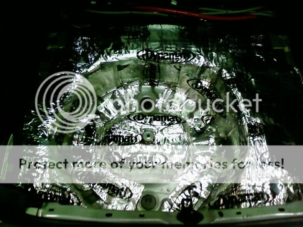

Dynamat'ed the hatch floor today. Used about 4 sheets. Sorry for the crappy cell phone pic.
Wow, that's pretty :) very nicely done mate
Thanks! I need to do another layer, but I ran out of dynamat. The rear doors, hatch lid, and floor took up my whole bulk pack (36 sq. ft.). I plan to get another bulk pack to split between the front doors and hatch floor again. Eventually I'll get under the headliner and the floors.

Picked up a trunk kit of dynamat (for almost free because of associate rewards) yesterday. Also received the dual 10" sub box I ordered. Looks too big in the hatch since the rear is not slanted, so there is a lot of wasted room at the bottom of the seats. I may just end up making a box.
Actually got some work done this week. So glad school is over for the summer. Got a layer of RAAMmat over the dynamat and then lined the entire hatch with Ensolite. Also got the amp mounting board cut and the amps mounted. RCA's and power/ground/remote wires run.
