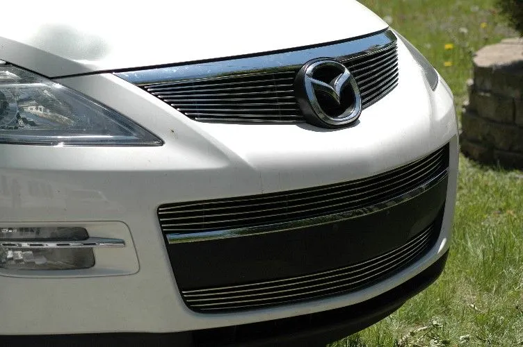

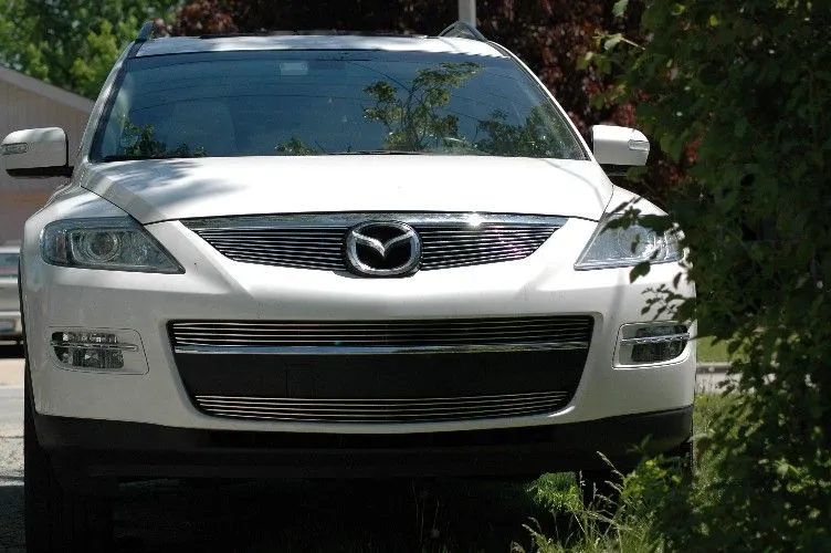

Here's the pictures of the chrome mesh grill I installed a week ago that I bought from eBay. Sorry 'bout the picture quality, but I took the pictures with my cell phone camera. I think it looks okay, I prefer mesh over billet grills.
