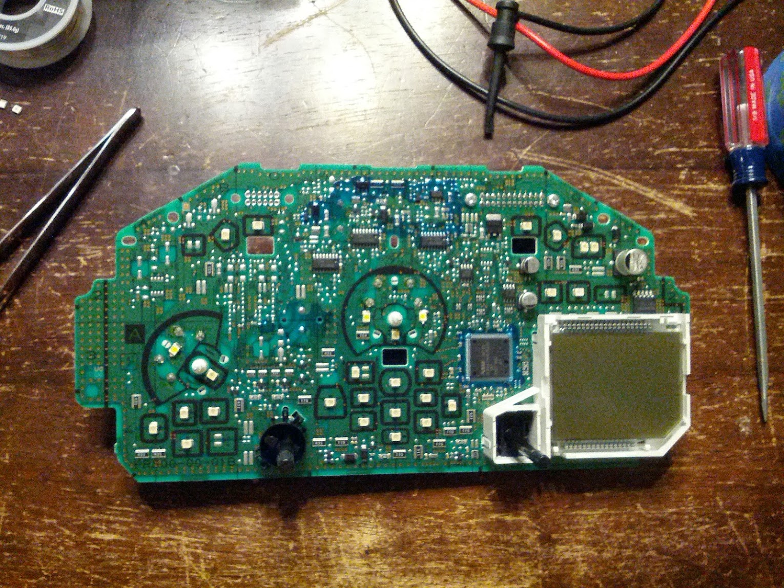

Once you have the circuit board out you'll want to identify the LED's to remove. Hopefully this picture illustrates that well enough for you:
The LED's circled in red are those that light up the main background on the gauge cluster. They are the ones I replaced with white LED's. The ones circled in yellow light up the needles, and I replaced them with blue. I also circled the resistors that are in series with these LED's. I have not done anything with them yet as things work okay without a change there, but I may swap them out a little later so that my new LED's operate at a higher brightness. You would have to test to see which resistors are associated with which LED's and do some calculations to determine what to replace them with. Just remember that red LED's typically operate at 1.8V while blue and white operate at around 3.2 or 3.3V.

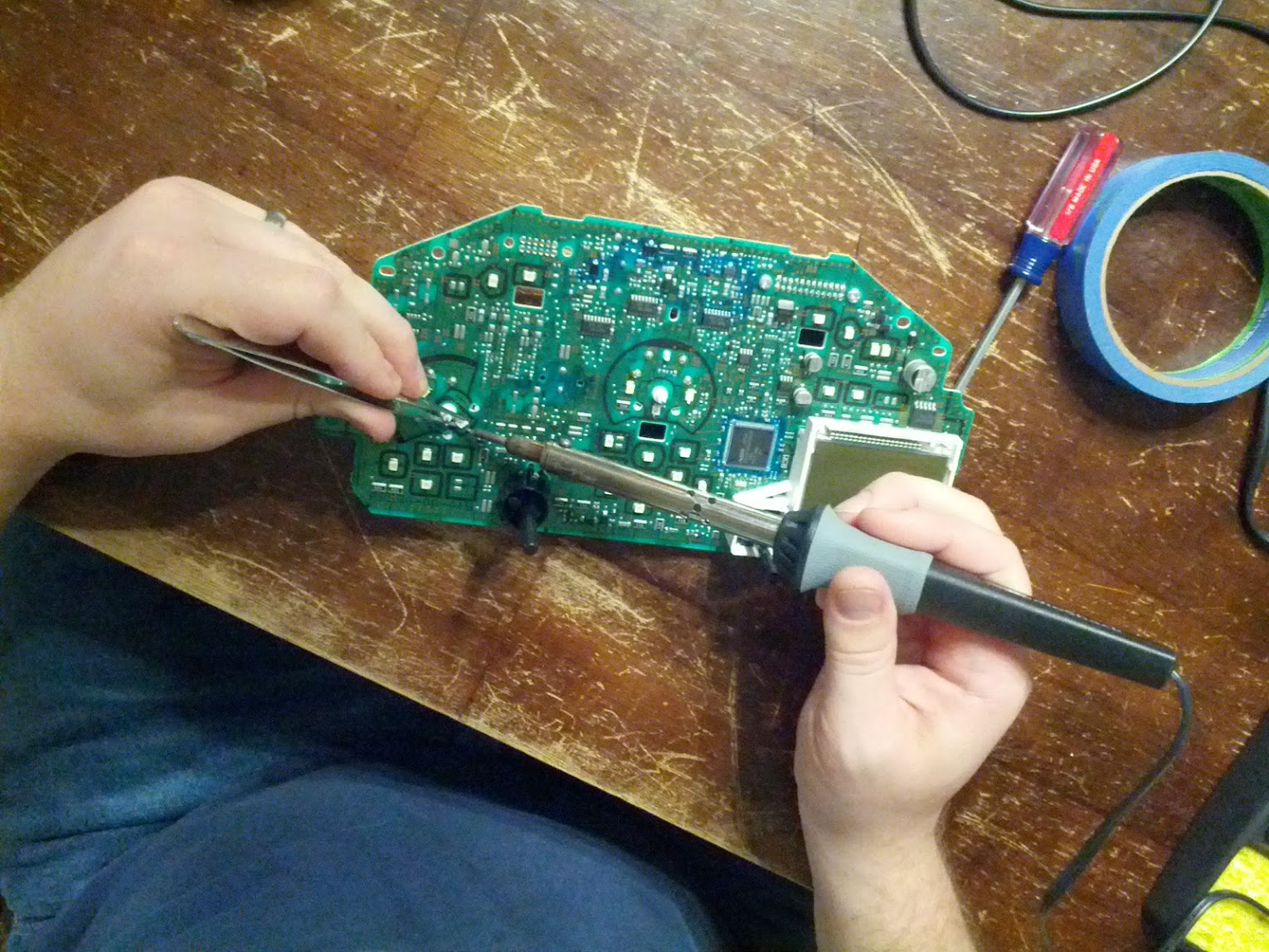

In order to remove the LED's you will need a soldering iron, of course. Tweezers are a must, as well. The best way to remove them is to grab the LED with the tweezers and then apply the soldering iron to one of the soldered sides until it lifts. Then, with one side lifted, you can get a better grip with the tweezers and melt the solder on the other side to fully remove. Here is a picture which may or may not be helpful in illustrating this:
I'm not an expert in soldering, so I likely did a bit of a hack job in putting the new LED's on. Surface mount LED's are tough to work with. The only pointer I have is to make sure you have it oriented correctly when putting it back on. The LED's are marked with a cut corner, so just make sure that matches with what you removed.
