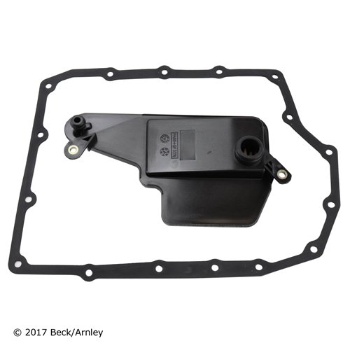

This kit from Amazon claims to have a rubber gasket. "A premium engineered rubber pan gasket is included "
https://www.amazon.com (commissions earned)
I'm willing to try this out when I change mine but don't plan to do the filter until 80k miles. Just gonna drain and fill for now. I'll keep an eye on it if it does break down like bmninada experienced.
I'm tired of dealing with RTV... I've never had to use on autos but on power-sports repairs.
But, you won't need to mess around with the new gasket and dropping the pan if you're just going to drain the fluid. Isn't there a drain built into the pan for this?
