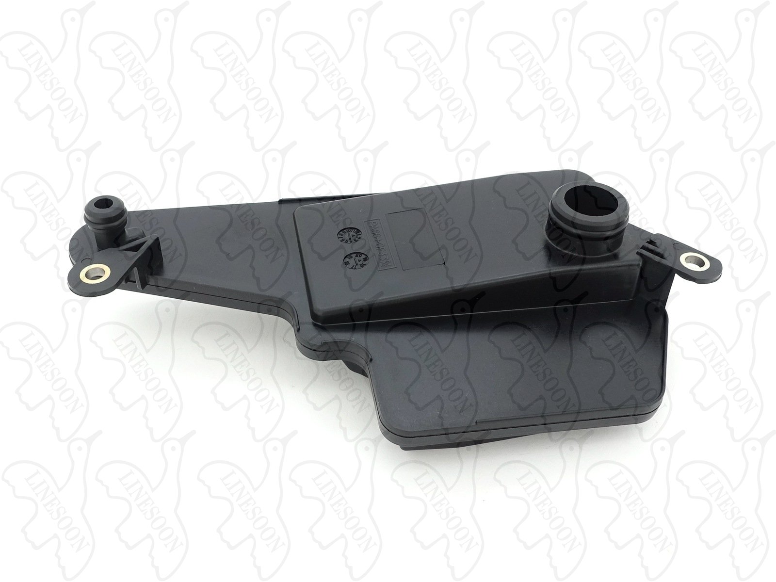

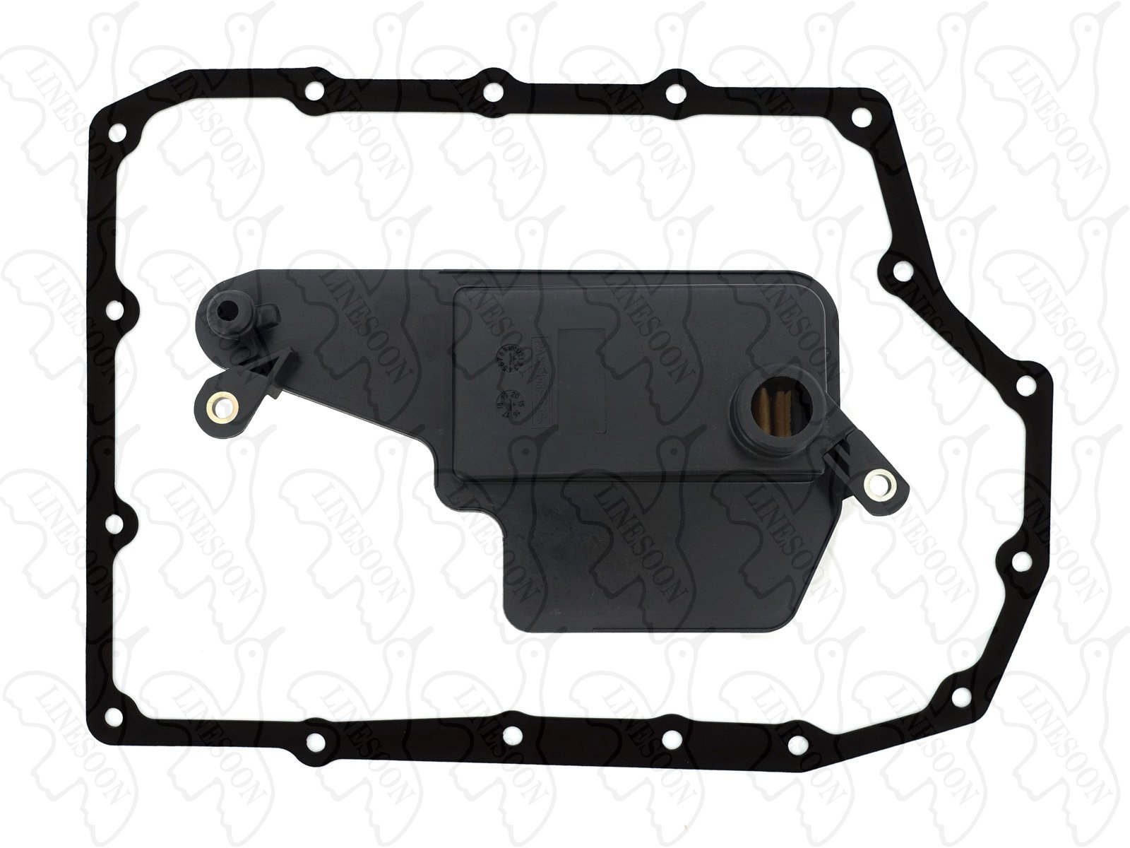

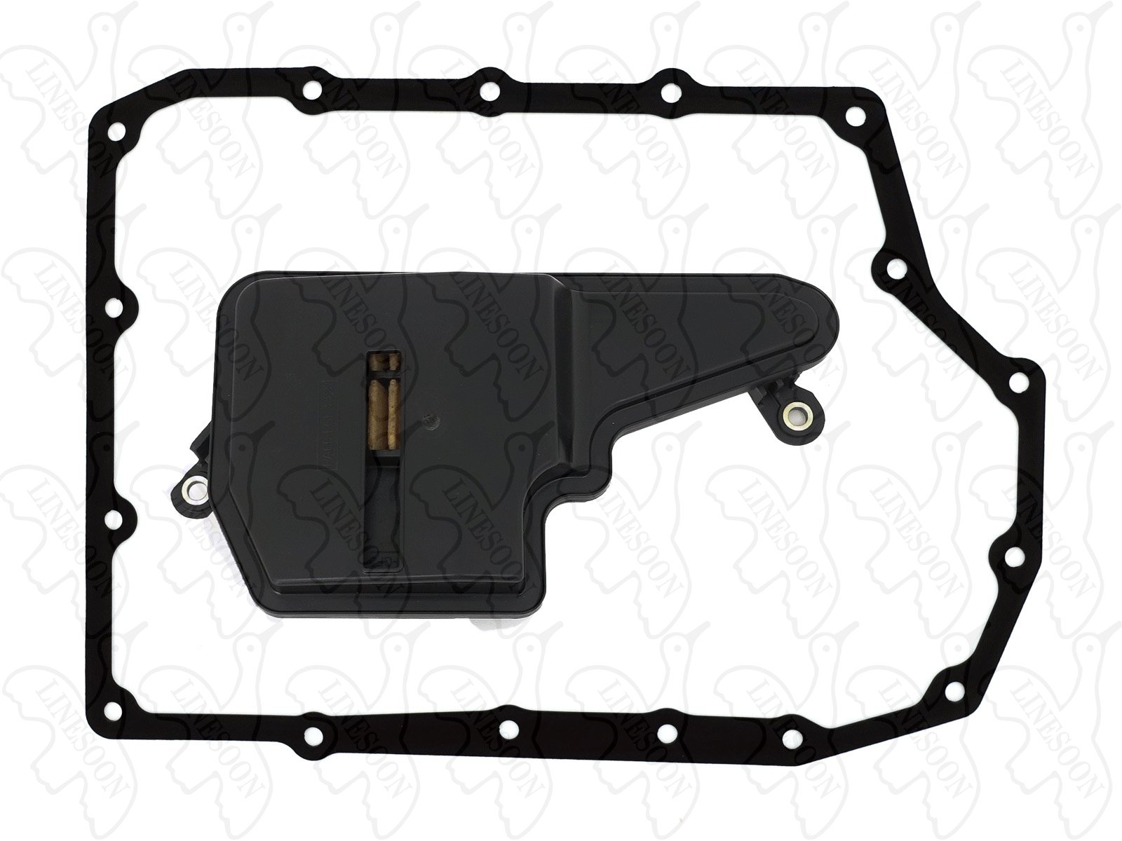

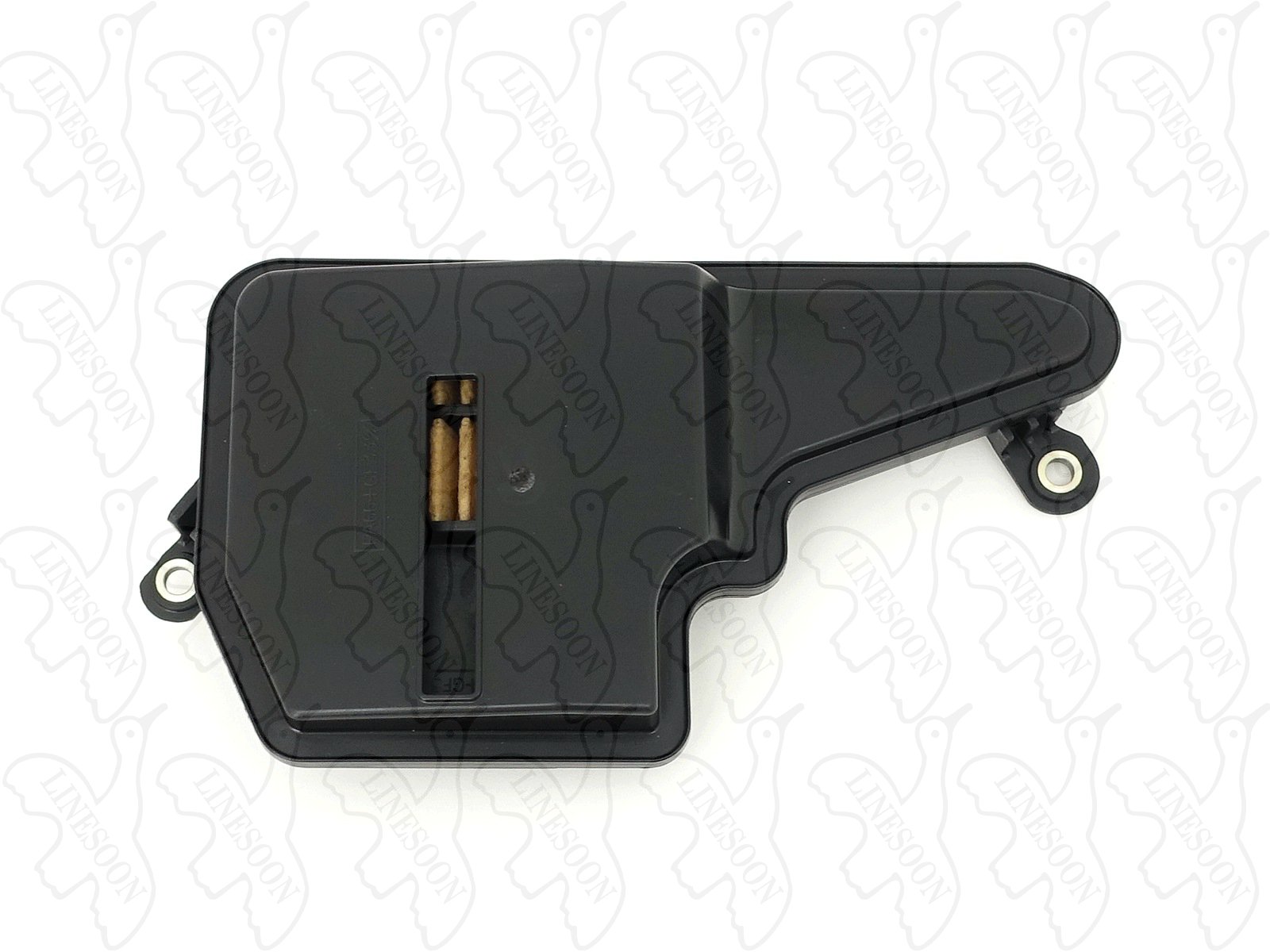

Check this out... looks like a kit with a gasket is available.
http://www.linesoon.com/index.php?lang=en&unit=products&act=view&id=2165
Part Name:Filter Kit
Ls Part No:K71726
Brand:MAZDA
Model:3, 6, CX-5
Transmission Type:FW6A-EL
Year:14-UP
Oem No:FZ01-21-500
Description:JATCO FW6A-EL MAZDA 3/6/CX-5 SKYACTIVE-DRIVE FZ TRANS
JATCO FW6A-EL
MAZDA 3/6/CX-5
SKYACTIVE-DRIVE
FZ TRANS
I would try to find one with a silicon gasket as well... Good to see these options show up as it makes the job a lot easier. You can do it in one day instead of having to deal with cure time for the RTV.

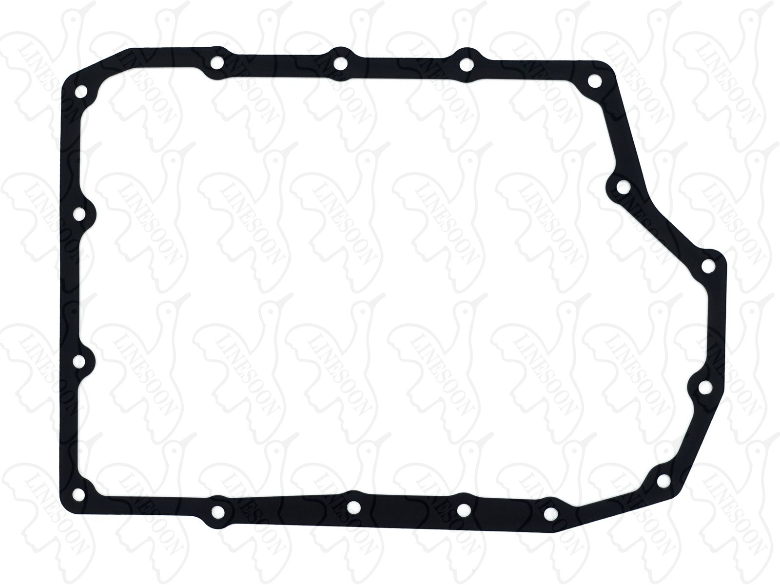

Thankd for the info. With ready-to-use pan gasket the job should be a lot easier and more consistent for not leaking at the first application than applying the silicon gasket. But from my past experience those cork gaskets for automatic transmission pan would start to leak eventually, not as reliable as the silicon gasket.
WAIT -- it's the same company - do NOT use it. I had used the exact same thing but for 2007 Toyota Corolla. After 3 months thankfully in my garage found blood all over ...... only to realize its transmission fluid!
The gasket is made of some type of hard material which was crumbling when I dropped the pan again. I believe its due to high temp.

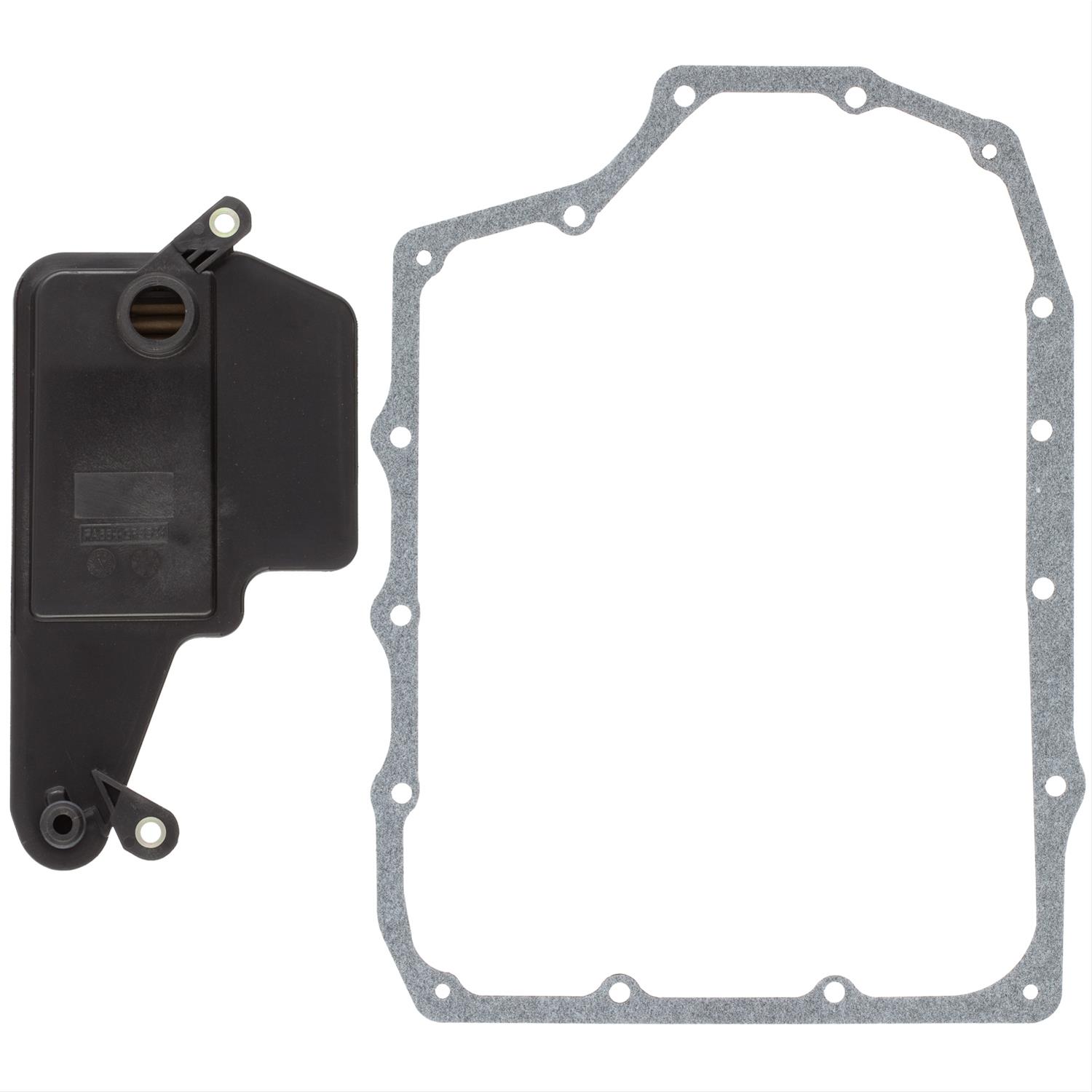

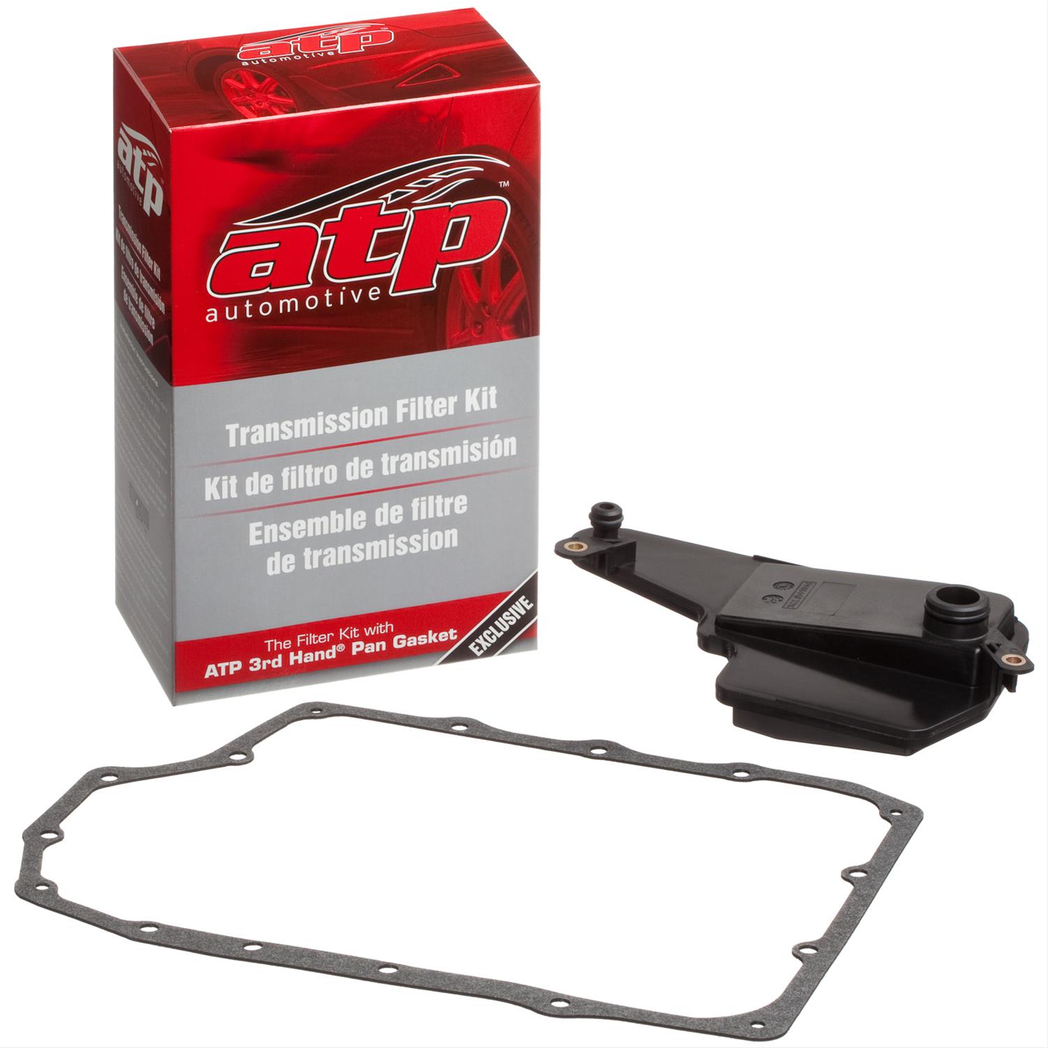

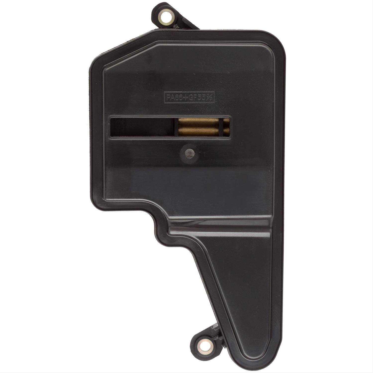

I wonder if a few kits out there?
https://www.amazon.com (commissions earned)
Summit Racing has one from company called ATP Automotive
"ATP Professional Auto Parts is a leader in automatic transmission replacement parts. Founded in 1955—back when no aftermarket manufacturers offered automatic transmission parts—ATP now offers a wide array of high-quality products for both automatic and manual transmissions. Summit Racing carries a huge selection of ATP Professional Auto Parts, including flywheels, flexplates, transmission pans, transmission filters, clutch forks and cables, ring gears, and more. Plus, we offer ATP’s transmission fluid additives, friction modifiers, and differential supplements. Whether you’re rebuilding an old transmission or want to keep your current tranny running strong, ATP Professional Auto Parts can help you get the job done right."
https://www.summitracing.com/parts/atp-b-431
