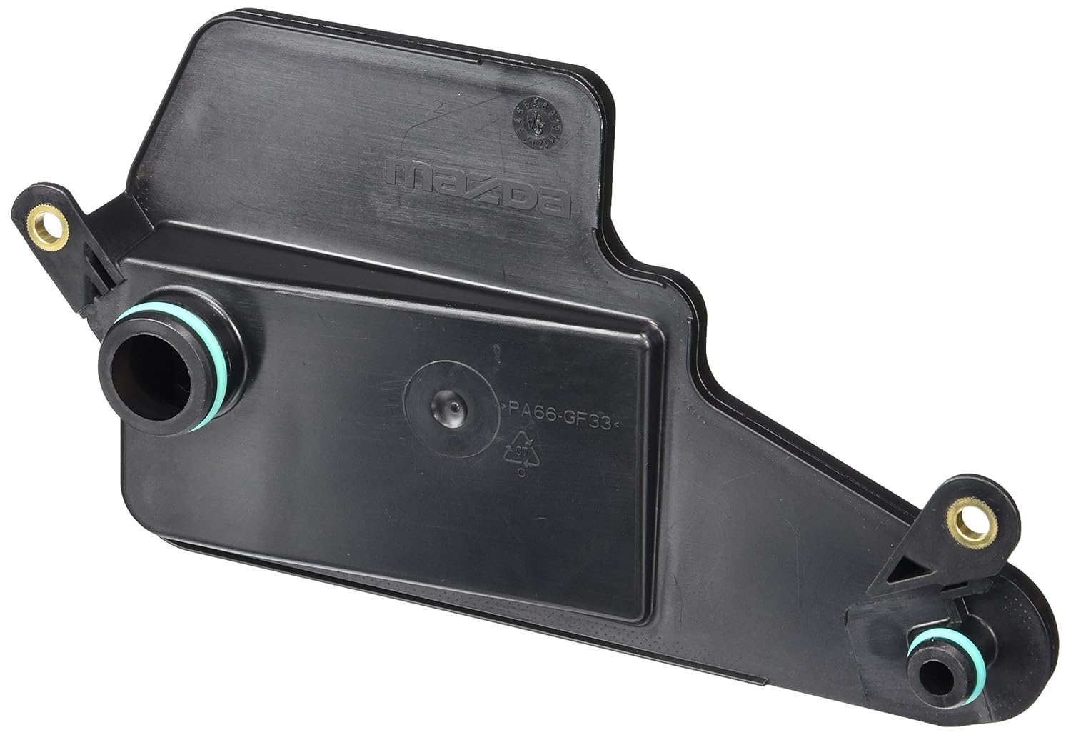

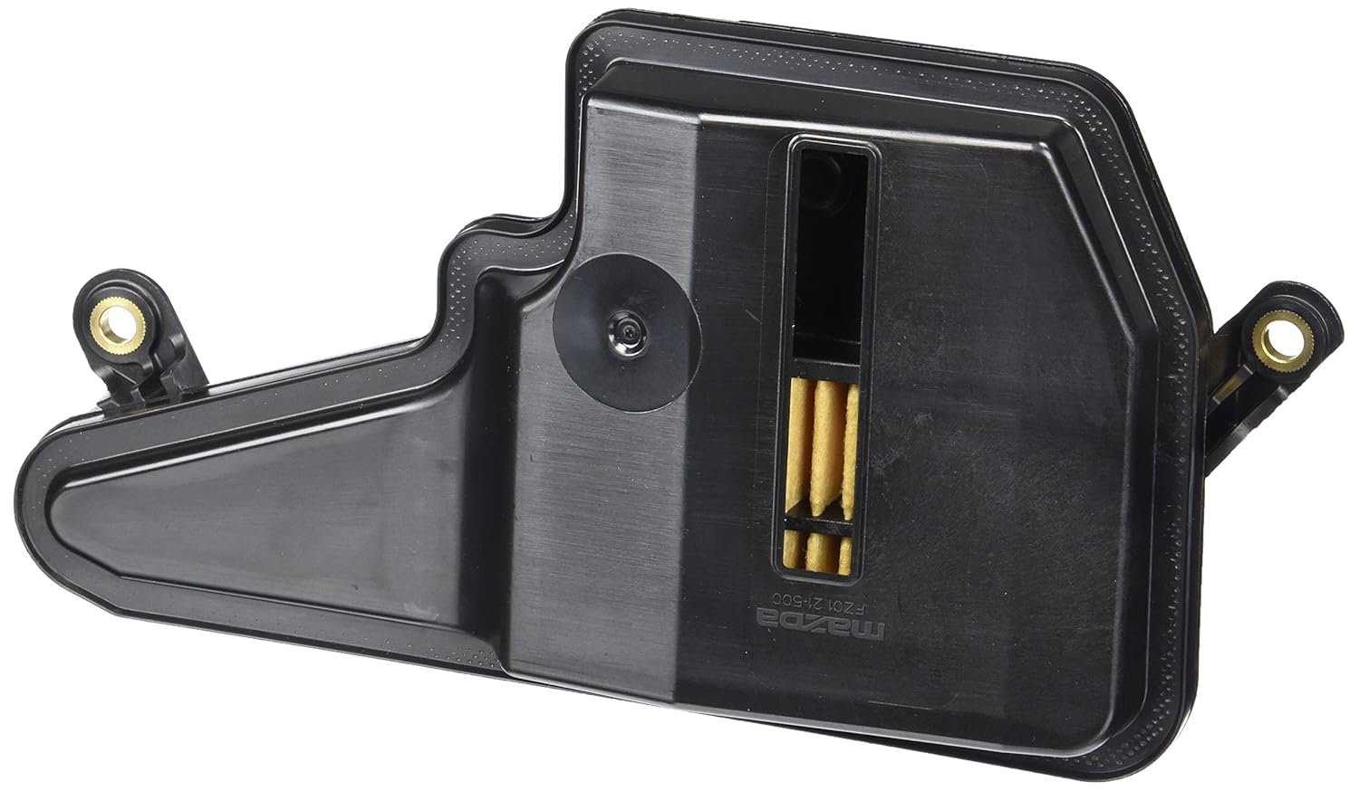

The video says the Mazda FZ01.21.500 filter is screen type so the guy just washed it clean and re-used it. I remember the window sticker says the automatic transmission is 100% made in Japan. I was wondering why this filter is made in USA?

It is interesting that it is a domestic part.... I looked around and thought maybe some domestic or Ford use but quick searches didn't turn up anything.
This filter does look like not a screen type. Nevertheless the video says the "screen type" filter got cleaned and re-installed back. Strangely these pictures of filter from Amazon doesn't have "Made in USA" on the plastic case anymore.
This Mazda filter seems to be custom designed for SkyActiv-Drive automatic transmission and shouldn't be used by any other transmissions.

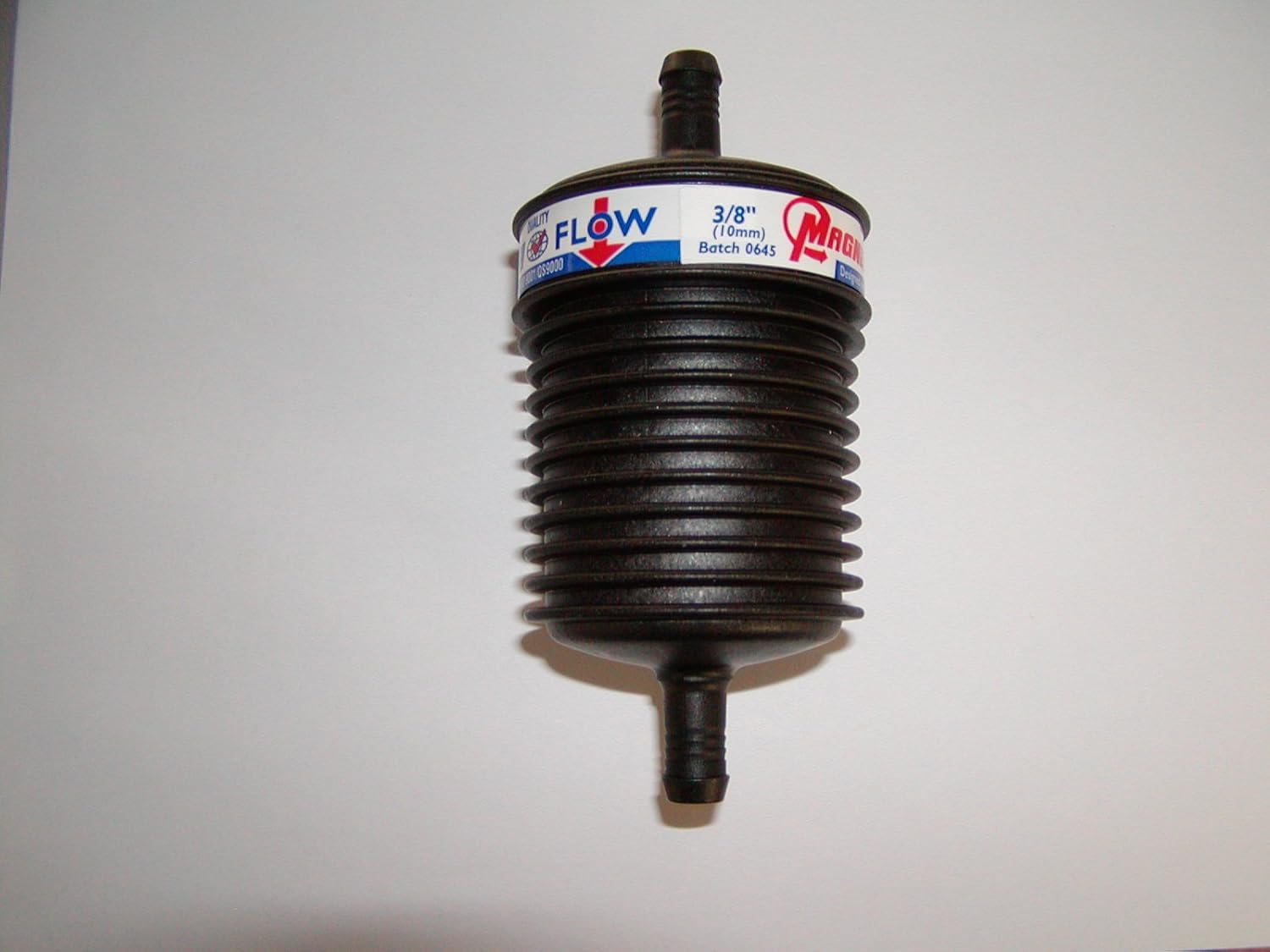

I wonder what you'd stick the external filter to, as there are no external lines with ATF flow...
