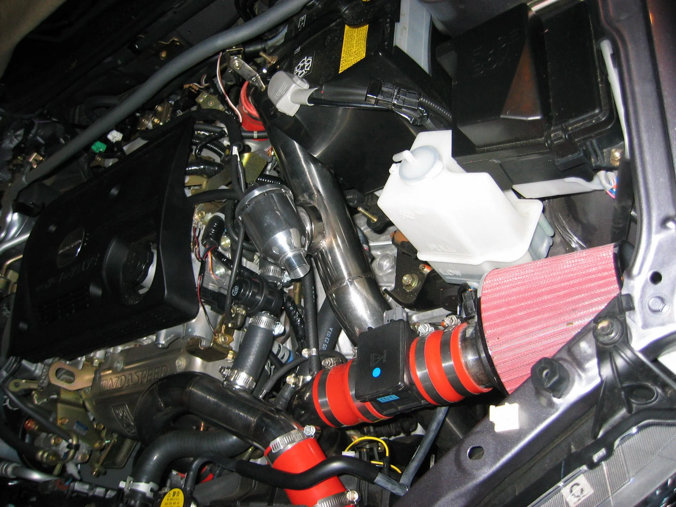

Check it out my man...
What do you see here, THAT's RIGHT... A RECIRC FITTING ON MY BOV!
That's the way Essential Speed designed it and I payed for the fitting because I did not want to stall. I just wanted to recirc. I didn't care about sound... just performance.
505's discovery eliminated a flaw in the system.
Stop being a putz and realize that this set-up is useful for some people.
Now I'm left with this recirc fitting on my BOV that is getting no use... Oh Well, at least my car is driveable now.

explain the flaw?? so you telling me that you were stalling with the bov reciruclating?? because that would fuction like stock, correct me if i'm wrong. Unless you had the wrong spring in the bpv.
I've never ever seen a recirculated bov car stall. So if your telling me that ours does, i would say its the way you installed it.
The ES intake places the BPV return flange too close to the MAF. The incoming air creates turbulance at the MAF, sending a false reading to the PCM. In Mark's case, now that he doesn't have all the air that was coming out of the SSQV going into the intake, he doesn't have that condition.

Yup, stalled with the HKS recirculated. That is why I bought his kit even though it was much more expensive than any others. I wanted it to function like stock coupled with the performance of a FMIC.
The HKS had the original spring it so that is not the problem. The spring is also adjustable and I adjusted that hing fractions of an 8th of an inch to get to no stall. Nothing worked. People from this board stopped by out the kindness of their heart to try and diagnose it but no one could.
Later it was thought that the recirc fitting was too close to the MAF and some of the air was pushing back to the the MAF when recirculated so ES sent us all new intake pipes with the fitting about 4 inches further away from the MAF. I was so excited to take it for a drive after replacing the pipe but it still the stalled.
At this point I had invested so much time and money in trying to find a solution and ES wasn't helping any, so I figured that I would give this a try. I didn't want to hack into my pipes for something that may not work so I put the stock upper intercooler pipe back on and rigged the stock BPV back on with the help of some items from Home Depot and low and behold, no more stalling and no more surge.
The next day I was looking in the phone book for welders who could weld a fitting on the upper intercooler pipe from ES.
Had the fitting welded on and haven't looked back since.
I spoke to 4 other people who have the ES kit and they all have the problem also. After everyone telling me that I have a boost leak, I ruled that out because how could 5 people install a kit with a bad connection?
ES has now said that it is the HKS that is causing the stalling. Something that it can't hold the pressure and is leaking air.
I don't believe that at all.
The dual valve set-up worked for me... that's all I can say.
Mark
