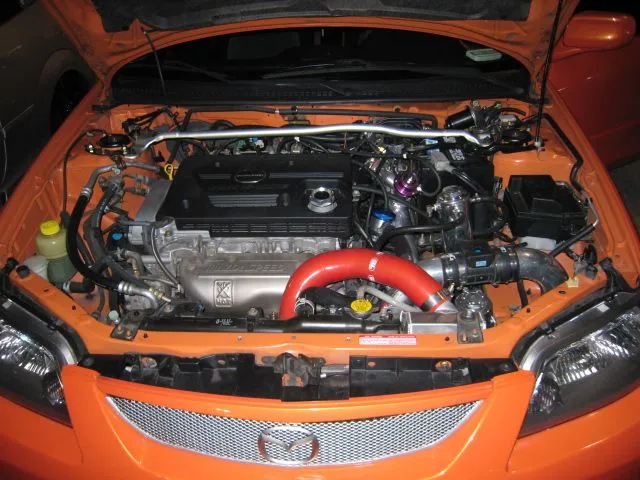

i know this thread is old as hell but i recently did the dual bov.bpv setup and im still stalling and settings on my BOV is fairly hard....was hoping if i post pics you guys will help me out also...?
bro i feel like a ****** idiot, i was stalling because BPV was installed backwards! now its good...runs ****** great..relocating MAF this week
