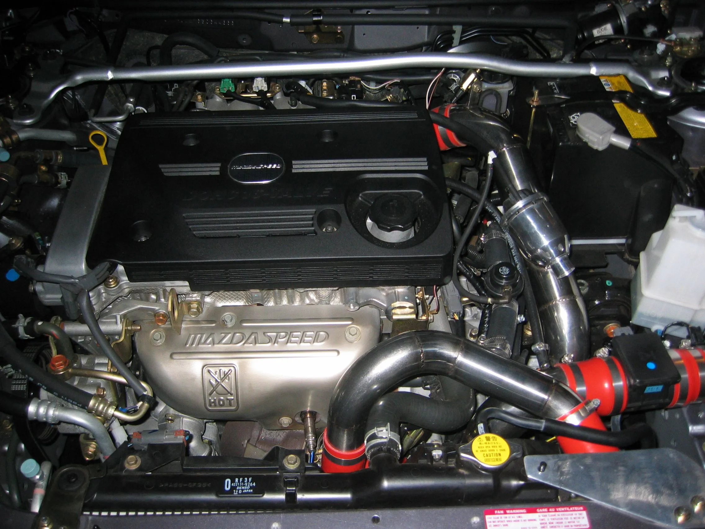

I realize that but at this point, I had spend $1700 on the ES kit with the BOV, another $135 on a used Injen, $125 on new couplings, etc. I had already spent enough trying to figure out what the problem was.
Don't want to go back now, I'd be left with a hole in my upper intercooler pipe.
Notorious, again, thanks for the help. I think I got it where it doesn't look to bad either. All the hoses and the valve is black so it blends in a bit. Most people don't notice it because their attention is focused on the "shiny metal".
Looks less obtrusive from this view. I just have to hide the clamps a little better. Thinking of painting them black.

i got a question for anyone who knows their properties on metal.
when i got my custom ic piping, i ordered stainless steel. i'm no metal expert but my piping looks like its rusting and i was under the impression stainless steel doesn't rust. i'm hoping i'm wrong and it isn't rusting but i need reassurance before i start bitching at my tuner shop for trying to rip me off.
this is what my pipes look like after just 2 days.
