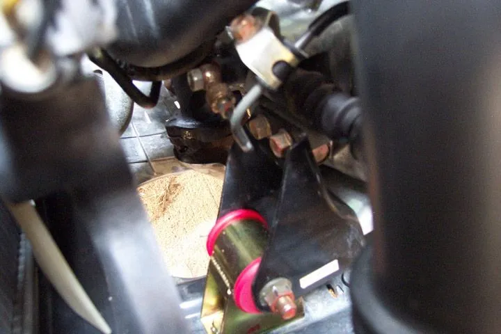

Anyone have a pic of the old or new mount installed?

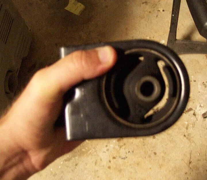

the two pics of the stock motor mount are (trying) to display how soft and flexible they are.
Everyone said that you need a huge extension to get at the front mount, but I just jacked up the front of the car & took off the plastic panel underneath the engine on the driver side. I was able to use my 1/2" drive with just a 2" extension & it worked perfectly. It took me about 30 minutes (I take longer than everyone says the first time I do anything) because I had to jack up the motor too to get the bolt to go through after I put the AWR mount in.
yea you don't have to take any of that to get do it, i get the 17mm bolt out from the top and the 2 from the bottom
I didn't want to risk stripping anything so I disconnected the bottom IC pipe so I could fit an impact wrench on the horizontal nut. Air tools are the shizzle!
You are going to love how the car drives when you're done, but the initial sound & vibration really startles you the first time you start the car after the install. :D
I disconnected my IC pipe too, but with the bottom plastic panel off, there is really no need. Air tools & impact wrenchs aren't necessary if you just do everything from the bottom.
