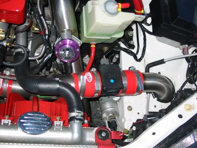

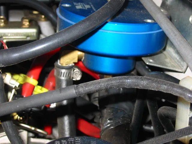

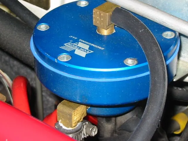

here are some pics of my FMU

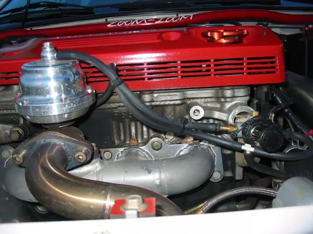

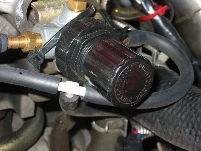

here is how I have my boost controller hooked up

dude mike i hope that the line that comes off the front of the FMU at a right angle in the first pic goes to your fuel rail. otherwise i hve it hooked up wrong.
It does, I just tucked it under some other lines to keep the engine bay neat.
