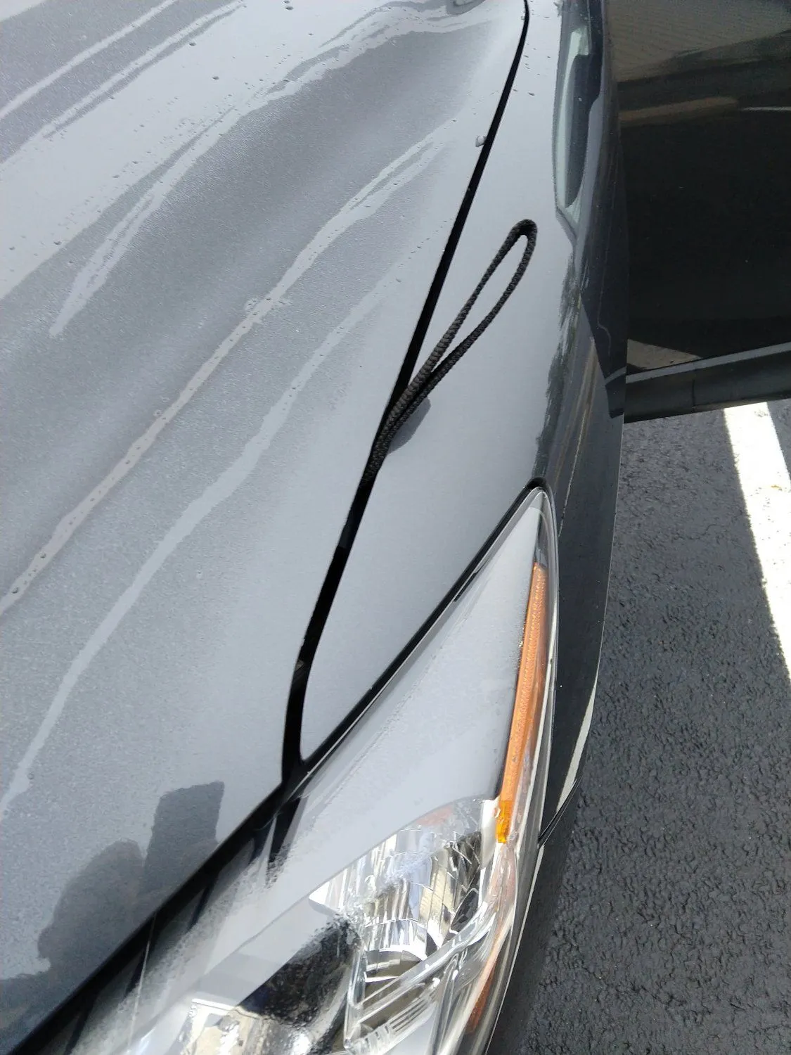

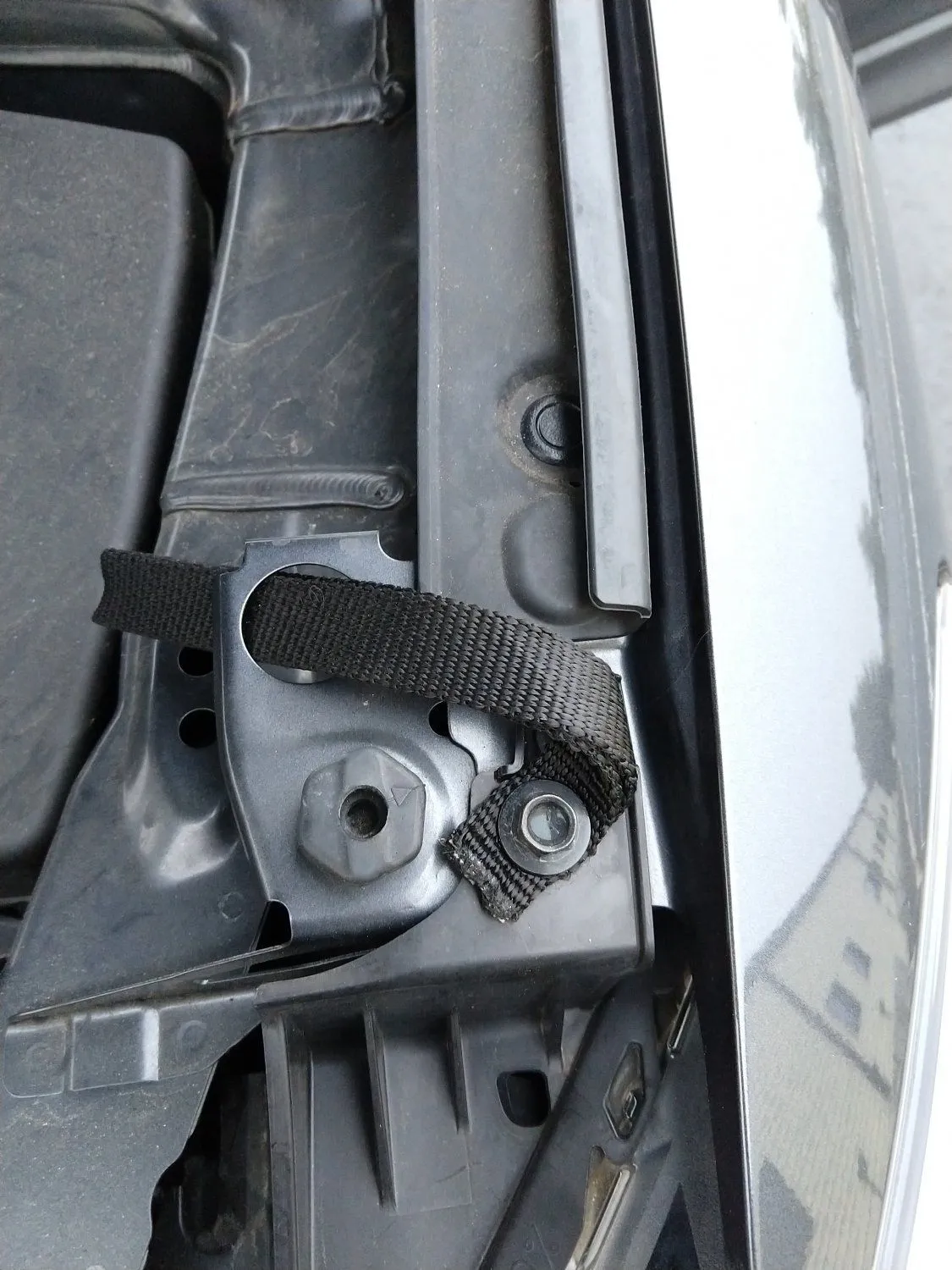

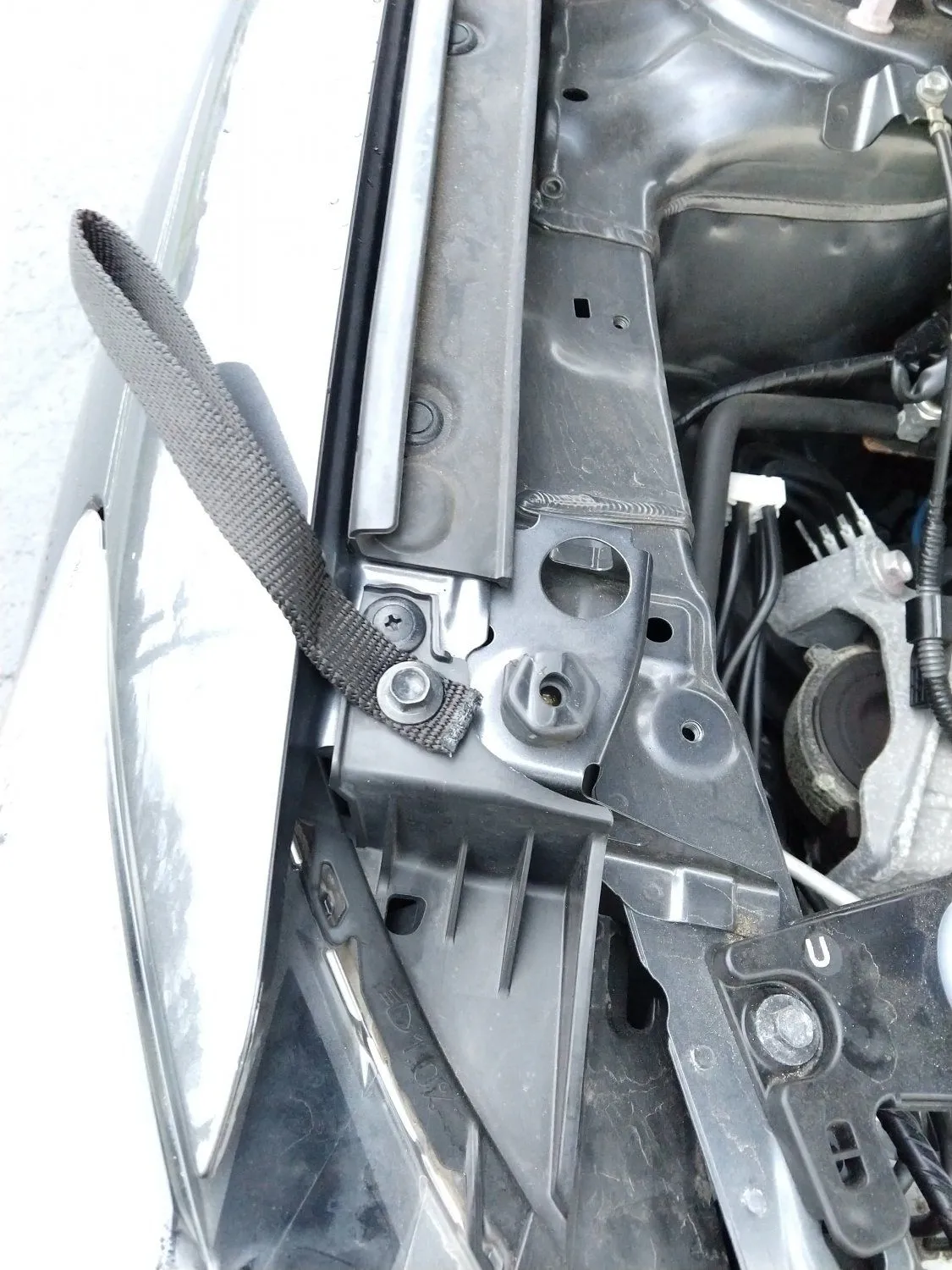

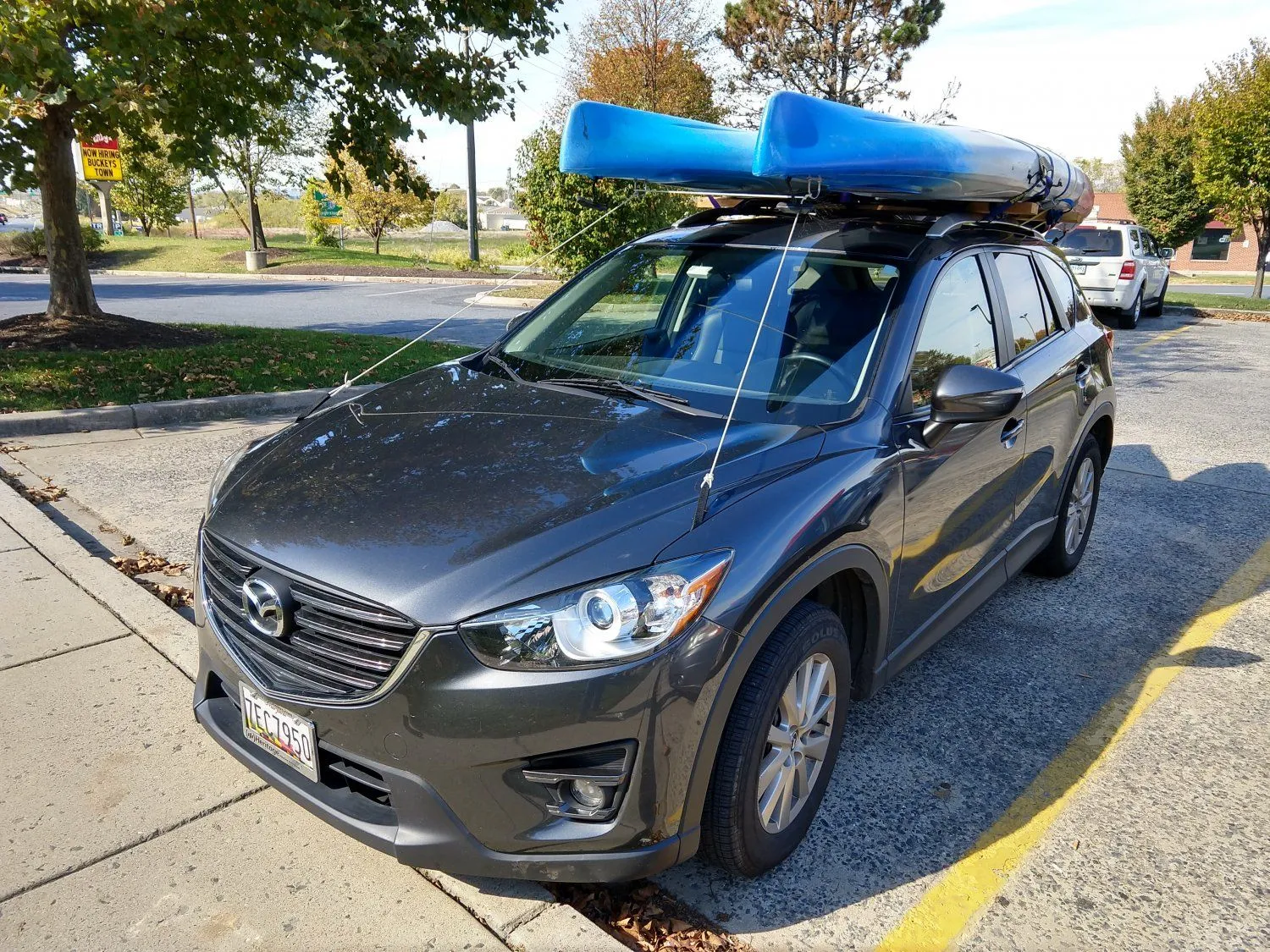

I installed a strap loops under the hood and pull them out when transporting my kayaks or SUPs
I have these as well. The easiest, simplest yet secure solution. In the back, I used hitch or tie downs inside the hatch.
Another trick you can do is tie a large loop in the webbing. With hood or hatch open, position the loop centered around the hood/hatch latch. Close the hood/hatch, pull the loop tight and you have a very secure anchor. Just beware of sharp edges or points of abrasion.
