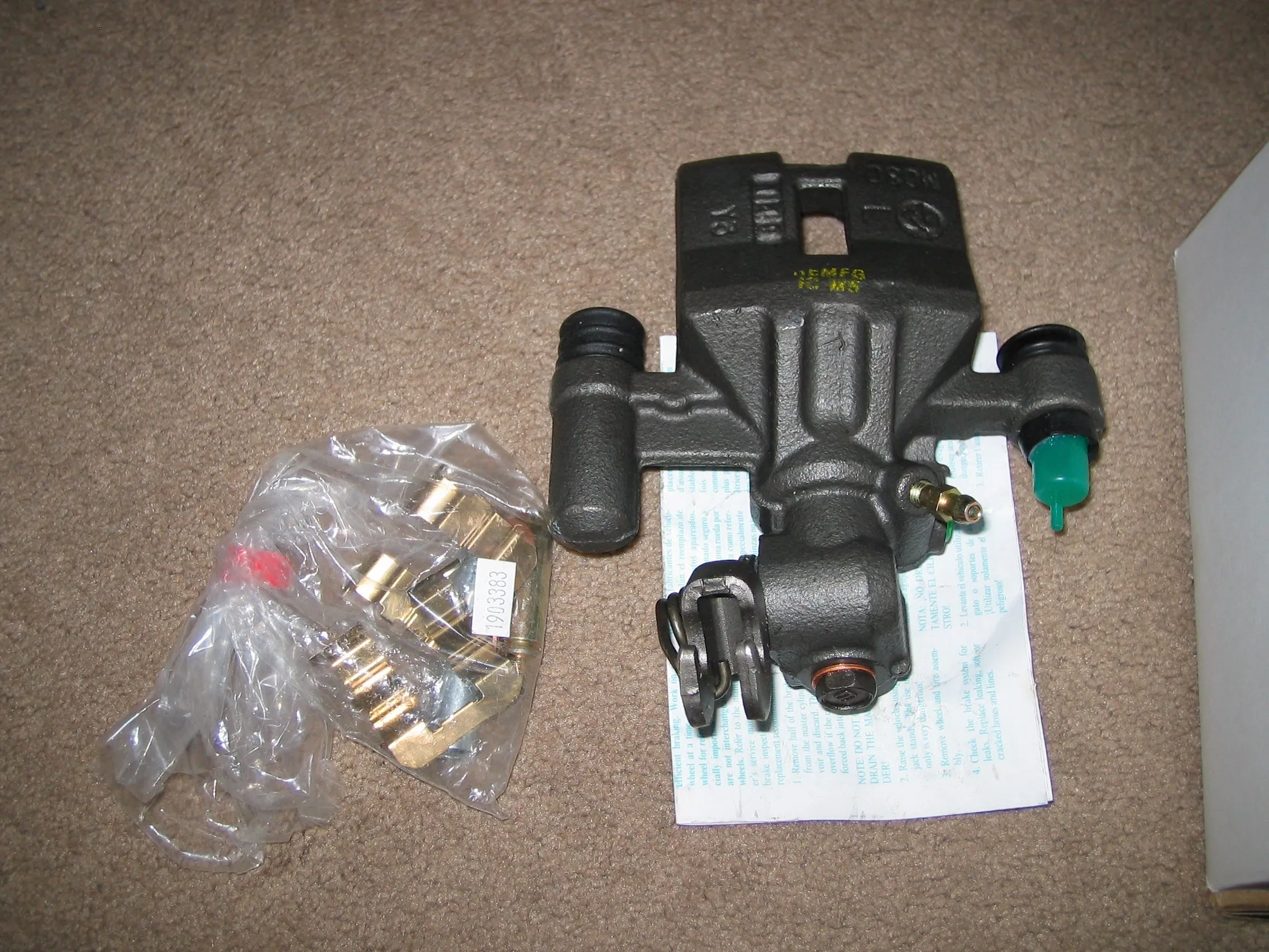

I already ordered whole caliper assembly(also comes with pads) from rockauto for about $140, but I will get about $60 back when I send them my old part.
but I have to return my previous order though, because mounting bracket was not included with that order(see attached pic), but it looks nice.

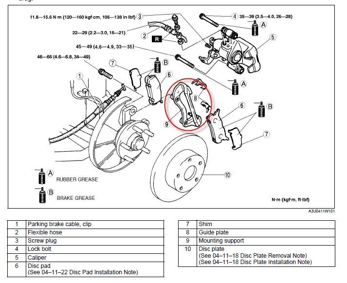

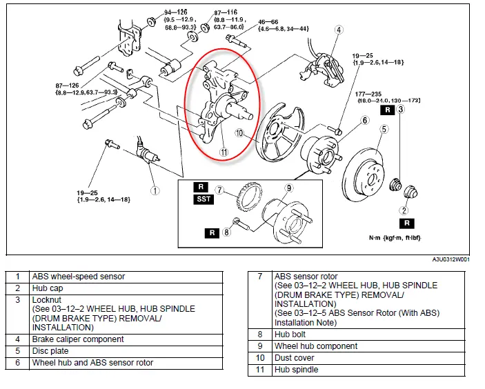

Do you know exactly which part is defective ?
The guide plate or the hub spindle ?
I do not understand what they are referring to.

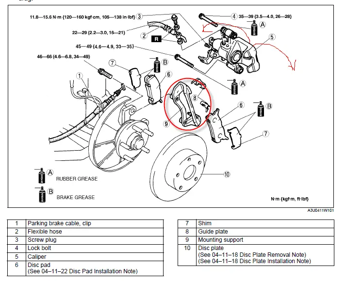

I'm not sure what it's called but they showed me.
when they were trying to remove just caliper from hanger, it should move back and forth freely, but somehow it won't let it move freely enough unless you use extreme force.
so caliper is causing problme and they said it will damage the hanger if they try to remove it from it.
sorry, I'm not a good at explainning stuff.

In that picture ^ do you know what number and thread the bolt between number 1 and 7 is?? You have to take both out to get the mounting support off and access to your rotor.

I found the part number for that. I don't even trust my shop for those. They have stripped too many oil pans or not tighten my radiator drain plug enough times.
