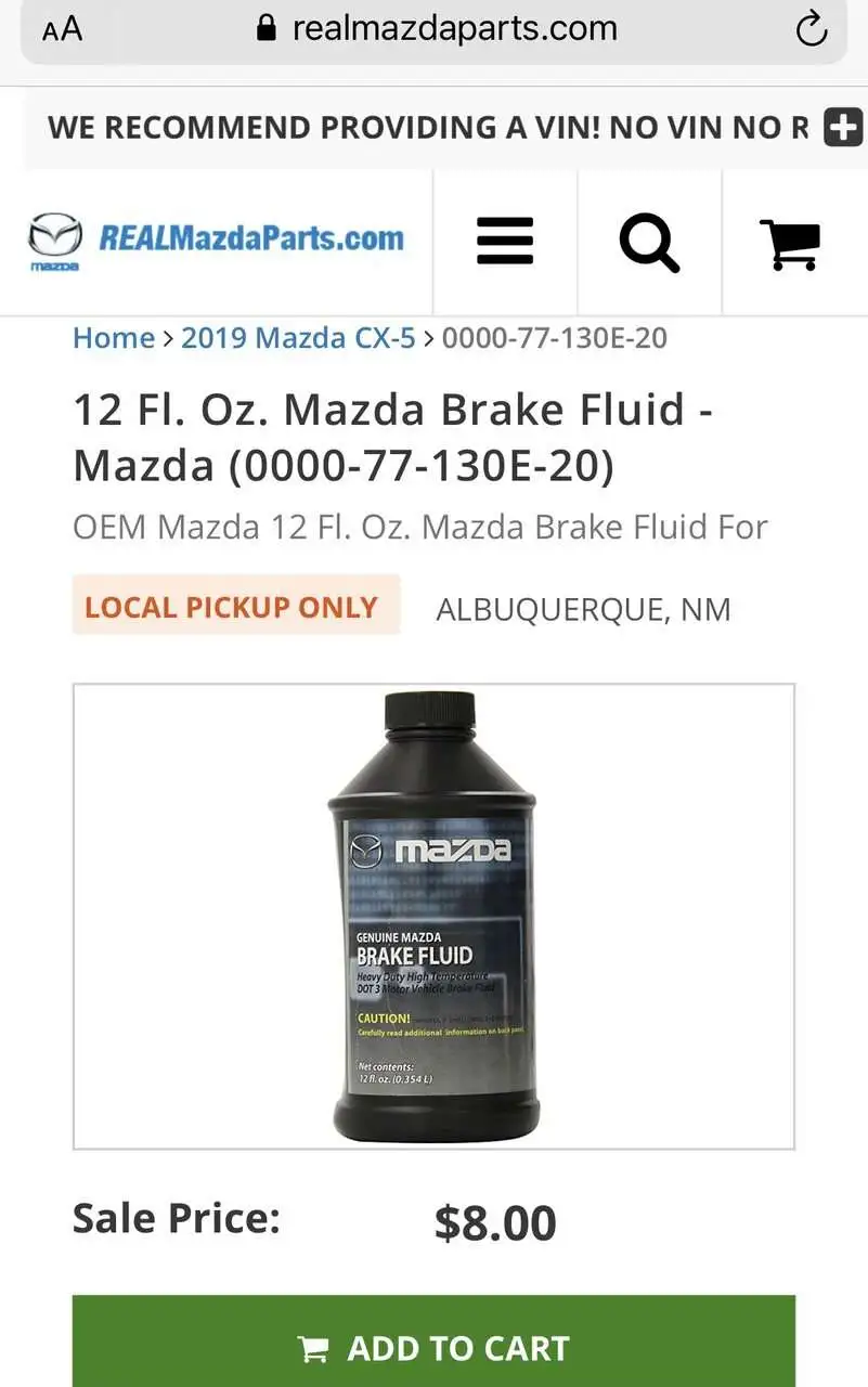

Watch for the Amazon Mazda brake fluid in your link. The part number 0000-77-130E-10 seems to be superseded by 0000-77-130E-20. Due to the problem of shipping chemical liquid products you may be better off getting the OEM brake fluid at a local Mazda dealer who doesn’t mark up the parts over MSRP、is willing to do the price match、or has the discount coupon available on parts.
