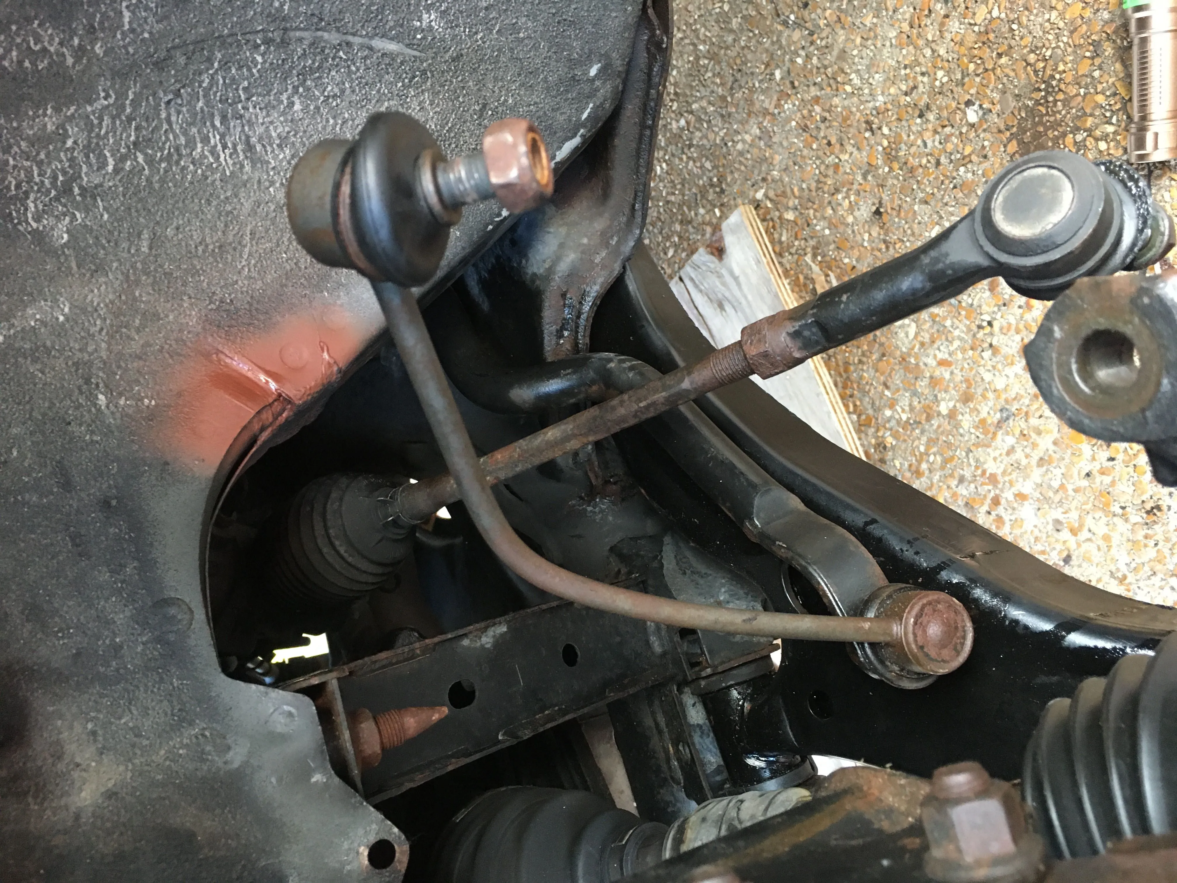

Yeah that’s the plan. I need to replace the sway bar end link “real quick”
Don't waste your time with wrenches and sockets...
Get some cut-off disks and be done with it.
Those end links are a bastard.

It looks like the nuts might be easier to remove than mine.
Try the wrenches/sockets/Allen key first but don't waste too much time before bringing out the big guns...
What's wrong with your end link anyway??
It looks fine to me ??! Lol
Allen keys? I tried a wrench and it was pretty tight. I'll try again tomorrow after the PB blaster sits but I need cut off wheels anyhow.
