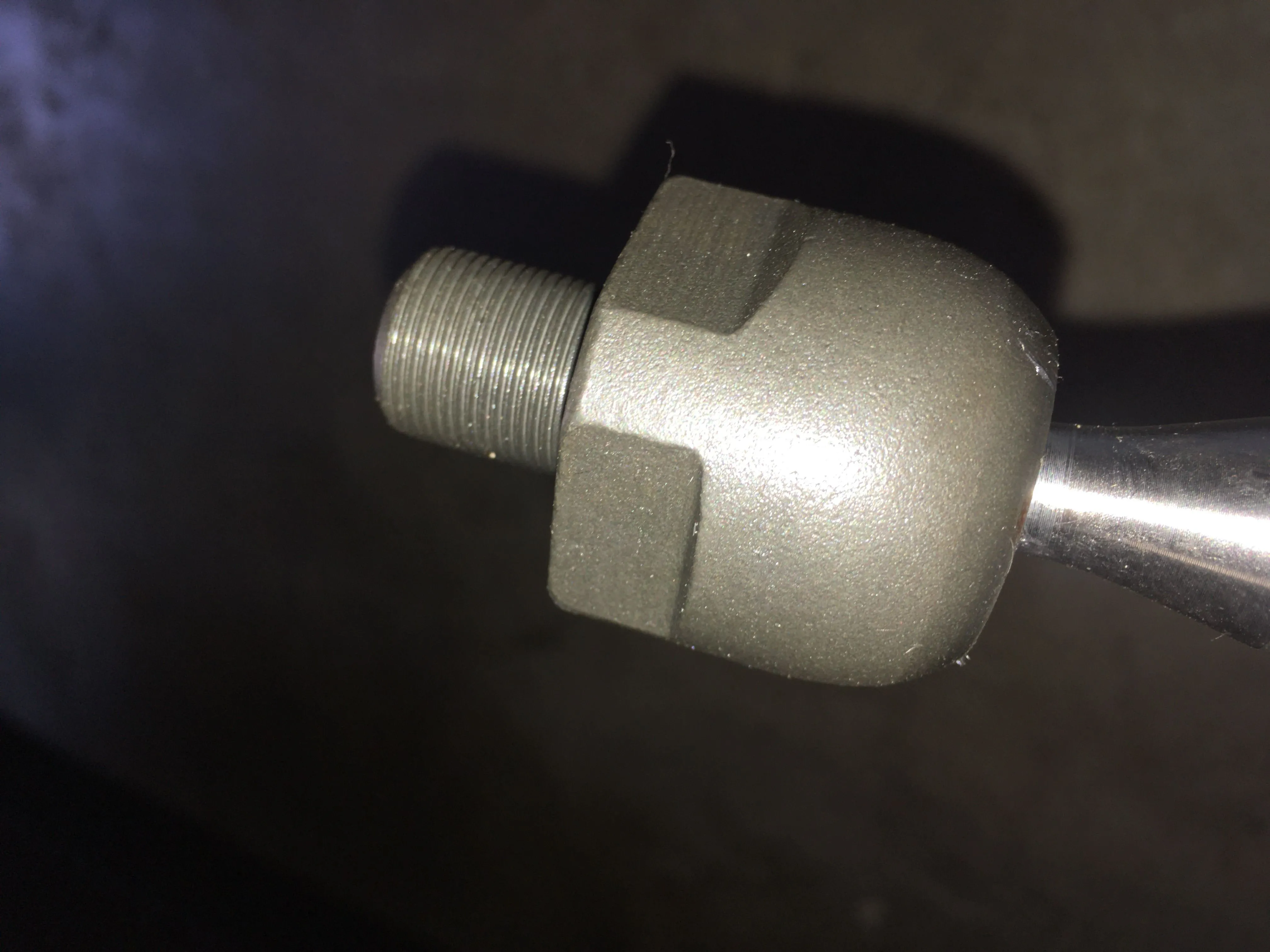

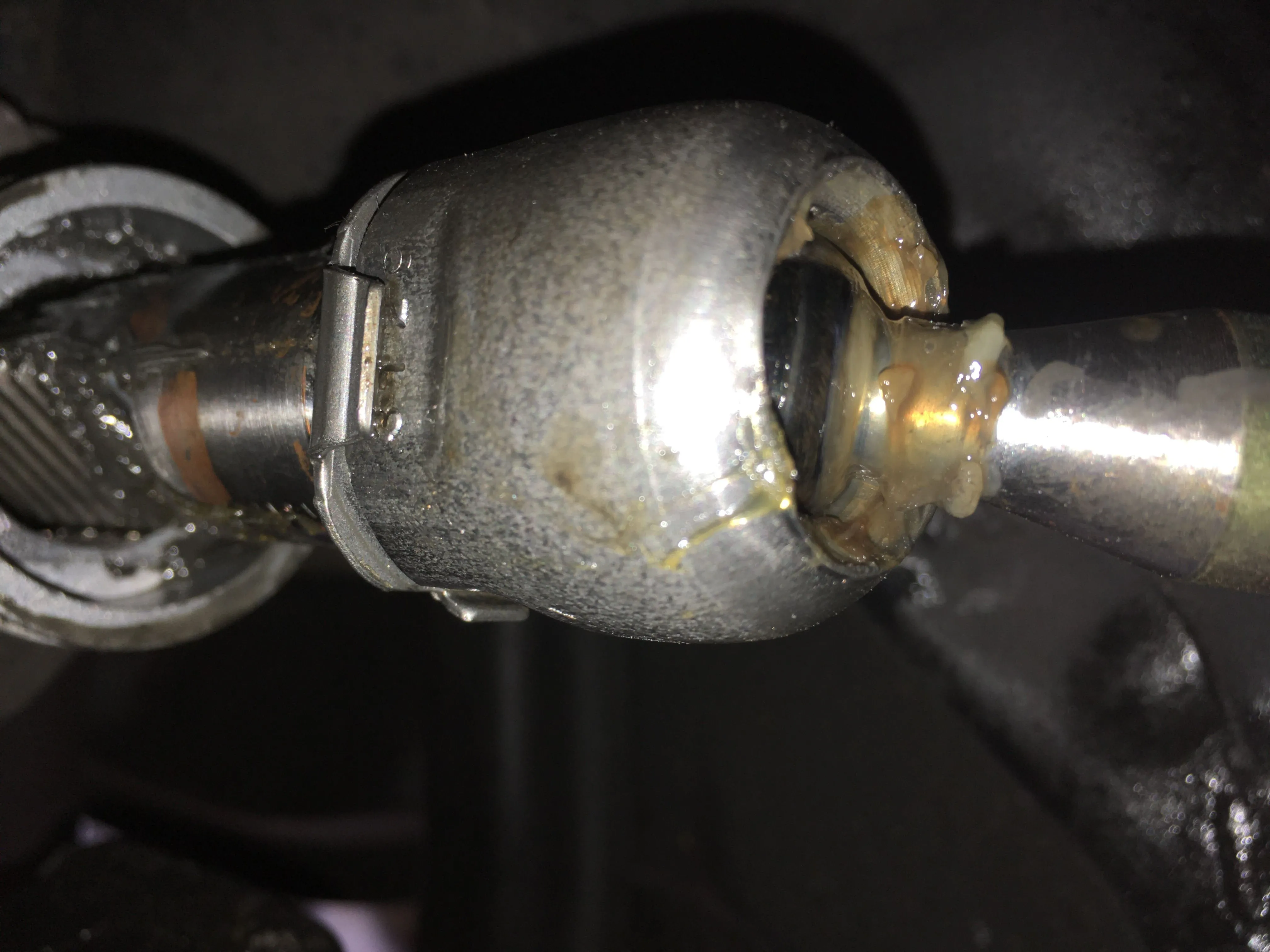

I cut the outer off and got the inner boot off. By the looks of it I have to pry up on those clips to get the inner out but I don’t want to bend them. I can’t see how I would get the removal tool on without getting the clips out of the way. You can see on the new one how the tool would hold onto the flat spots and turn it
I'm guessing the clips need to be unhooked and they're what locks it in place so it doesn't unthread on its own after it's installed.
Either way you probably have to remove the clip.
It looks like spring type material that's designed to bend and spring back into shape.
It probably won't unthread with the clip connected you probably wreck the clip if you tried unthreaded with the clip on
It's a bit like a cotter pin.

I dunno, ... New lock washers sound like a good idea.
I don't think that's a corner I would cut.
I haven't tried unthreading, my lock washer is untouched. Theres not really any good way to unthread without the tool.
Only one brand on Rockauto comes with the lock washer, for whatever reason Moog doesn't. I'll check the package again. I can't find the washer sold separately anywhere.
I really want to get this thing off jack stands before my neighbors really hate me but I guess I'm gonna have to order the lock washer...
