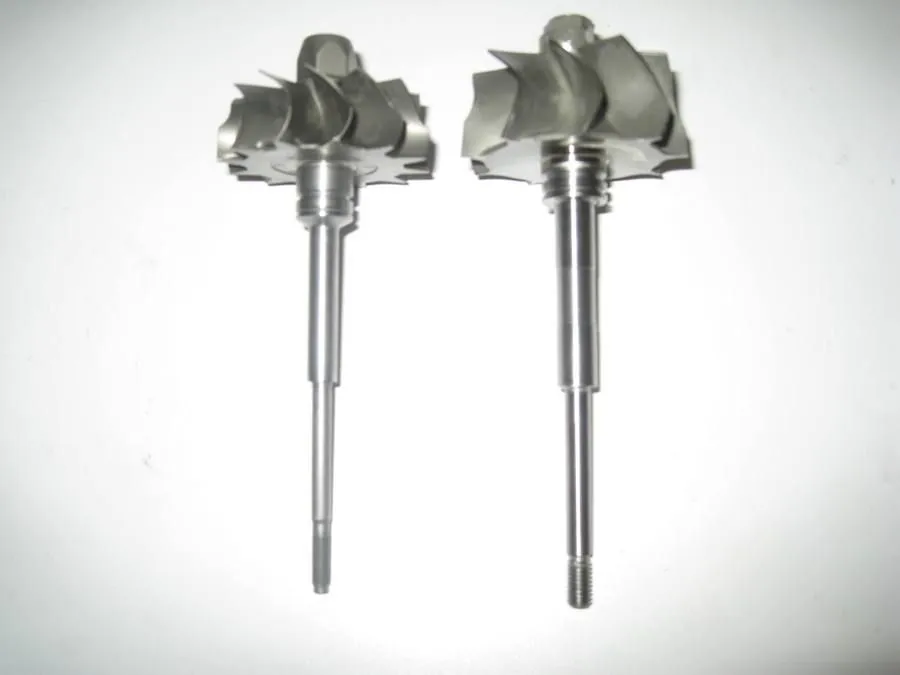

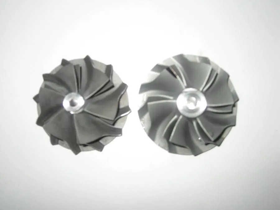

Please do....

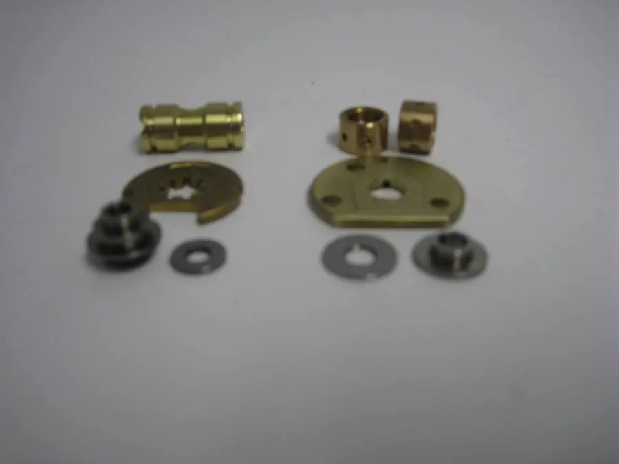

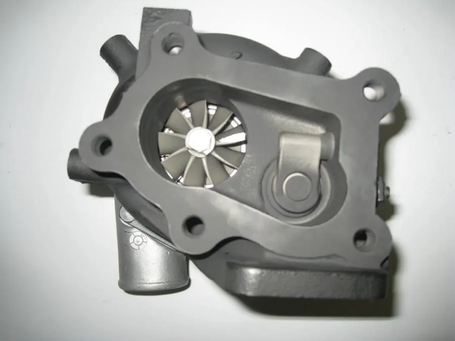

here are some pics!
The pics of the bearings on the left. You don't notice the oil feed hole in the K04 bearing but it is .040" and the contact area for the thrust collar to bearing is .0850".
The feed hole for the thrust in the GT28 is .0825" and the bearing/collar contact is .1250" all the way around. These holes are located in the center of the bearing at the 12 o clock position.
Measurements: K04 BNR GT28
Compressor Inducer 45.1mm 47.21mm
Compressor Exducer 56.0mm 60.00mm
Turbine Inducer 50.00mm 52.80mm
Turbine Exducer 44.47mm 46.82mm
Shaft journal dimension 6.96mm 9.15mm
Shaft end (most important!) 4.56mm 5.97mm

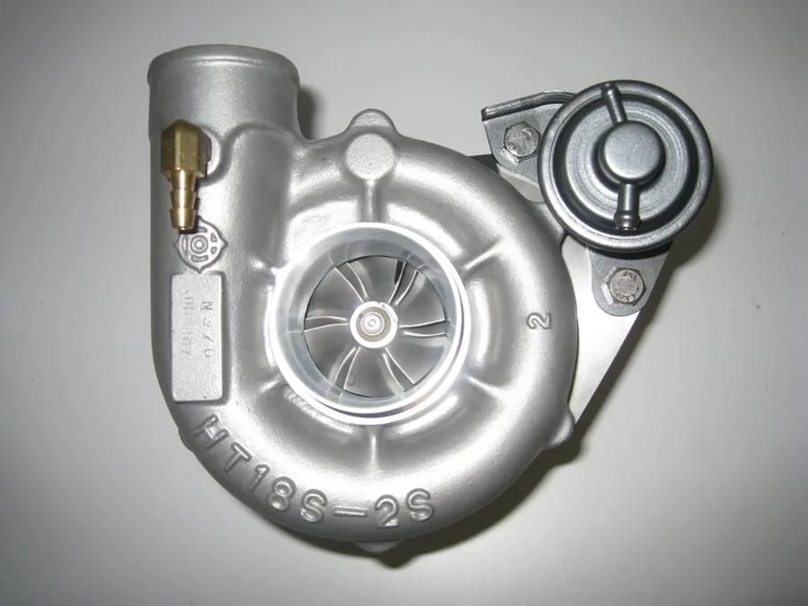

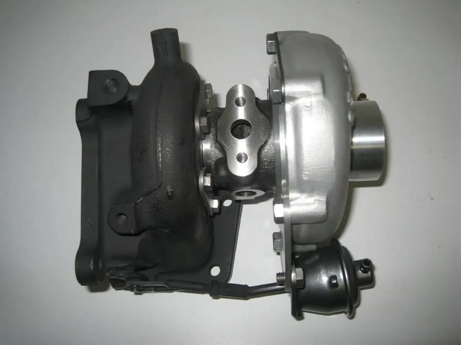

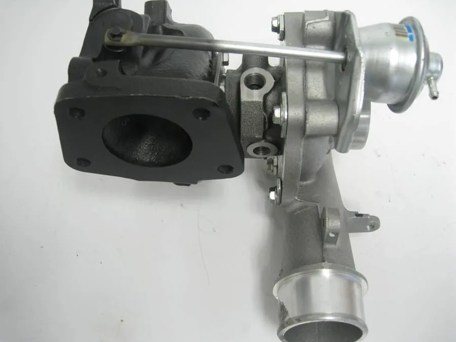

Pictures of the 100% bolt up stage 1 upgrade.

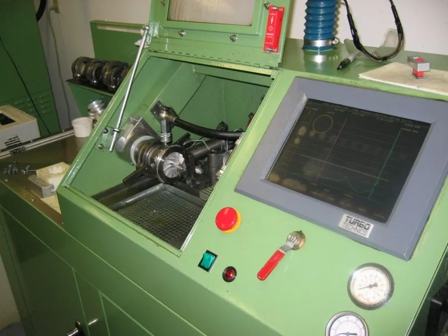

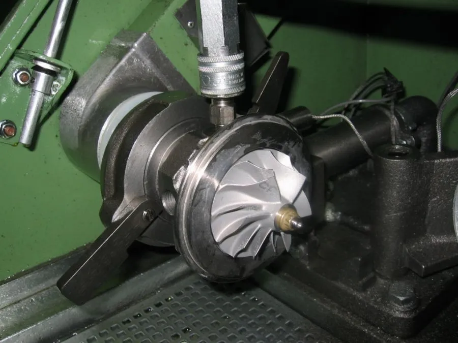

Pics of the BNR GT28 CHRA's on the VSR balancing machine. Balanced to 140K RPM!

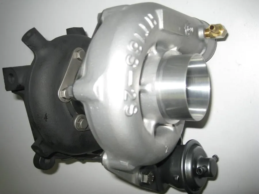

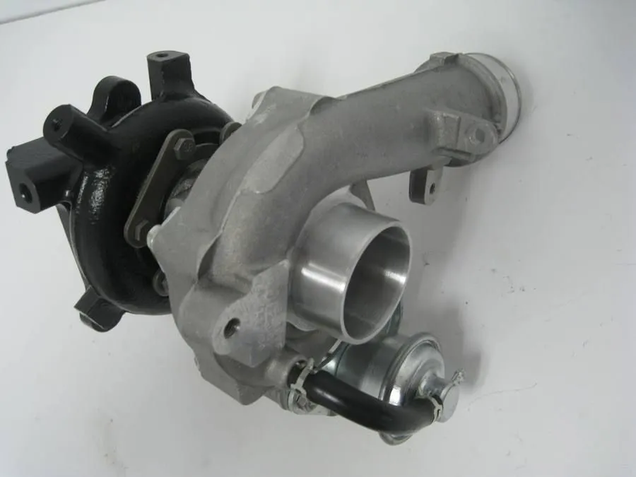

Here are a few pics of a turbo I did today. This is a Stage 2 with a stock diameter inlet.
I have in the works a weld on adapter to the compresssor outlet. This will make the stage 2 100% bolt up with no fabrication required. Stock intercooler pipe and couplers will be a direct fit.
This is my turbo (alright)
This is a good looking project still. I think that everything needed to mechanically bolt on to; a stock top mounted intercooler, air intake location, and the manifolds would be great. looks like a much improved, over stock unit for sure. Size does matter.
