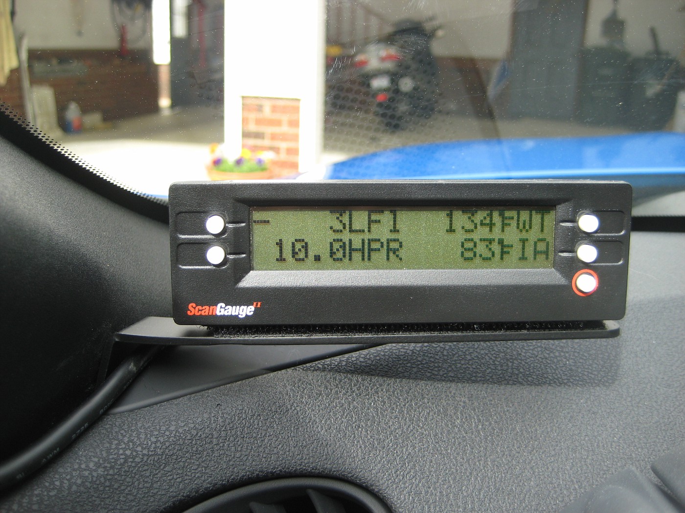

I want a temperature and oil pressure gage.
Keep in mind, that most temp and pressure gauges in MOST cars are gauges in looks only. For the most part they are On/Off switches with a gauge read-out. On my GTI, which is similar to most cars these days, the temp gauge reads 190 degrees when the actual temps can range from 160 to 220. It's bogus. If you want real readouts, buy yourself a Scangauge and plug it into the OBD port for real numbers.. You can keep 4 measurements up at any one time...
I have had experience with the scangaugeII, and I like it. I would like something like this, but find myself looking to see if there is something better out there... Imagine an OBDII port with a bluetooth unit that sent the data to my smartphone?
