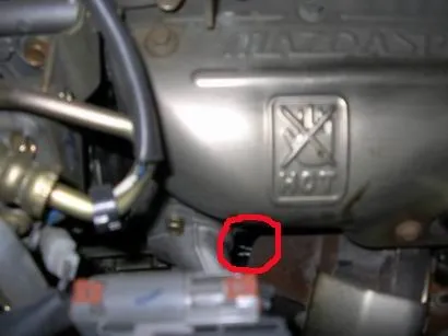

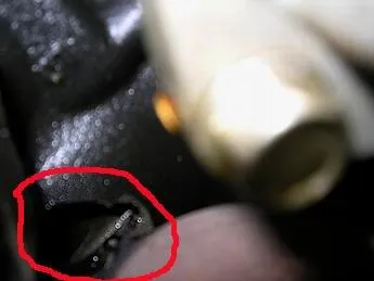

few pics of some damage. as far as i can tell for the night.. im throwing up rods. (puke)

At a minimum, it's going to be several hundred $$s for a new motor (that's for used) & then a LOT of work to pull yours & put the new one in. Then you can either turn down the boost & be smart about it or build up your motor if you plan on making more power.

Some may be able to run more boost if things work out with their setup, air temps, what gear they are in. But because you are playing with fire, sooner or later things go very wrong. You more then likely sent a rod out the side of your block. If the bent and the bottom of piston hit the counterweight you need to check a few things. If the pin boss on the piston is gone the piston may have ran up and hit the valves on that cylinder also.
