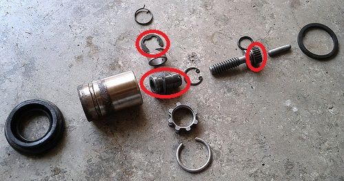

OK,... I'm just guessing here but it may be possible that your calipers are still OK. It looks like (judging by the picture of the rear internals) that the main screw can completely unthread from the C-clip that threads onto it. (It's the big C-clip at the top of the picture)
Perhaps, if you add a bit of pressure to the piston while turning the allen screw it may start threading itself back on.
If your pad was missing, it's possible that the self adjusters threaded themselves off completely.

EDIT,.. I might be wrong,... the FSM diagram seems kinda different than the picture,... I was assuming the big threaded screw in the middle of the picture had the allen head at the end.
However the FSM shows the manual adjustment gear (# 4) which is most likely the part with the allen head. That means the big threaded screw may very well still be inside your caliper. (your connecting link may have fallen out too ??)
I don't get how part # 11 connects with the internals ??? I would expect it to be splined to drive the self adjuster ?? It looks like it would just pull right out of the hole (no c-clip)
